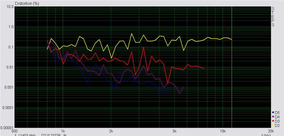

    Distortion and FR @ 95dBSPL, 3" from Raal 140-50 without its little foam pads.
    1st pict is w/o crossover in place.
    2nd is same conditions.
    3rd and 4th are with a 24dB/oct electrical @ 2KHz.

    Those are some rather decent results indeed, thanks for posting them
      Thank you!
