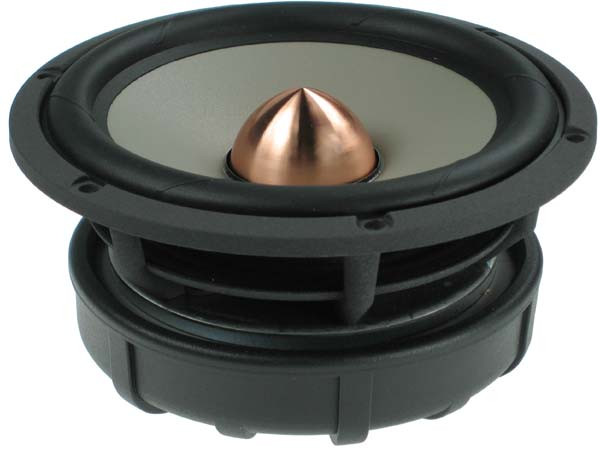

              If you want something smaller and you like the Seas Excel sound you can always ask Jed to design a MTM with either the SS 6600 or D2608/913000 and the Seas Excel W16NX. Should be a great sounding speaker! :P
              http://www.seas.no/index.php?option=com_content&task=view&id=67&Itemi d=91

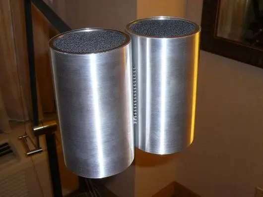

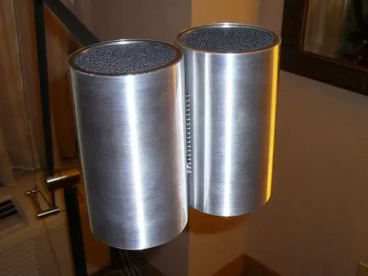

                                                              Oh, and is ET secretly working on a Raal Omni design?

                                                                • CraigJ
                                                                  • 519
                                                                  Nothing wrong with the Earth's gravitational field this weekend, that I know of. Just thinking about discectomies and M8tas, and hasn't it been seven years to the week since your surgery? Don't want you catching up to my wife.
                                                                  Glad to hear that the Chancellor gave ET a new toy. Wonder how the planer works with aluminum cylinders.
                                                                      Click image for larger version  Name:	raal1-thumb-530x398-25253.webp Views:	0 Size:	15.0 KB ID:	946664
