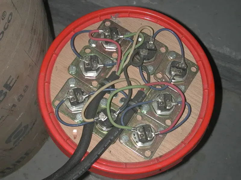

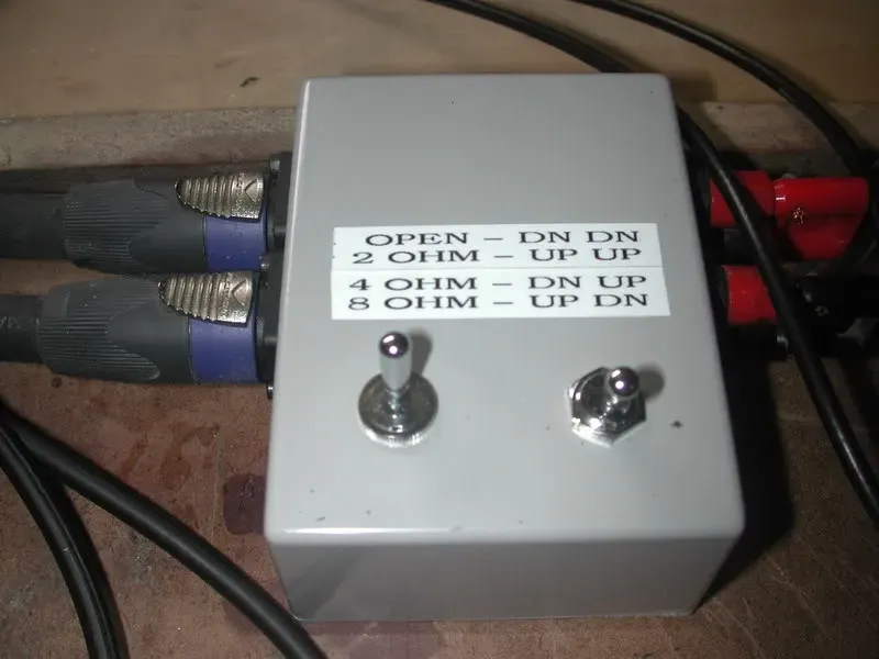

              I don't know how much power you're talking about but I like ChasW's dummy load for testing big amps. He uses water heater elements in a bucket of water to keep them cool so the R doesn't change.

                That is a pretty inventive rig. Fortunately I don't need anything more than 200W. I'm just waiting for the dummy loads at Parts Express to get in stock next week. They're nice and small and the same thing I used to use at Cirrus for our power amp testing. The TAS5261 is a max 200W@4ohm chip, and I doubt I'll ever build anything more powerful.
