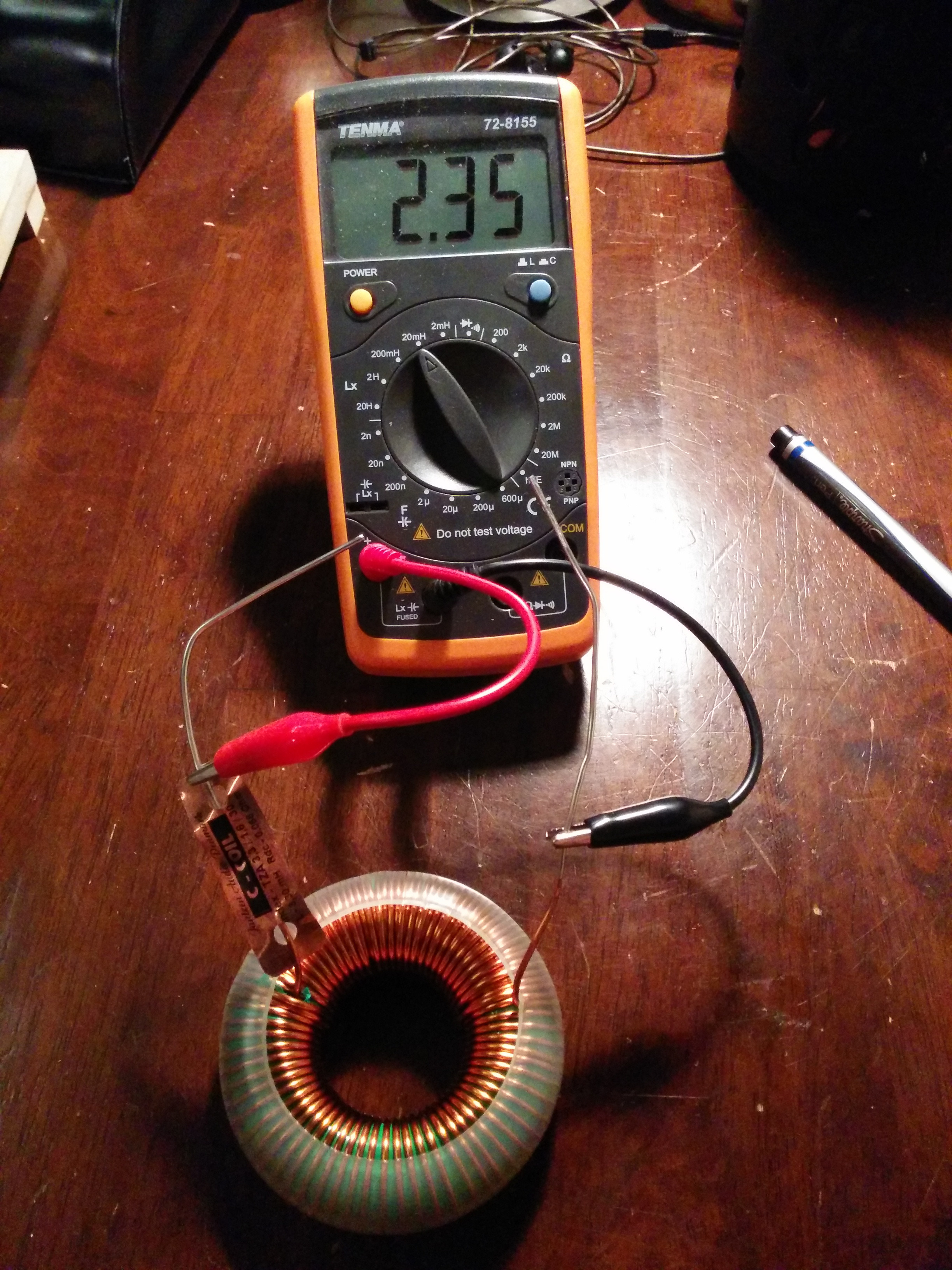

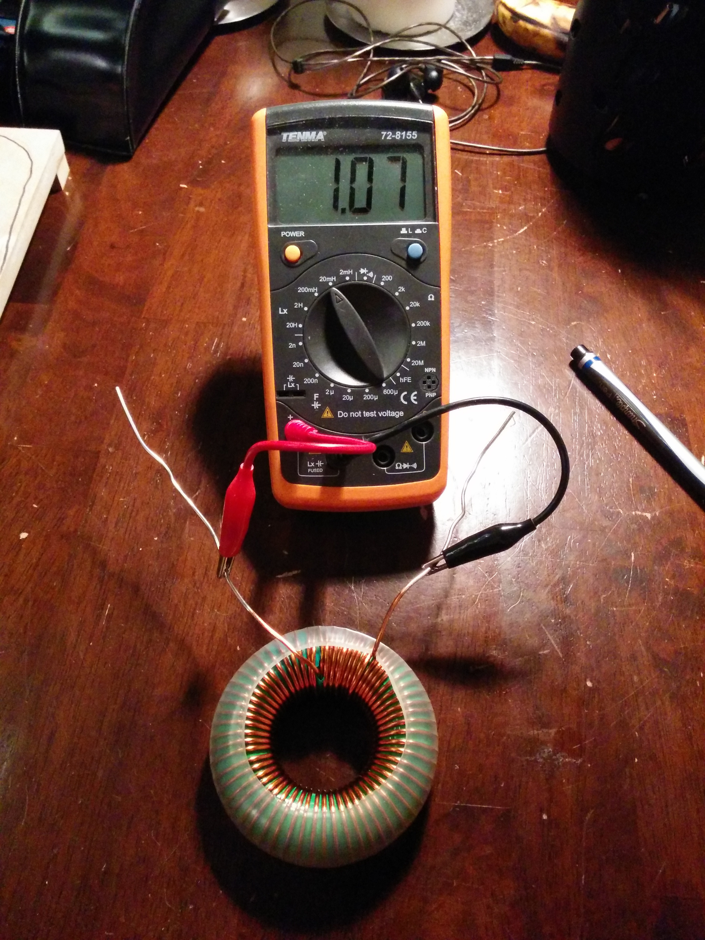

    I am using some C-Coil inductors from Jantzen for my Modula TMM build. Them, along with every other inductor and part get measured prior to using them in my crossover. Every other inductor i have measured in the past ends up being ever so slightly above the stated inductance, which is great because then i can just unwind a wrap or so and home in on the value i need, but in the end measure up precisely. However, when i measured these C-Coil inductors, they can in well (like ~70% of) below the stated inductance. For example, below show my measurements on the 1.5 mH and 3.3 mH c-coil inductors:
    This seems too large to be typical tolerances; 1.5 mH with a 10% tolerance would yield no less than 1.35 mH. Shows is 29% of nominal value too low!! Whats is odd is that 1.07 is 71.3% of the nominal value, and 2.35 is 71.2% of nominal, it's almost like its something I'm not accounting for. There isn't some weird principle of steel core, or toroidal steel core inductors that I am not aware of is there?
    I originally got a 3.3 mH to unwind down to the required 3.0 mH, but with this, i don't even know what to do. I have just installed them as is into my XO, but I am debating returning them and getting a different 14 AWG steel core, one that mey measure more accurately. I know Jon Marsh has used these in his designs, and many others have built the Modulas, so anyone else measure their c-cores and get something really off?
    Thanks!

            Brilliant! That's what I was hoping/ expecting. My next question would then be: if I cannot measure then very accurately, how do I determine if I have unwound the 3.3 mH to 3.0mH? Would using the 3.3 add is be that bad a move for the use in the modula mkii tmm? I suppose it would lower the rolloff frequency of the bass driver in the 2.5 and create a dip there. Hmmm

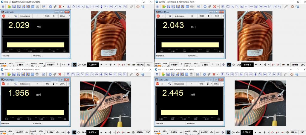

                                    Anyhow, as the answer did interest me I tried some experiments.
                                    I compared two coils
                                    2mH Jantzen Air Core
                                    2.5mH Jantzen C-Coil
                                    Measured with
                                    CLIO12 - in built impedance method
                                    CLIO12 + CLIO QCbox V iSense method
                                    First - the CLIO12 in built method with 1V and 3V (that is a max with CLIO12)
                                    You see that while air core inductor result is not sensitive to drive level - the C-Coil one is

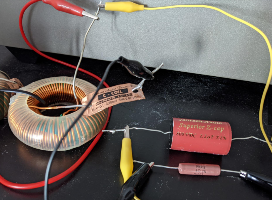

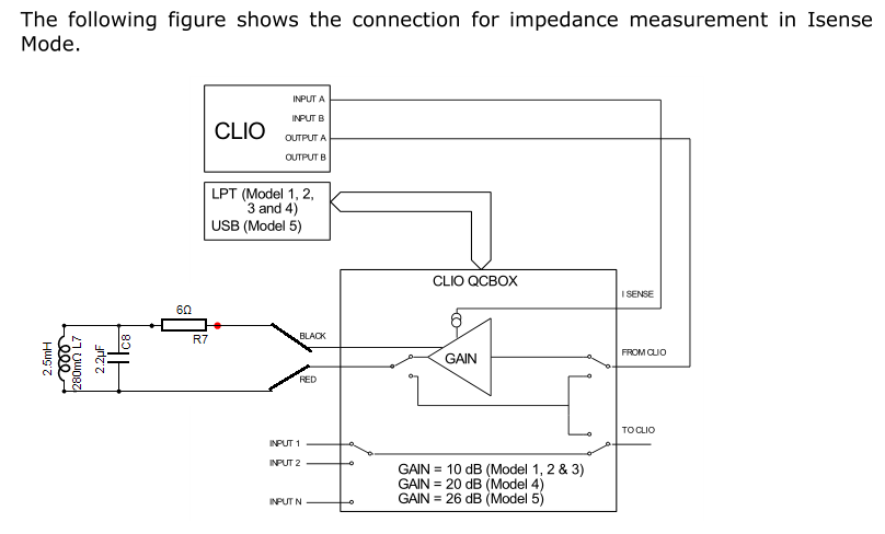

                                    Next the suggested method via CLIO QCbox V amplifier
Name:	LCR method.png

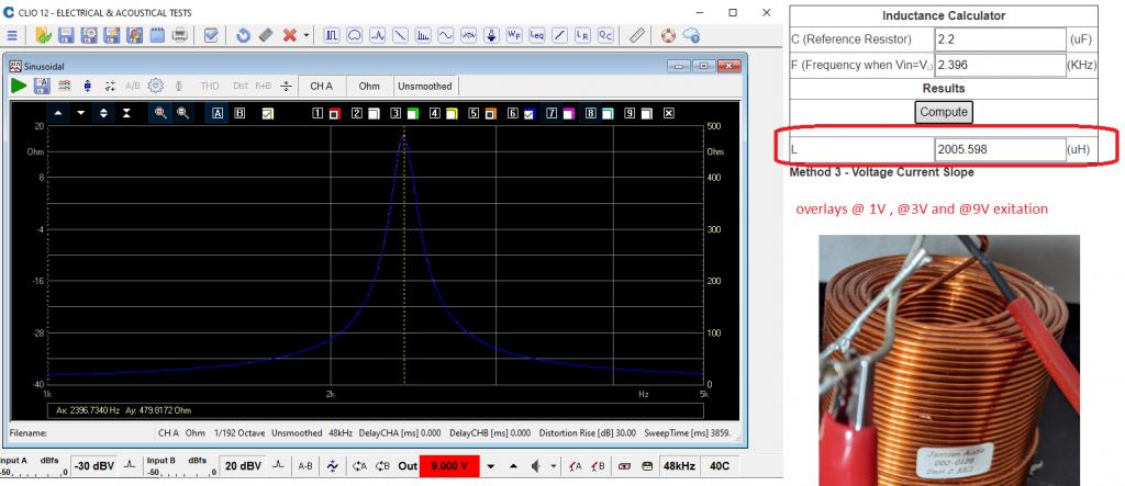

                                    The result for Air Core at 1V, 3V and 9V - again, no influence of drive level
Name:	Jantzen Air Coil.jpg

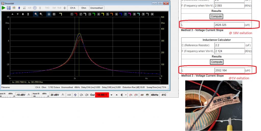

                                    The result with C-Coil with 1V, 3V, 9V, 18V - you see that the resonant frequency keeps lowering
Name:	Jantzen C-Coil QCBOX.jpg
                                    What is to be learned from this - for me the learning are
                                    - Coils with toroidal core need higher voltage/current to measure close to the 'right' value
                                    - There is no definite 'right value' when it comes to coils with ferrite cores - it will always depend on measurement levels/currents
                                    - One can trust Jantzen number on the coil
                                    - I would buy a new coil with right value instead of trying to wind down the ferrite cored coil. For air core it is safe as measurement is easy and accurate and I've done that a lot.
                                    PS. Sorry about image quality - forum degrades it a bit too much but it is safer for future to keep images here and not link to them

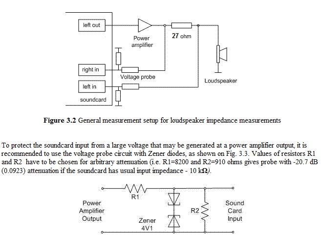

                                                • 698
                                                Without additional investment I do not see a way to solve the puzzle with the Tenma tester you have or CLIO Pocket. CLIO Pocket is the low cost version and as it has only one input, it will unfortunately limit what you can do in this specific case.
                                                The ARTA-LIMP user manual shows the Impedance measurement config with Power amp in path. A setup like that would be needed to do this C-Coil measurement right. But you would need a 2-channel input for it. So Pocket is not suitable
                                                So I would suggest just ordering an exact 3mH coil that you need and trust the manufacturer spec on it.
