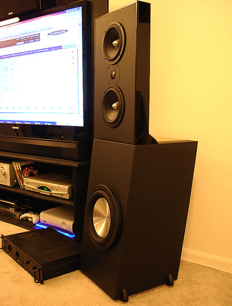

    hey all! I have searched and searched and i have not found much if any talk of open baffle center channel designs. I wonder if there is a drawback to using an open baffle speaker as a center channel?
    I have a dilemma. I have recently made the upgrade to a projector with 100" screen. Before I used a sealed enclosed center channel on top of the tv with the open baffle mains. The sound blended nicely but now with the wider speaker placement, the center channel is not blending at all. No matter how I adjust it. It feels like as the sound pans from left to right the sound goes from open to closed box sound back to open sound. I just cant figure it out it just doesn't sound natural. I am thinking I should do another open baffle for the center channel now.
    I am just wondering if anybody else has done this and if anyone has any tips, tricks, or advice. I am trying to come up with a new design to go with my mains.
    The other problem is my mains have the old Ascendant audio 6.5" polys that were discontinued with seas 1212's, and tc 1000's as shown below. I have an extra tc 1000 10" that I can use for the centers low end. I am also wondering if i could get my hands on some Ascendant audio 6.5 polys. Or I am wondering what a good substitute would be. Hmmm should I start all over with new mids!? Arrghhh! Any advice is appreciated.

          Thanks for the input guys, I still am looking for a couple of the ascendant audio 6.5 polys or a whole new set of matching mids (not sure what yet). I will be checking around that forum though thanks Xander.
          I tried running in phantom center mode but I think the sweet spot is a little too narrow to get an accurate image of the dialogue in places.
          Paul thanks for the compliment. I like your web site, great speaker designs too! I hear what your saying. I'm thinking the same way. Its not a good idea to mix these speaker design types because it almost produces 2 different dimensions to the sound. I found the problem really gets worse when the speakers are placed further apart also.
          Tonight I made a mock up open baffle center channel using an enclosed tc sounds 10", 2 morel 5" with a dayton 3/4" tweet on the baffle just under the screen. After some tweaking and careful positioning I think I got the type of sound I've been missing. The center image is so open and airy now. The front soundstage now feels like a tall wall of sound and blends better overall. I think it could be a lot better though. It doesn't compare to the WWMTWW center I had before. Only in the way the RS52 dome mid had better dialogue and imaging. Every design has its trade-off's I guess.
          I have to say I am partial to the dipole sound vs. the enclosed type sound. I have to agree about open baffles, with some movies and the way the sound is mixed sometimes creates a confusing/off soundstage. Then again some movies that are mixed very well are pure magic, and just "come alive" surprising the the crap out of you at times lol! especially while watching in a darkened room. That's the stuff I live for!

                      Well the problem with the Phantom center mode was the dialogue still seemed to be blurred even with the decent toe in angle. I think it' because the speakers are now positioned so far apart on the outside edges of the screen.
                      I did try playing with the phase of the original center channel. I have a couple of dcx2496's controlling all 5.1 channels. It did initially sound kind of like an out of phase issue, but I just can't resolve it. I think I am finally going to conclude that the sound of the closed box design is just too limited as compared to the openness and air of the OB mains.
                      Curt! I have drooled over the thought of using the new tangband's they look great for OB! I am thinking about using 2 of the 5" W5-1685 Tangband's and a single tweeter for an OB center. Thier xmax is 6.1mm though and I am wondering if a pair of these would cover the duty down to 100hz on a large baffle? Maybe the same as the layout in the attached image?
