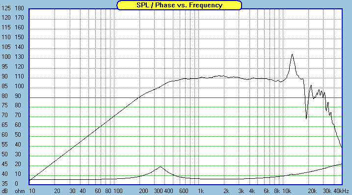

    After having the Seas 4-way for more than a year, I have concluded that a 3-way system simply is not adequate to cover the full bandwidth. I had for some time believed the addition of a small driver between the 8" and the tweeter would offer some improvement and this system has been my opportunity to explore this. I now believe that the improvement has been greater than my original expectations. I further believe that this concept should be taken farther. I am currently working on a six-way system that will include a 5-way panel plus separate dipole subwoofers.
    I currently have six Dayton RS390s (4 for IB) and plan on using a single one per side, in a shallow H-frame, up to 100-150 hz. From there I'm planning on using dual Dayton RS225 4 ohm, which would be in a SWMTW format. I really want to have exceptional midrange and was thinking of going with a pair of Tang Band W4-1337s but then I got to thinking. The RS52 midrange has a flatter frequency response and much lower distortion in the range I'd be using it in:

    Tang Band W4-1337 Frequency Response

    Dayton RS52 Frequency Response

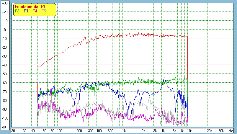

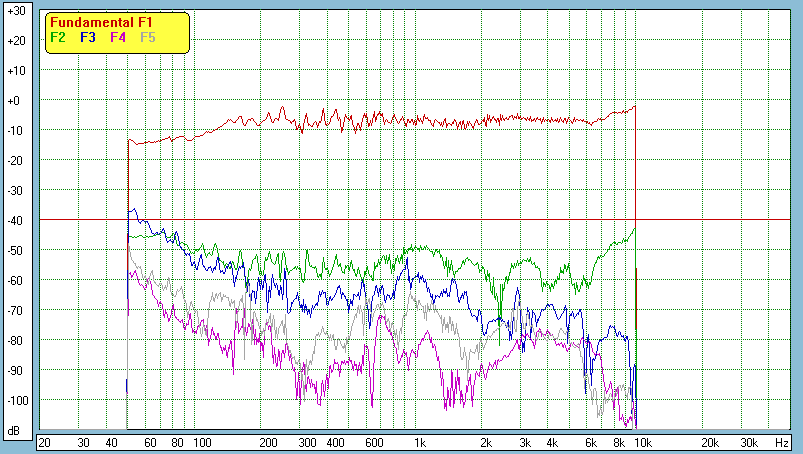

    Tang Band W4-1337 Distortion

    Dayton RS52 Distortion

      I like the W4-1337s better than the RS52. The pair of my RS52 had a 3rd order distortion spike that was very audible. You can see these tests on my webpage along with before and after measurements of the W4 after TB changed the basket. It was improved, but could be within spec variation of manufacturing etc.

          I like the RS52, but would probably go with the TB in this application. You have the potential to generate low distortion/high SPL and the TB should have more clean displacement and may be a better mate to the RS225. I'd also invest in a very robust tweeter, probably SEAS with higher xmax.

              Jed, concerning the 3rd order harmonic distortion around 4.5 khz, where were you crossing them over? If I were to cross them around 2.5 khz I should be nearly 24db down at that point (if I use 4th order electricals on my DCX) and should be able to pretty much eliminate that distortion peak. At least, that's what my amateur mind thinks. Also, the Tang Band has a similar distortion peak right at 900 hz, with much higher accompanying distortion than the RS52. Again, I haven't listened to either but am taking all this from Zaph's measurements.
                Here's my RS52 I tested. 3rd order spike at 2K AND 4K- but not bad at all.
                My W4-1337 tests look better than that to me though. Lower D4 and D5.

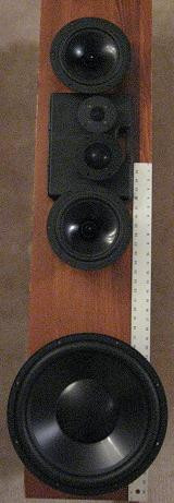

                  As of right now I'm thinking of going with a deeper H-frame to get more extension out of the RS390 and crossing to the dual RS225s as high as I can before I encounter the cavity resonance. I'm banking on 100 hz. but am confident the two RS225s can handle 80 hz. on a flat baffle.
                  I got a little excited and laid the drivers out on my bench to see how big this is going to be. I had to put a case under the RS52 and RS28 to lift them up a bit so they weren't overshadowed by the big boys.

                  I've never heard a design with an RS28 I didn't like so I'm thinking of using it in this design. I'd like to use the RS52 as high as possible so I get more dipole output in the rear (using a rear mounted RS52) but I'd like to suppress that 4.5 khz 3rd harmonic so maybe a 2-2.5 khz. crossover would be best. It's a shame, but that would only be using the RS52 for less than 2 octaves. I guess the only thing I can do is build it and test it out.
                  Thoughts?

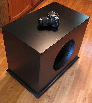

                    I had to share this steal I got at the tent sale and didn't feel like making a new thread for it. Plus, this may serve as the fifth speaker if I decide my dipoles need to cross to a sub.
                    If you look at the back of your PE catalog you'll see the dual RS315 sub with opposing drivers. Well, I got to the tent sale 10 minutes before it was supposed to begin and wouldn't you know it, people had already started shopping almost 30 minutes before I got there! The absolute first thing I saw when I walked up was this sub enclosure with a price of $20 on it and I was shocked that no one else had snagged it. It was literally the first thing you saw to the left side if you were walking from the parking lot. I immediately saw a PE worker and asked if they could put my name on it because I was going to go pay for it. Also, all things at the tent sale are 20% off so I got this beauty for $16. It has a satin finish to it, not like the high gloss in the photo, but nonetheless it looks great. I measured the internal volume and it's 2.006 ft3, with a brace with holes, so we'll call it 2 ft3 to keep things simple. The whole enclosure is doubled 1" MDF, and my my is it heavy. I frequent the gym and I would say it weighs about as much as the 100 lb. plates do near the leg press.
                    I threw my new DSLR camera on top (Sony A100) that I just snagged from Sears this morning for $200 for a size comparison. They just dropped the price on them drastically as the new A200 is out so it might be worth your time to see if you can find one locally.
