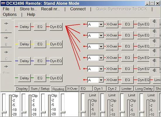

    I'm having difficulty getting the program display screen to fully open so I can run the software.
    Dennis H posted this view
    The only window I'm able to get is shown below. The window has no controls to resize it. Right clicking in the window does nothing. There are no controls on the sides or lower corner of the pane to drag the window bigger. This is the current version of the software downloaded from the Behringer website this AM
    The PC is running XP Pro with a 22" Samsung SyncMaster 225bw display, resolution is set to 1680X1050
    Any assistance would be appreciated.

    Interesting. Maybe the font size in your display properties? (The font on the top row looks incorrect to me.)
    I just changed my font size to "extra large" and it looks just like yours. That must be it.
    That's my best guess. Hope that helps.
    Dave.

      Do you use the "classic" desktop? Maybe that style is incompatible with that DCX program. I found that would happen with some programs until I just switched to the normal XP desktop.
      ~Brandon 8O
      DriverVault
      Soma Sonus
        Yep it's the Classic desktop but going to the newer one doesn't change anything.
        Davey got me where I needed to go. I'm using normal fonts in the display properities but have the advanced display DPI settings to 'large'. Putting that to normal solves the problem, but now I need my bi-focals to see the read text. Getting old sucks ..... :roll:
        Thanks guys.... :T
