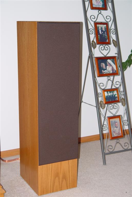

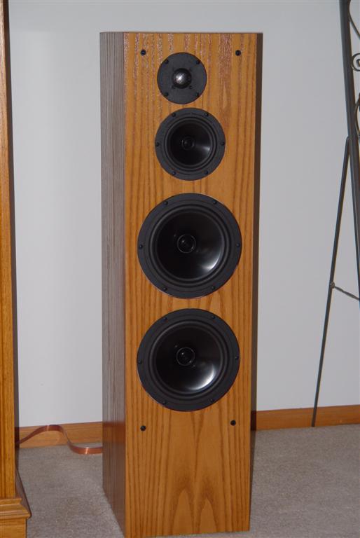

                Hi Al,
                The RS 3-way is a 3-way tower design based on the Dayton Reference Series drivers. They are extremely low distortion drivers that are valu priced but compete with very expensive drivers. I've attached a picture of the pair I built.
Name:	RS 3-way completed 003 (Large).jpg
Name:	RS 3-way near complete 002 (Large).jpg
