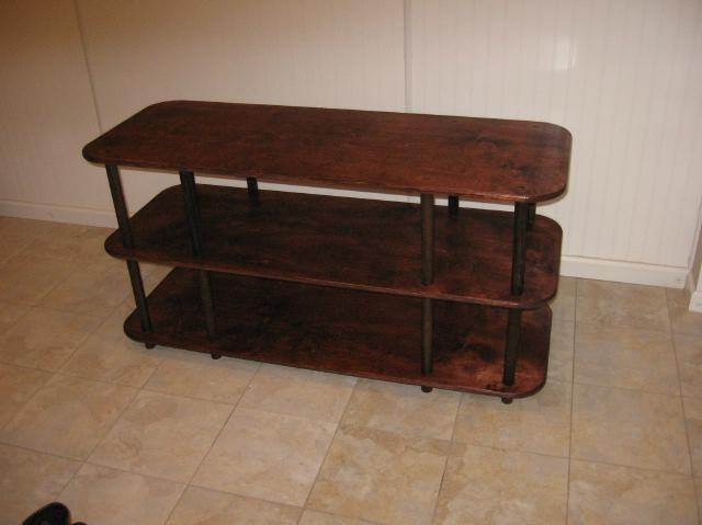

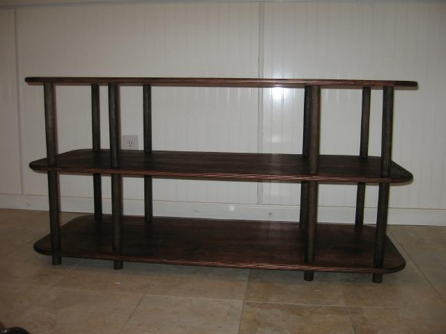

                            Thought I would post pictures of the completed project. It is all done, except for rubbing a few coats of oil on it. It looks better in person and with a speaker and TV on it.

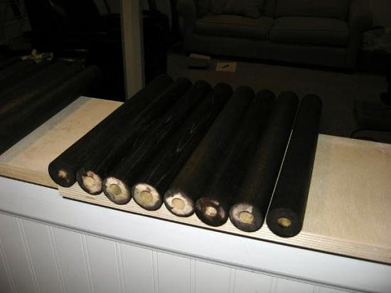

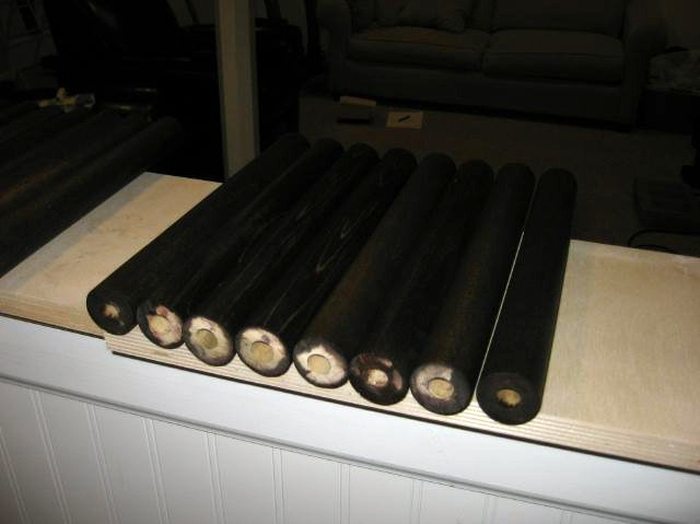

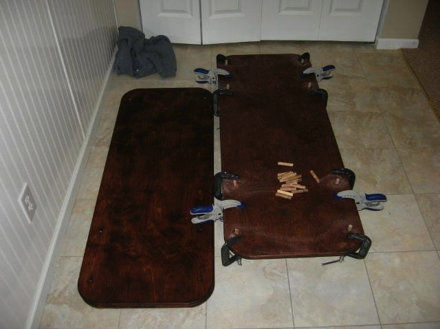

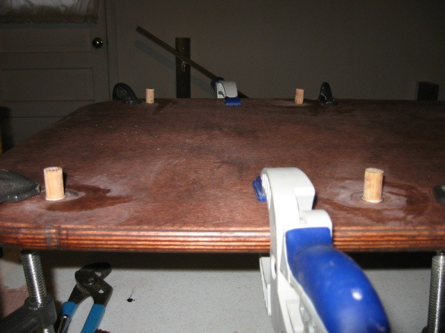

                            To make it, I cut the ply down to three pieces 19 3/4" x 54". Then I took used the round cutouts left over from my port, and screwed it to the four corners. Then I trimmed it with a jigsaw and a router trim bit. Then used that piece as my template for the next two pieces of ply. After that, clamped all three pieces of ply together, and drilled through them all at one time for the joint holes. Then I made a sled to cut the 1 1/4" dia. dowels to the same length every time. Got someone to drill my holes in the ends of the dowels. Stained everything. The ply is red oak, and the dowels are a mix of red oak and mahogany. (Red oak on the dowels made the piece too monochromatic and as my wife said, looks like walmart furniture). Then it was a real quick assembly, using 1/2" dia dowels to connect everything.
                            To finish the earlier story, it turned out that my buddy at work's drill press was only a small bench top unit, so he couldn't fit the dowels in. I ended up calling the local wood store here, Owl Hardwood (awesome store btw) and they hooked me up with a local pro. I talked to the guy on the phone a bit, he said it wouldn't be a problem, and figured he would charge me $1/hole (so $24 total!). He even picked them up at my house.
                            Total price for everything was ~$100.
                            $62 - 3/4" BB Ply 5x5 sheet - cut into three equal 19 3/4"wide x 54"long. I could have used cheaper ply, but like the look of the 13-layers over the 7-layers, if it is going to be exposed.
                            $40 - (4) 1 1/4" dia hardwood dowels, (3) 1/2" Hardwood dowels, some red oak stain, some ebony stain, some wood conditioner, and rags and brushes.
                            We're not counting the $40 I gave him to get the holes drilled.
                            It turned out pretty good. It seems to be very solid. Some of the dowels look very slightly crooked. It could either be the hole in the ply not being straight, the end of the dowel not being perfectly perpendicular, or the hole in the dowel. Who knows. I'm impressed with myself, especially with how quick and easy this project was. My wife is also impressed.
                            Now to get all the gear disassembled and moved to the corner and then reassembled. Ughhhh a chore I'm not looking forward to.

                              Hey that looks very nice :T Should match the subwoofer too. I guess my only question would be is if there is any side to side rocking, as the connection points are all vertical.
                                No, it is amazingly solid. Because the 1/2" dia solid oak dowel is continuous through, I think it makes it very strong. To rock side-to-side, you would have to bend that 1/2" rod over a very short length - not easy. I feel very safe putting my new 50" DLP on it.

                                  That looks great- nice job! :T I like the way you have small dowels inside the large dowels. And it all looks continuous and such. Like Steve said, it will match your sub well. Now all you have to do is make 7 speakers to match.
