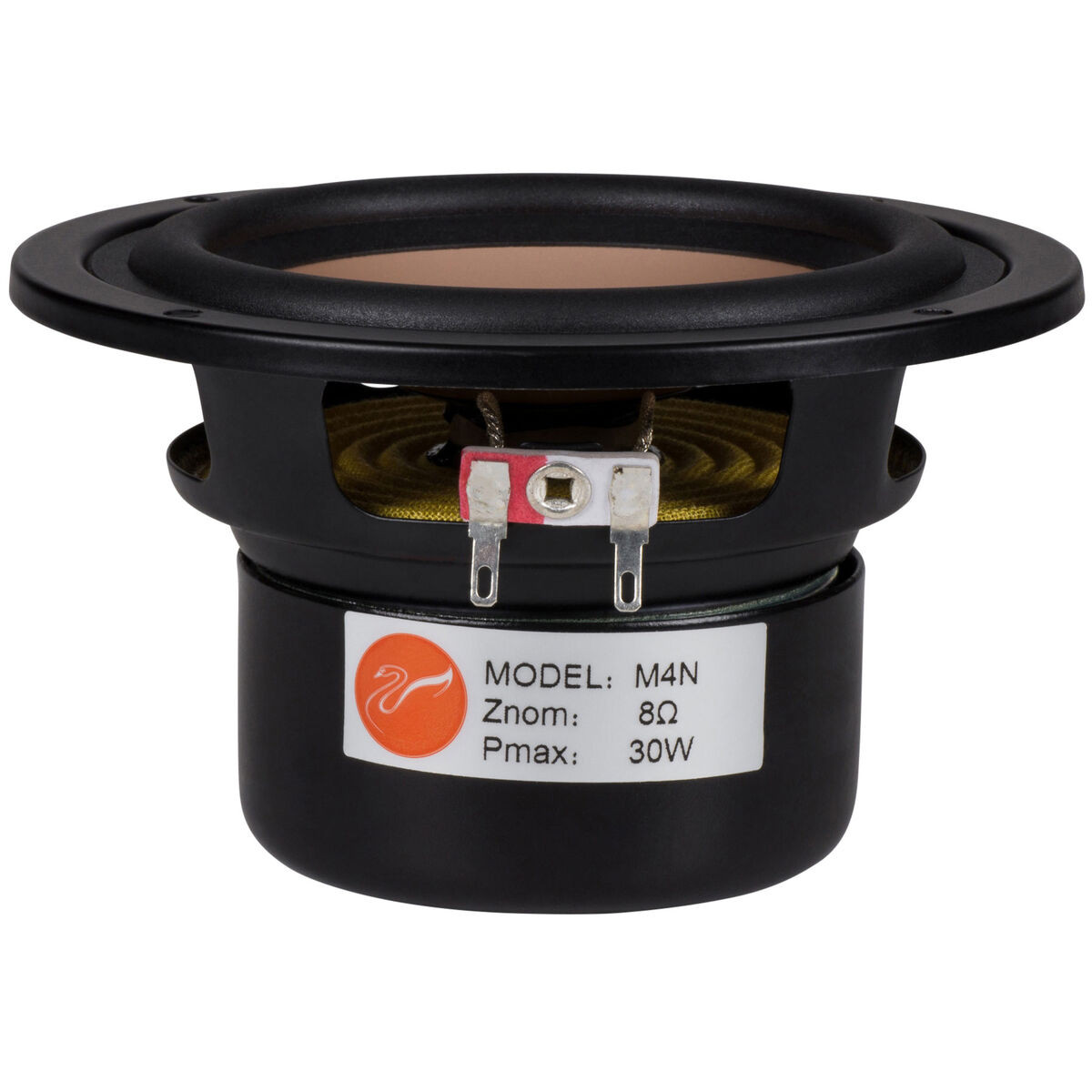

                One option using other drivers to consider would be based on the HiVi M4n drivers. They are pretty cute I think...hmmmm

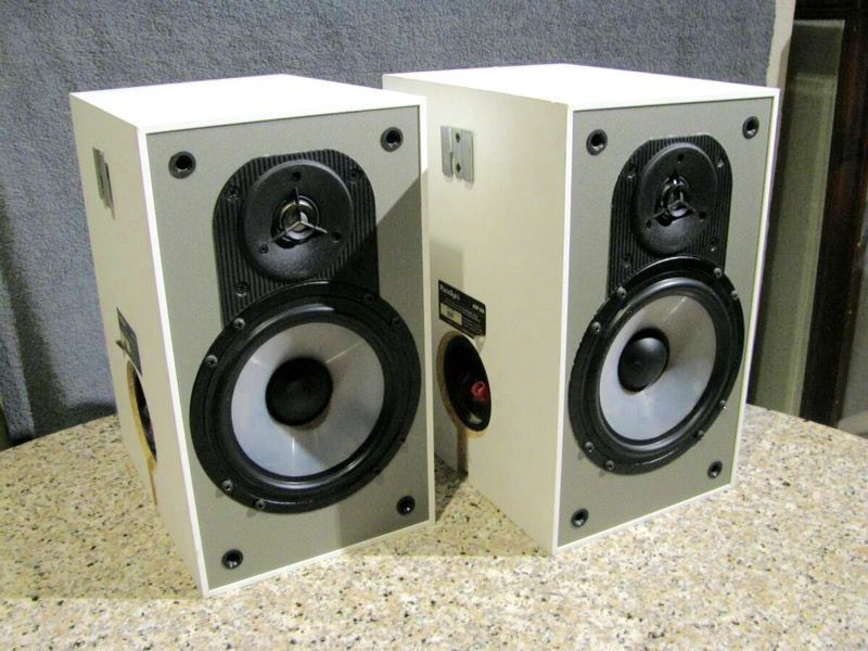

                                            Paradigm Reference ADP (slightly less than 180 degrees)

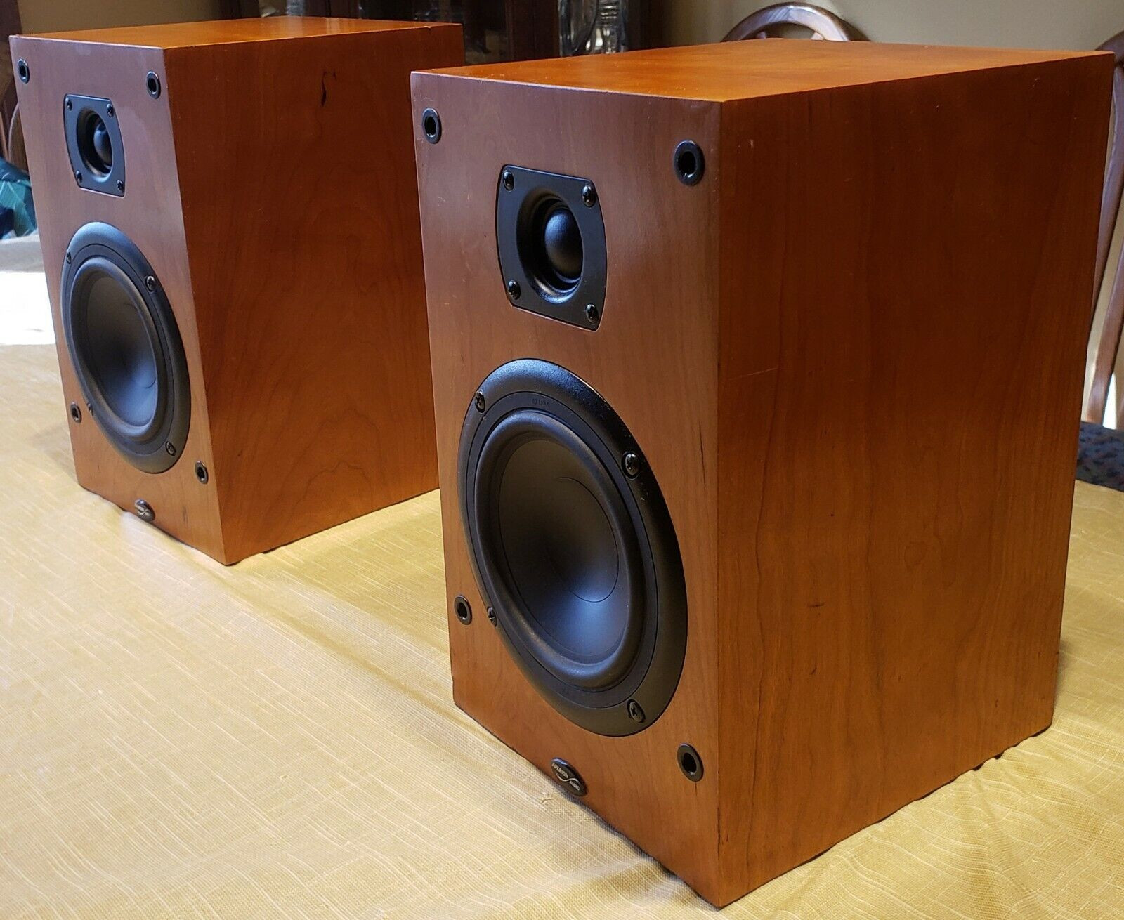

                                            Aperion (appears to be 90 degrees)

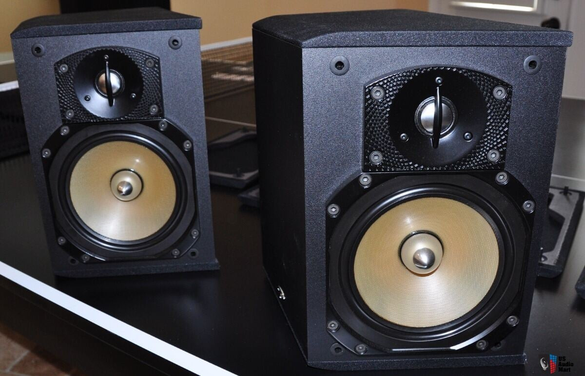

                                            Paradigm ADP350 (180 degrees)
