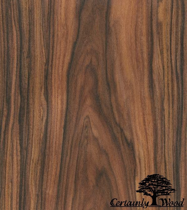

    This is typical of the grain in what I bought...

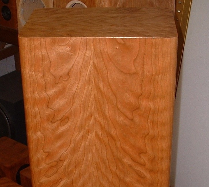

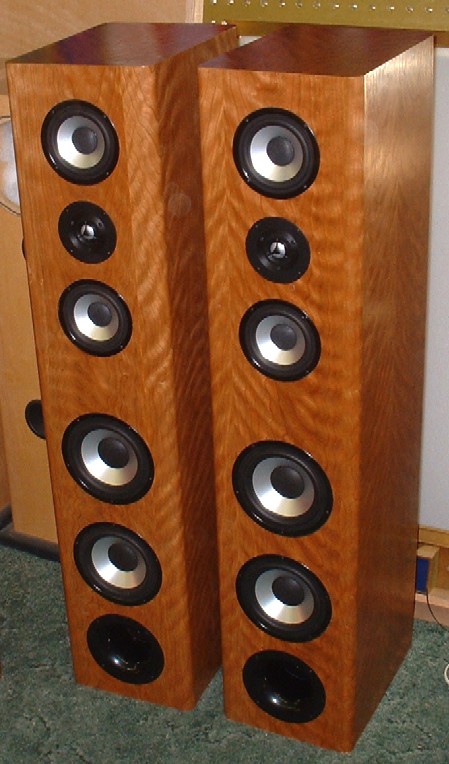

      I'd like to do something a la Meadowlark Audio with a solid wood outer baffle and top. With the size cabinet I'm talking about it would be extremely expensive to get a big enough sheet of veneer to do my standard "wrap" which consists of rounding the vertical front and back edges with one single seam centered on the back. So I thought of just veneering the back and sides with square corners and then gluing on the solid wood on the front and top and then rounding their edges. There's a local guy down the block from my dad's shop that can glue up the boards for me and has a huge sander that'll effectively plane the boards down smooth in just a few minutes.
      Also, I'm a huge fan of cherry so I'm aware of it's photo sensitive issues. As a matter of fact, that's one of the things I like so much about it. Speaking of cherry, here are some figured cherry speakers that I just finished assembling for a local guy:

        They look very, very nice Brian! How does the solid Cherry you found at Rockler compare with the veneer you've been using?
        • Brian Bunge
          • Nov 2001
          • 1389
          The solid cherry isn't nearly as figured as that veneer. I've done a lot of stuff with standard cherry veneer and it looks very much like the grain pattern of the solid cherry I saw at Rockler. If I use the solid cherry I'll probably still use figured cherry veneer for the sides and back. The grain pattern is just too awesome to pass up.
            :T Good work as usual, Brian! You are the cherry cabinet man for sure.
            Jon, in my limited experience, I've found veneer to be more highly figured than solid wood. If you think about it, veneer is sliced from the primo logs, and the slicing exposes many, many layers, which increases the chance that lots of it will be highly figured, as opposed to the chance that a few boards cut from a log will expose the most/best figure. Statistics haunts us everywhere.

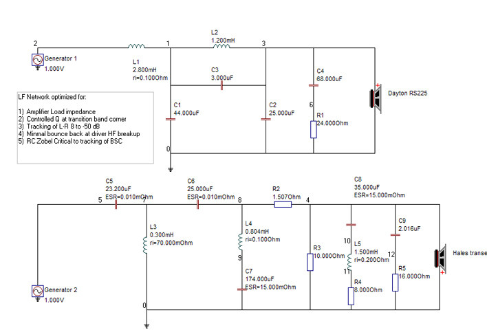

                        The crossover topology is very similar to the M8 designs- the topology and component count are essentilaly identical. Here's an example:
                        which is the current working version for the M8ta tower. Component values are different in the MTM of course, because of different crossover frequencies, and different driver impedances. Those networks are nearly done, and by sometime around the end of next week, while I'm in Denver, I can post the "release candidate" design and a BOM.
                        Like the M8 two way design, it will use metalized film caps and air core coils- and with the component count, it's similar in cost to a Linkwitz-Riley 4th order. The exact crossover cost depends on components- you can cut corners a bit by using less expensive caps and coils, but I'd think carefully before doing that.
                        ThomasW has not been a believer in "botique" caps or crossover components, but when we modified his Arvo Parts this last November with AudioCap Theta 10 uF caps in both of the tweeter caps (paralleled with the necessary GE or Solen caps to get the balance of the value) he became a believer. My Arvo's have been that way since day one. At $40 a piece per 10uF cap, it's not something everyone will go with, but I'd do that before I'd buy high buck interconnects or speaker wires. Thomas was pretty amazed at how much denser and heavier these caps are. Available through PE. Obviously, that would raise the cost quite a bit. Mine will be that way, as are my M8ta crossovers being built.
                        Maybe what I'll try to do is offer suggestions for "best choice", recommended, and "at least this", regarding components. Often is just comes down to the choice of type of cap - say, Dayton film cap, Solen Film cap, or?
