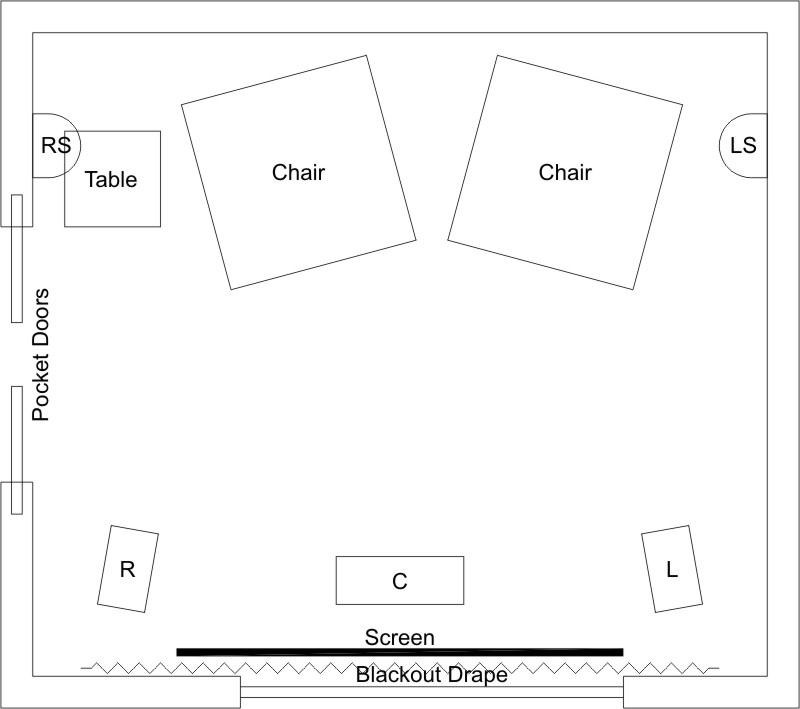

                  I say have a motorized screen that drops down in front of the window with black out drape behind to block any stray light and a small FP. This should spare you some room and also help solve the problem of light from the window.
                  I've attached a graphic.

                    Wow, thanks for taking the time to diagram your ideas! I like the thought of using the screen as an additional light barrier although that does shorten the viewing distance a few more inches.

                      No problem, I draw much more complicated stuff than that all day so it only took a couple minutes :lol: As for the couple inches you might lose, I still think this will offer the best flow and give the most room for you, otherwise you're having to move chairs etc too far in to the room just to leave doors etc accessible. You should even be able to make/buy a nice low, wide cabinet for your components which could also double as the stand for your centre speaker. Just make sure it's VERY solid to minimize any vibrations etc too and from the speaker. You may even want to make it modular with the centre de-coupled from the rest of the cabinets.
