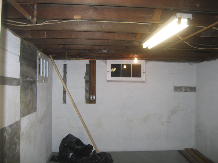

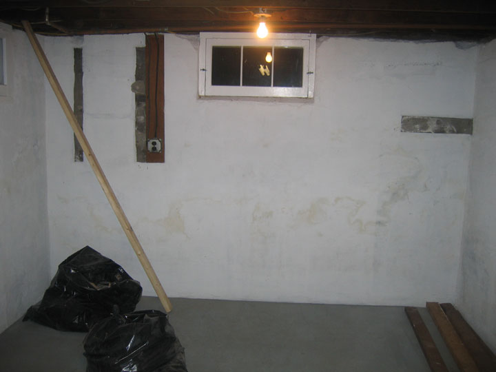

    My new room will be 10 x 14 x 6 w/L/H. The front, left and right walls
    are cement walls, this is in a basement. The back wall will be sheet rack
    (not built yet). The ceiling is unfinished, I'm thinking about leaving it that
    way. The space between the floor joist kind of gives the room some more
    height. I can also put treatment between them.
    I will post pics of my progress when I get my home computer online of.
    I will also be in need of advice for various room treatments, and how to
    measure room response yada yada yada.
    Greg

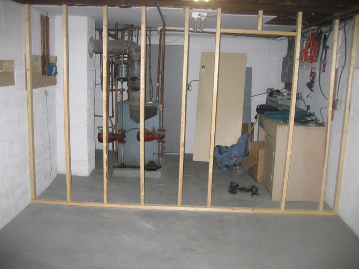

                    Can't wait till I start, with all this measuring stuff I still don't have a working computer connection at home so I can't post pics yet
                    Just framed out my back wall.
                    Greg

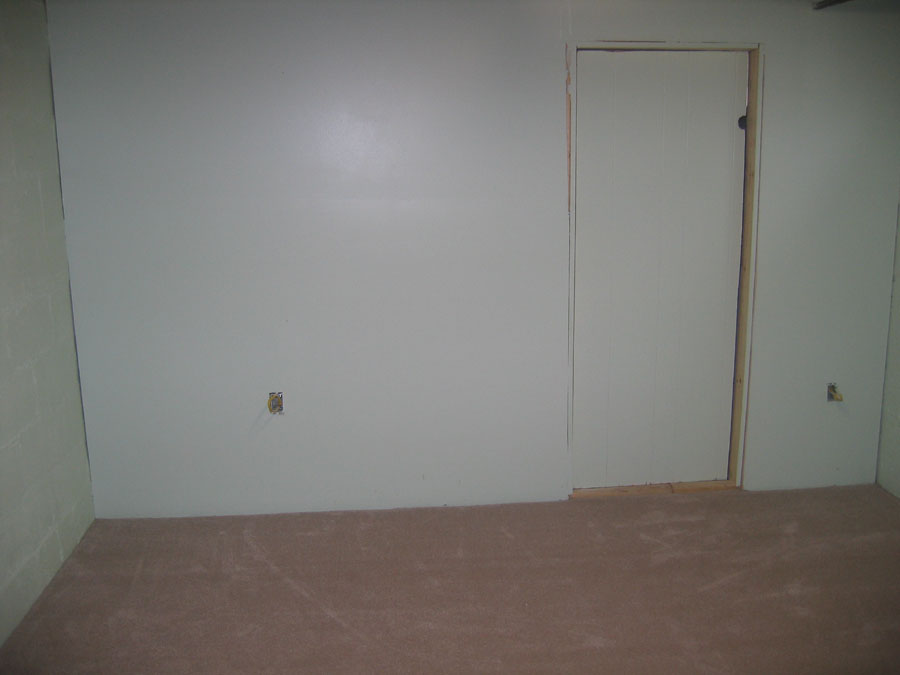

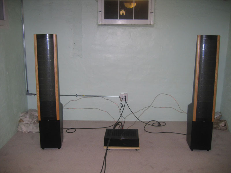

                          Still working on it.
                          At least I have sound now. Better get the door installed next
                          Greg

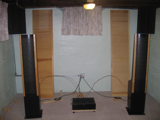

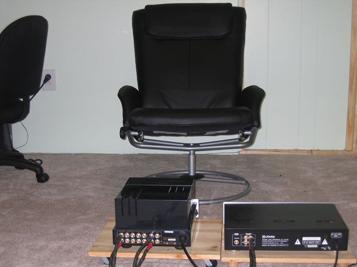

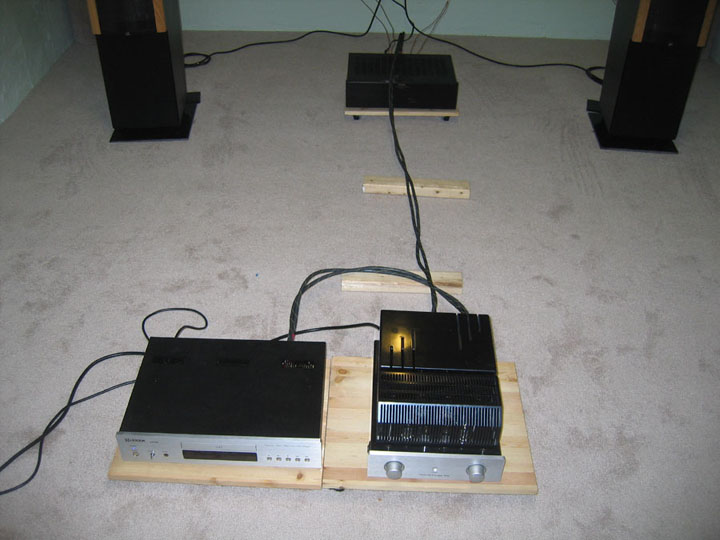

                                  some more pics. Still have to get a rack, new amp and new interconnects.
                                  Greg

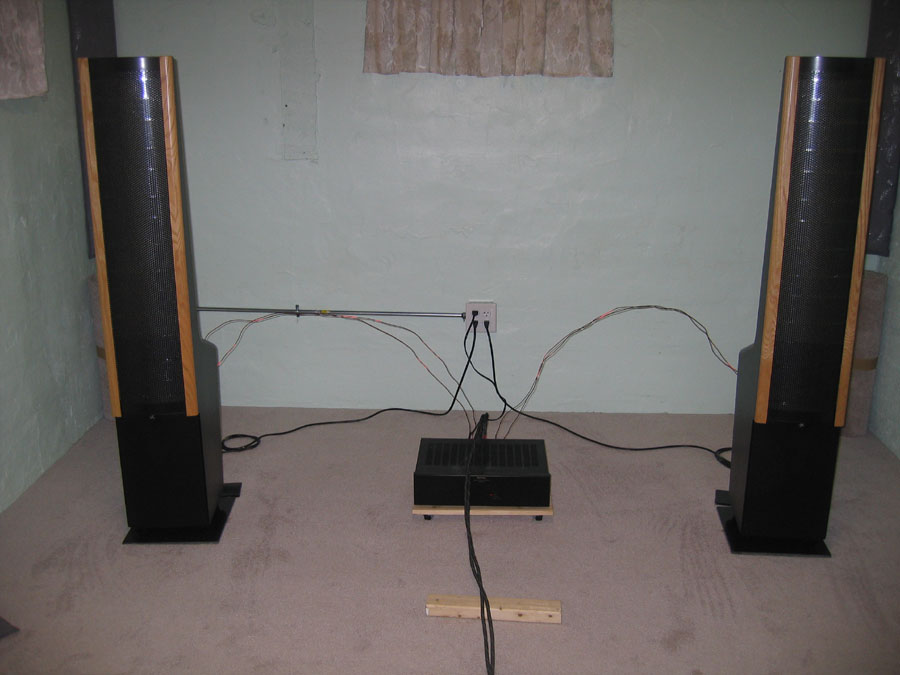

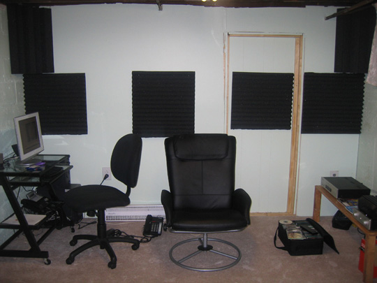

                                      Added some room treatments, and moved things around a bit. The treatment really made a difference with the imagining. I still want to add some treatments at the side of the speakers. I'll need help to do the mirror trick, so I'll do that in a few
                                      Greg

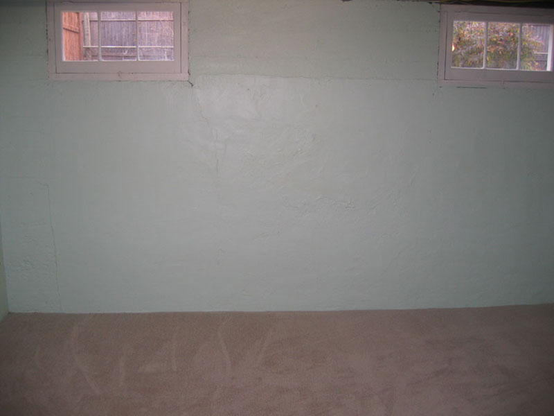

                                        Covering Walls
                                        What should I cover the walls with, Sheet Rock (dry wall) or wood, the tongue and grove stuff?
                                        Greg
