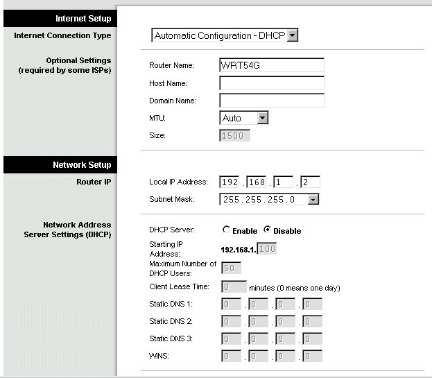

                  Thanks guys for your suggestions. I assigned the router(secondary) 192.168.1.2 as you suggested dougie once I logged onto the linksys. I figured out I was using www.192.xxx instead of just the right way, numbers only. Now I cannot log onto the router as you guys suggested might happen. I have taken a screen shot of the current router configeration and am including it. This is the secondary router which has a link to the primary router via one of the 4 hardwire ports in the back not the internet port. Which leaves me 3 hardwire ports for the other computers. I hope the screen shot helps.
                  Richard

                    You probably don't want the "internet connection type" to be DHCP. You should have a static IP option to which you can set up the primary router as the gateway.
                    Danish
