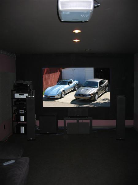

    My X1 came in yesterday.
    Mounted it and the screen yesterday.
    Got my room back together today ( ditched work early ) .
    Had a wicked ground loop hum.Plugged the X1 into my Panamax Max 1000+ and then plugged it into the HDTV plug in in myMonster HTS5100 to get rid of it.
    Everything OK.
    The little X1 exceeds my expectations by a mile!! Looks amazing,using the s-vid for now running off of my Sony DVPS7700.
    Haven't seen any of the imfamous "rainbow effect" . Maybe I'm immune. Maybe some people were using lousy DVD players or low quality cables ???
    Gotta go. Gotta watch more movies . I'll post a review later .
    Oh yeah, by the way it's 92" diag 16x9 (80"Wx45"T view area.) It looks huge compared to the 50" Toshiba it replaced.

          I blacked out the screen wall today using black automotive trunk liner cloth.This really seemed to help out contrast levels.The X1 is getting better looking all the time.
          The system even sounds better with the 50" TV "box" out of the room.Imaging improved.The front speakers are 3 1/2' from the front wall and 22" from the side walls.The room is 12'wide by 25'long by 7'6" high. Main seating is at 14' from the screen.

              The projected image looks a bit washed out from your pics. ops:

                    That was just a joke. The pics were obviously showing off the screen in your HT.

                          Got my Draper screen today.It was 100" diag 4:3.So I had to cut down the bottom and trim the matte black at the top(to 92" diag.,16:9).
                          I pulled back the black trunk liner cloth on the wall.
                          Then stretched and stapled the Draper over my DIY MDF screen.
                          Reattached the cloth and voila!!
                          The Draper with a gain of 1.0 is a little brighter than the Behr Ultra Pure White Flat paint.
                          Picture quality is excellent.
                          It works very nice with the ND2 filter in place on the X1.And the price was right "FREE".
