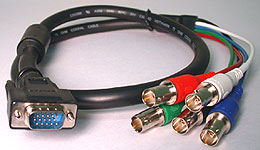

                I don't think you understood what I was trying to tell you. The projectors accepts 2 types of video signal. The 2 signal are a completely different electronically signal and not interchangeable.
                1) S-video/composite is the standard 480i crap signal. IT's totally useless unless your into vintage VCR tapes.
                2) RGBHV is a full bandwidth signal that can be run directyl from a VGA port using a 5BNC breakout cable, like the attached pic.
                These 2 signals are totally different and the PJ doesn't know which one your trying to feed it. I can't tell from your confusing first post but if you haven't already done so, you need to go into the PJ's internal menu's and choose the input which will make the S-video /composite board active. If you have already done so and still not getting a pic, then it could be simply that the s-board is bad, but not likely.
                Since the previous owner had it running, presumably through the RGB port, just spend the 20 bucks and get that cable from mono-price. It will plug right into the VGA port on your X-box and onto the 5BNC's on back.
