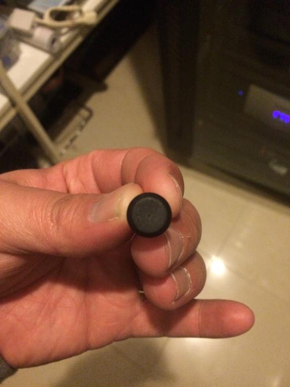

              Im curious what these plugs look like, is there any chance you can post a picture?

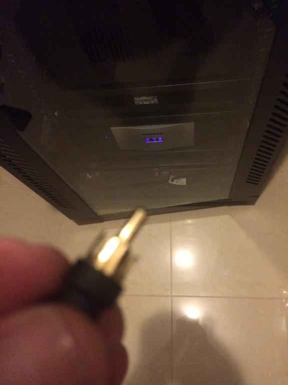

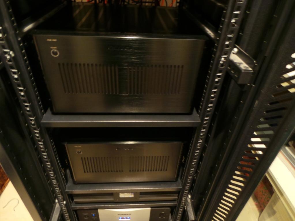

                  As you can see I thought plugged into RCA they were Dust caps. Problem is when I swapped cord to try RCA it didn't occur to me at the time pulling out the dust cap that it was an RCA Cap, I guess annoyed that XLR wasn't woking. Didn't mention it in the Manual either.

                    That is very interesting. I remember on the RMB1095 they had similar shorting plugs (with a small resistor inside), they were only supposed to be used when one used the DB25 plug. At least that manual made reference to it.
