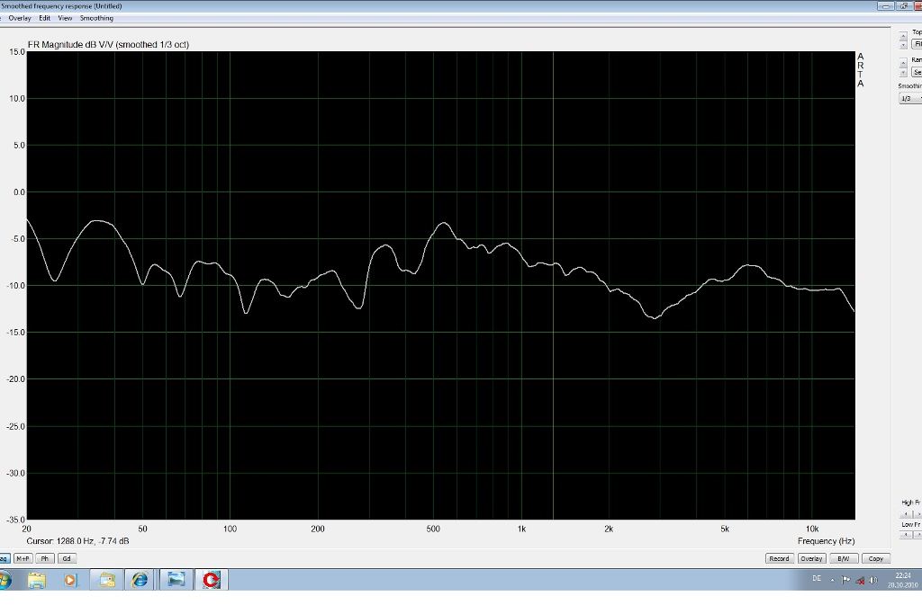

                                      Yeah I think so, I've done it via ARTA with every single chanel. The picture shows my two fronts and the subs (3, sba-pattern).
                                      Thanks for the subwoofer correction table!
