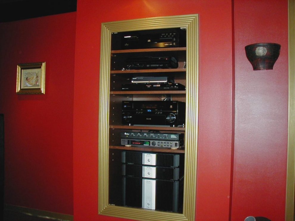

I have my 10 series amps stacked with a 1/2 inch spacer under the feet and they only get warm. They actually feel the same as before stacking them so I would think the cooler running 15 series wouldn't be a problem at all.

I think it's more liability for people with no common sense. Most racks have active cooling and a large open area behind. I'm sure the 15 series will be fine in a typical cabinet stacked on the feet that come with it.
Now if you remove the feet like you would in a rack mount situation and shove it in a cabinet with no space on any side, sure it's probably going to overheat.

I think that caution warning is just to absolve the manufacturer - and rightly so - from abuse stemming from bad user placement.
The realities of your situation may be that there is no problem at all - I put my RMB-1075 in an open rack, but the shelf above it is only 1.5" from the top, but the sides are open and there are no issues.- Bottom
