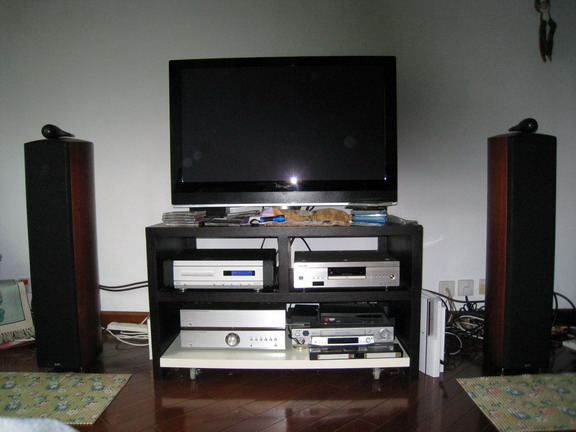

Using same setup as above, I connected my friend's B&W N804S as shown in attached photos.
Listener distance is ~8 ft, distance between speakers are ~ 6.5 ft, distance of speakers from rear wall ~ 1.5 ft
1. I found the N804S has produced excessive bass, can be muddy at times, for my limited listener distance, someone suggests the D28 is much better for my listening enovironment, any comments? (However, I am impressed by the solid bass from the N804S)

Are these 1.5 ft from the back of the speakers? It's hard to see in the pictures. We have ours about 60cm (close to two feet, measured at the back of the speaker) from the rear wall and found that a good compromise for a clear bass. Our listening distance is still around 12ft (leaned back) or 10ft (leaned slightly forward).Originally posted by cntlawListener distance is ~8 ft, distance between speakers are ~ 6.5 ft, distance of speakers from rear wall ~ 1.5 ft
We had that only when the speaker was too close to the rear wall. Also I think as you are coming from a small speaker, you might overestimate the bass of the 804S which is normally okay, or even on the light side.Originally posted by cntlaw1. I found the N804S has produced excessive bass, can be muddy at times,
Currently we drive the 804S with a Rotel RA 1062, and are shortly before an upgrade. Maybe MF A5. The 804S need a stable amp that can deliver punch down to 4 Ohm, but that's it. It's not too hard to drive.Originally posted by cntlaw2. Is it wise to move from my Response 1sc to D28 or N804S without changing my 100W A3cr Pre+Pow? Must I go for MF A1008 or A5.5 ? And which?
I bought CAT cables (copper) for the good build quality and to support the forum. If I want to imagine better sound, I invest the money in a good red wine with better effect than cables ...Originally posted by cntlaw4. Need recommendation of a Interconnect Cable for my A3 cr Pre and Pow instead of the old AudioQuest Viper I am currently using.
I'd try it with the amp you have - it should have enough power to drive the 804S just fine for normal to even loud listening levels. As you are quite close the speakers, that shouldn't present any problem at all. We have a rather large room and the 60W Rotel RA 1062 isn't too bad. We just want to be on the safer side.Originally posted by cntlawI also want to find out, with either the D28 or N804S, will there be significant improvement if I also change the Amps to the 1008 or the A5.5? Will the power be too weak if I am keeping the A3cr to push the N804S.
The 804S is a really great speaker, but needs proper placement and an amp that can deliver into 4 Ohm. You power amp should be able to handle that without a hickup if you are not turning the volume too high with home theater use.
If the 804S is too bass heavy for your taste, try the 805S which is an amazing speaker in my opinion. I absolutely love it, but for our taste the 804S had the right punch for our music taste, was in a really good harmony and coming from them to the 805S the latter lacked in bass.- Bottom

Originally posted by cugAre these 1.5 ft from the back of the speakers? It's hard to see in the pictures. We have ours about 60cm (close to two feet, measured at the back of the speaker) from the rear wall and found that a good compromise for a clear bass. Our listening distance is still around 12ft (leaned back) or 10ft (leaned slightly forward).

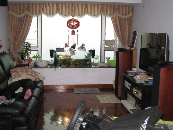

In past few days, I have been reworking my sitting room and now is able to allow the 804S to have a distance of 2 foot from all walls. The speakers are now placed 6.5 ft apart and my listening distance can vary from 8 ft to 11 ft. See photo. ( I have placed some stuff to block the two rear corners )
The Amps are restacked over the window bench which has basically resolved the muddy bass issue when I was placing the CDp in front of the speakers!

I would also play with tilting the speakers a bit in the direction of your listening position. I have them about 5 degrees tilted inwards. We played here with positioning for about a week with my wife sitting on the sofa and me moving speakers ...
I can see that you have spikes on the 804S. How solid is your floor? We have them sitting on concrete which really helps tightening the bass compared to having them "float" on the carpet. People here worked with granite or similar to decouple the speakers from the wooden floor. It's something I'd try: maybe at one of these kitchen outfitters they have some parts left you can use - put some felt pads under them and use the spikes on the speakers if the surface is rough enough so they don't move.
And you can play around with distance from the side wall - remember that you get reflections from the floor and side wall. If you have a carpet - put it between the speakers and your listening position for a test. If you don't, use a comforter or blanket for that test. That might also change the sound significantly (way more than an amp upgrade).
Hmmm. Have to think about more ideas. What is behind your listening position?

Btw: your listening room looks good now! As I said: a carpet will change the sound probably more than any amplifier (except a broken one) can ...- Bottom
Yes, although the CDP was placed on a very strong 60 lbs rack, but it made big difference after I relocated it to the back of the speakers window bench instead of placing it 4 ft. in front of the speakers.Originally posted by cugInteresting. I've read that the A5 CDP is sensitive about vibrations......... which is basically your experience, right?
Most here live in apartment without raised floor, so the floor is 'solid' except the floor's wood stripes are not often evenly glued, so need to adjust the levelling screws underneath after a speaker is moved.I can see that you have spikes on the 804S. How solid is your floor? We have them sitting on concrete which really helps tightening the bass compared to having them "float" on the carpet. People here worked with granite or similar to decouple the speakers from the wooden floor. It's something I'd try: maybe at one of these kitchen outfitters they have some parts left you can use - put some felt pads under them and use the spikes on the speakers if the surface is rough enough so they don't move.
I have done so, see photo. Perhaps I need a thicker carpet than that one.And you can play around with distance from the side wall - remember that you get reflections from the floor and side wall. If you have a carpet - put it between the speakers and your listening position for a test. If you don't, use a comforter or blanket for that test. That might also change the sound significantly (way more than an amp upgrade).

Photo, the 3-seaters sofa replaced by a 2-seaters
Photo, reconnected R1sc to KW, the A3cr all ready for disposal:

Some changes to the room:
- shifted the turtle tank to the left side ( big job yesterday)
- relocated the KW550 to the windows bench leaving the power unit in the corner
- cleared some garbages, sold the A3cr, R1sc/stands
- loaned a clean power regenerator for the A5cd
Time for rock'n'roll !

Today is my big day!
Without too much effort to burn it in, the 803S is already very listenable! I know I should stay away from the temptations and put a burn-in CD....
The very first song impressed me today on the just open box 803S is the Private Investigation of Dire Straits, the last few drums beats really couldn't say B&W are 'fat bass'!
ops:
And, you know what it is like for a guy like me coming from a Proac Response 1sc for years to now a gaint B&W floor stand. Just couldn't resist to keep playing the 6th track of the Four Seasons, all these 'thick' strings....lovely.
Love the speakers a lot. I am still listening to it.

The 803S are now being placed 6.5 ft apart leaving ~2 ft from walls all around instead of initially under 6 ft, the improvement is very significant.Originally posted by cugNice setup now! Looks good with the 803S. Guess they are not too big for your room.
The listening distance is pretty close to the 804S, with same volume, it is more comfort to the ears if leaning backward 2 feet than the 804S I tested last time. During the burn-in period, sound quality varieis from music to music, it is not yet able to determine if 803S can produce sound as good as my friend's already burn-in 804S. There are noticeable more bass from the 803S but in terms of required sound stage filling up the room, it is the same as when I had the 804S. I could hear the depth is more behind the speakers with the 804S, not the 803S, may be this is just another new speakers issue.
Overall, after two days running them, it is very listenable.
My friend told me it takes 500 hours to burn-in the speakers. 8O
