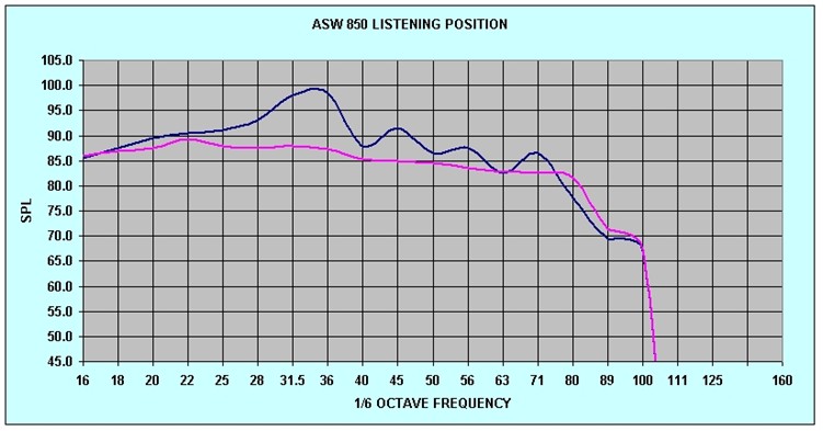

                  I leave the C2 to autocalibrate the levels but I set the sub to run 3db hot. There is something about the LFE out of the C2 that I love. My ASW850 through the C2 and a BFD sounds superb - quite comfortably the best component of my home cinema system.
                  Also before calibrating leave the sytem runnng for an hour - I find that this produces different results from calibrating a system from cold.

                      You might have a big dip - have you tried plotting your frequency response ?
                      If you have, a BFD can make a big difference. I had a large peak which the BFD ironed out easily and as a result the bass sounds a lot more clearly defined, tighter, even and no boom whatsoever. Without meaning to change the topic of this thread below is a before (blue) and after (purple) graph of my ASW850.
