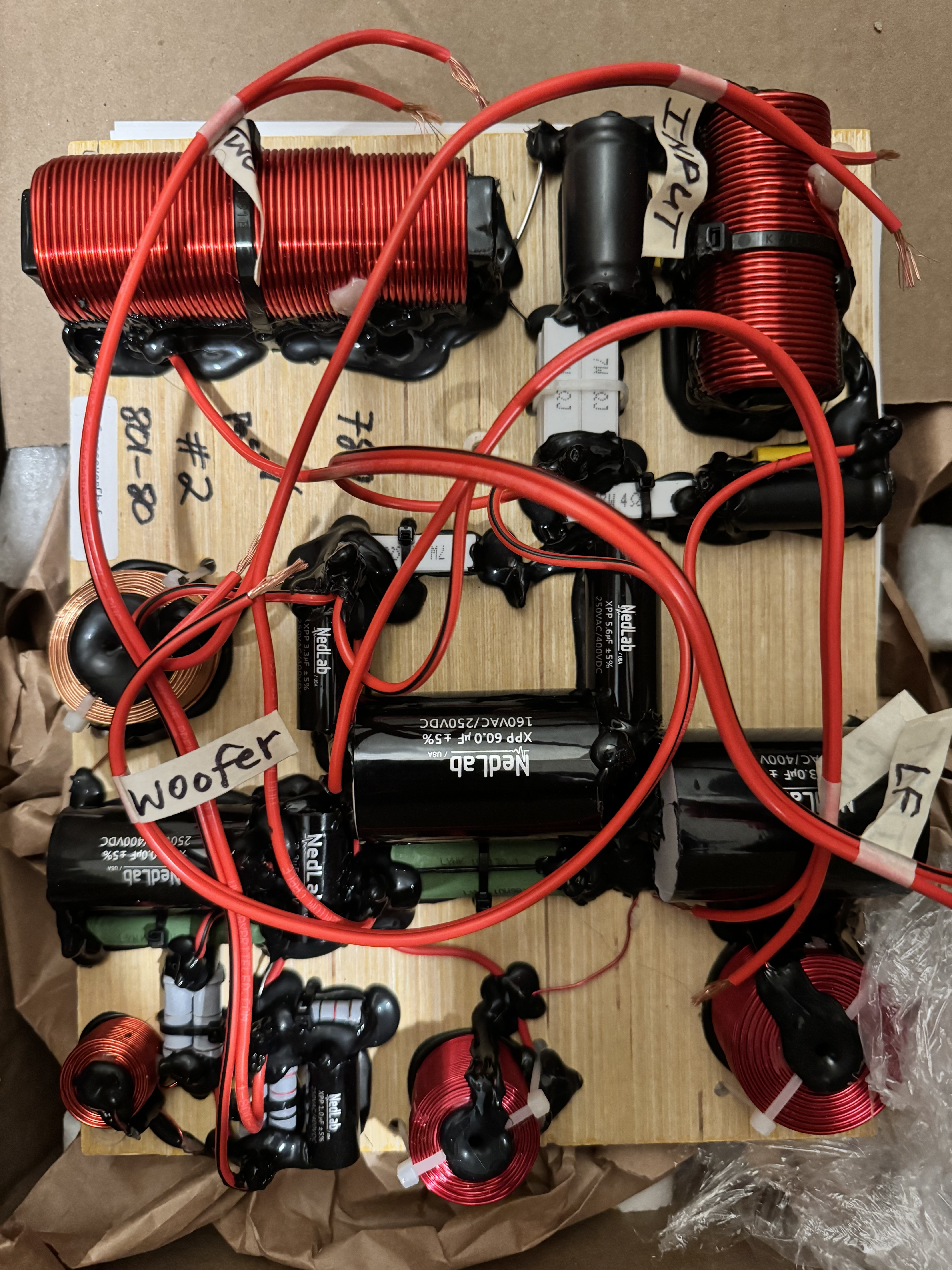

    B&W 801 Series 80 Restoration (1983)
    I re-did the crossovers in my vintage B&W 801s this last summer, write-up here: https://www.yourmom.sh/bw801.html
    I scored these off KSL Classifieds (local goods exchange here in UT) for a steal as I managed to message the seller first. There was nothing really wrong with the speakers, they sounded great! However, I knew they were ~40 years old (confirmed after I got inside them, these were built in 1983) and the caps at least probably needed replacing. I found crossoverchef.com selling rebuilt crossovers on ebay (example listing) and figured that was better than attempting things myself. Honesty, the PCB intimidated me and I wanted to break out the High Frequency (HF) and Low Frequency (LF) so I could bi-amp the speakers. This page documents my journey in restoring these beautiful speakers and making them better!
    1) New crossover network (from crossoverchef.com)

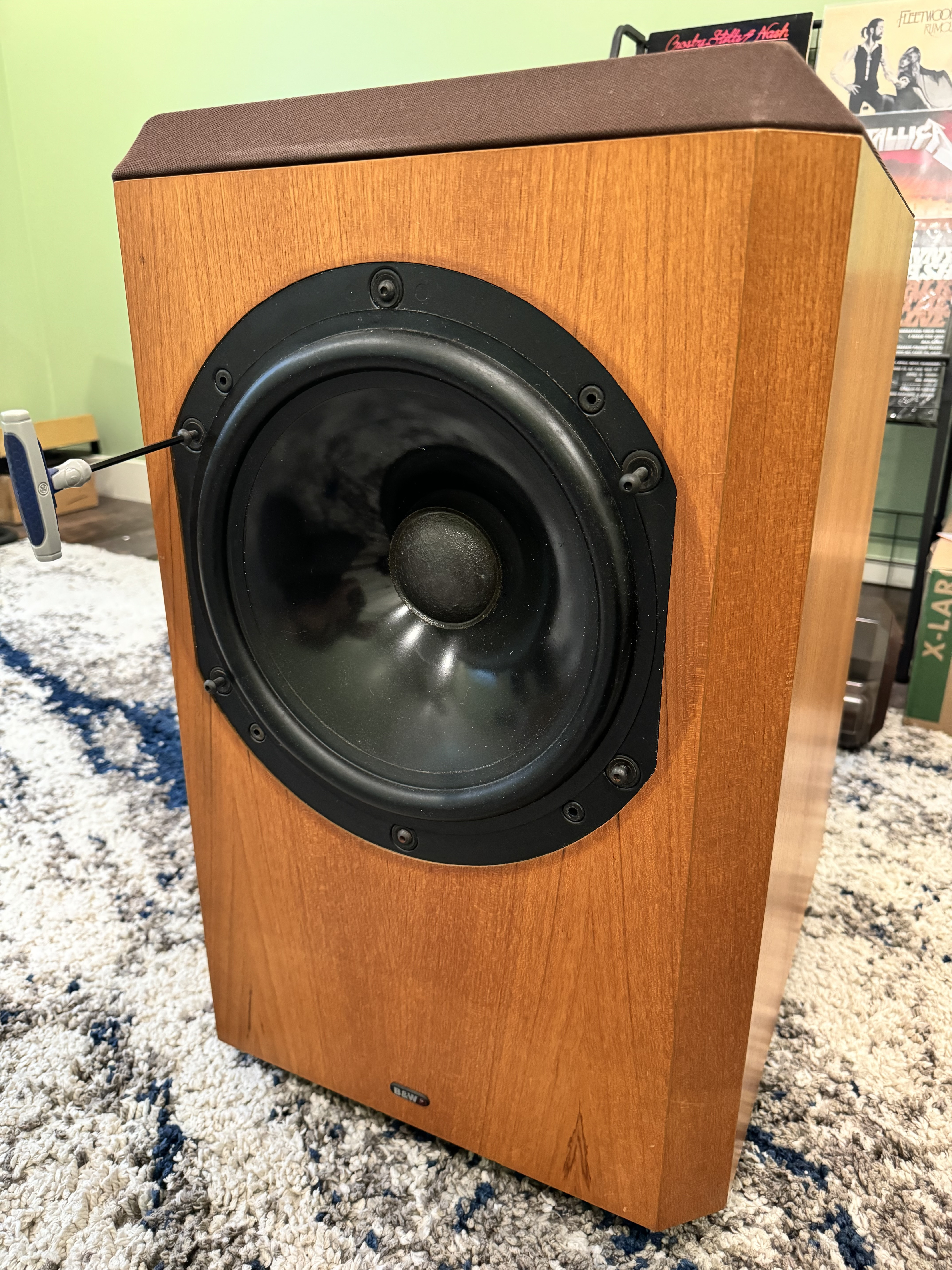

    2) Final listening test before tearing into them

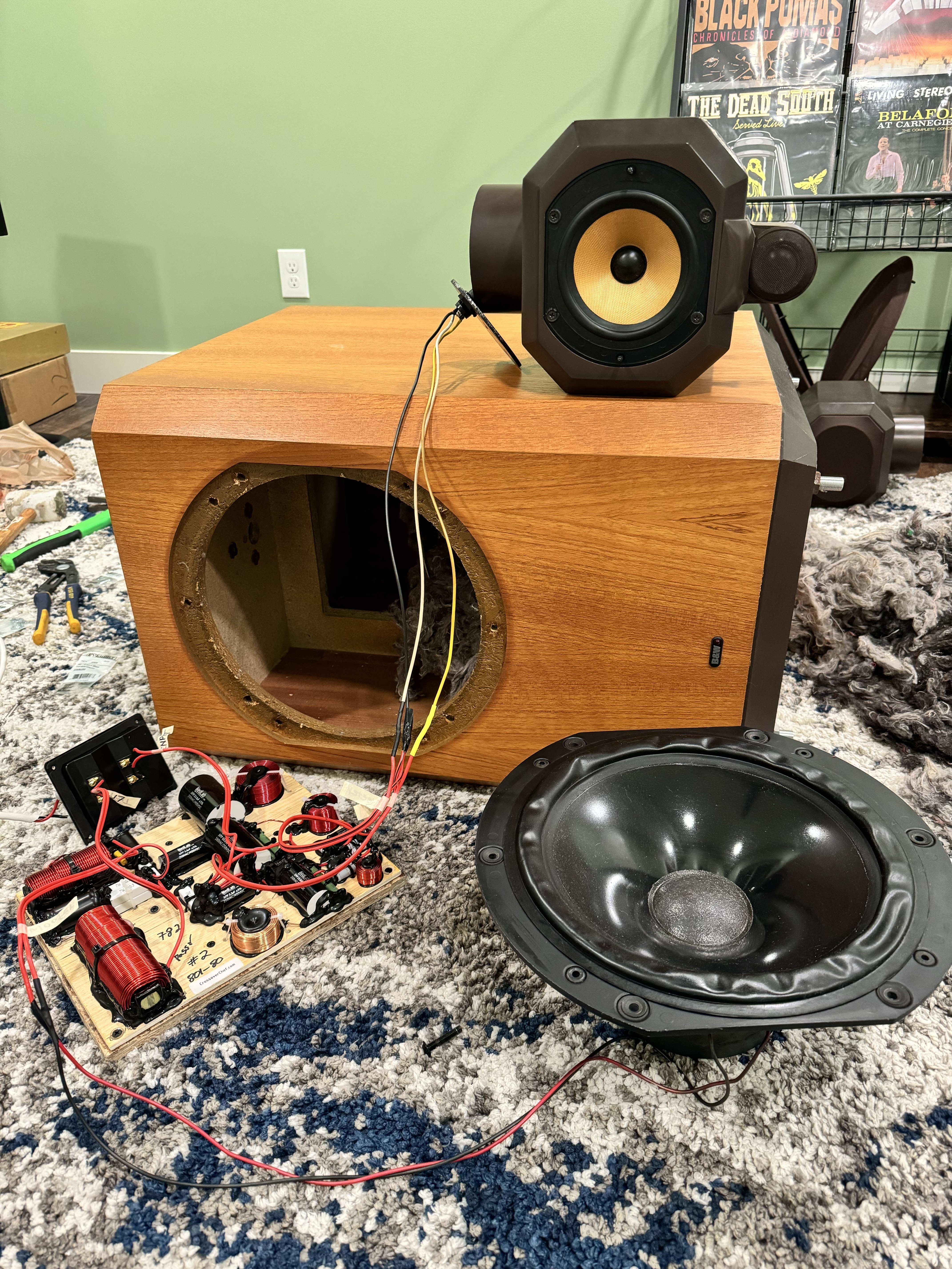

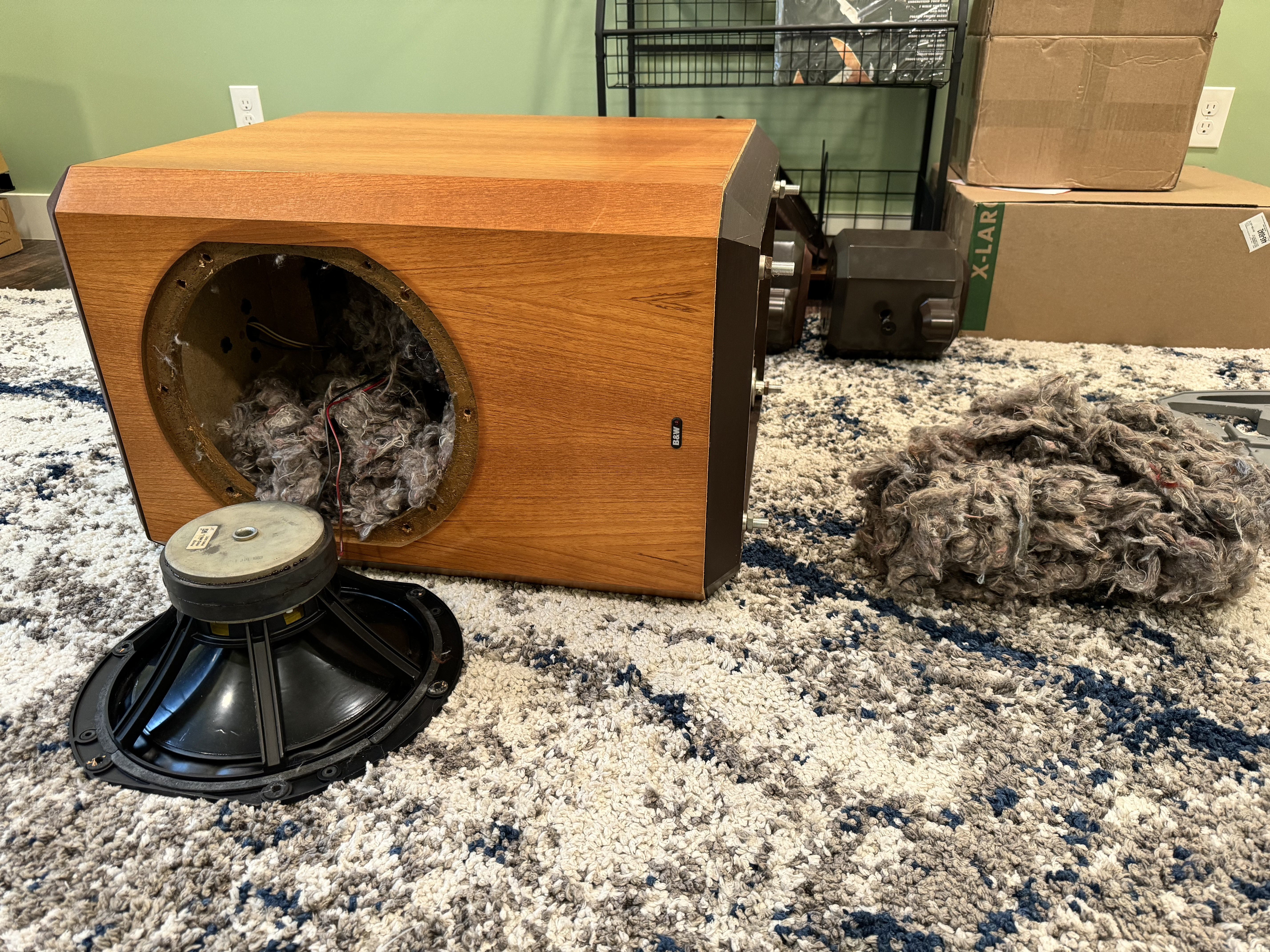

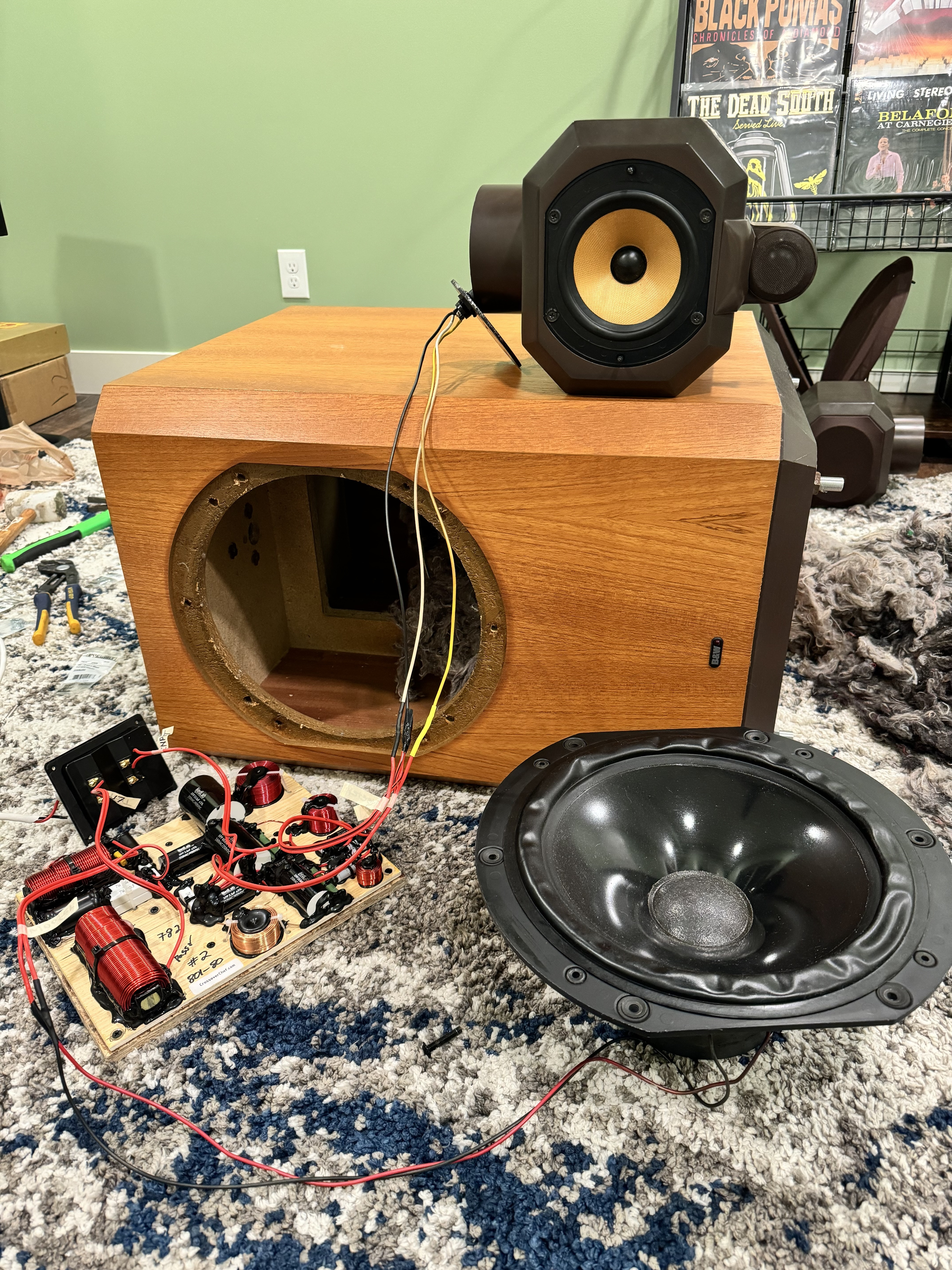

ID:	955513 3) Here we go! Remove the woofer

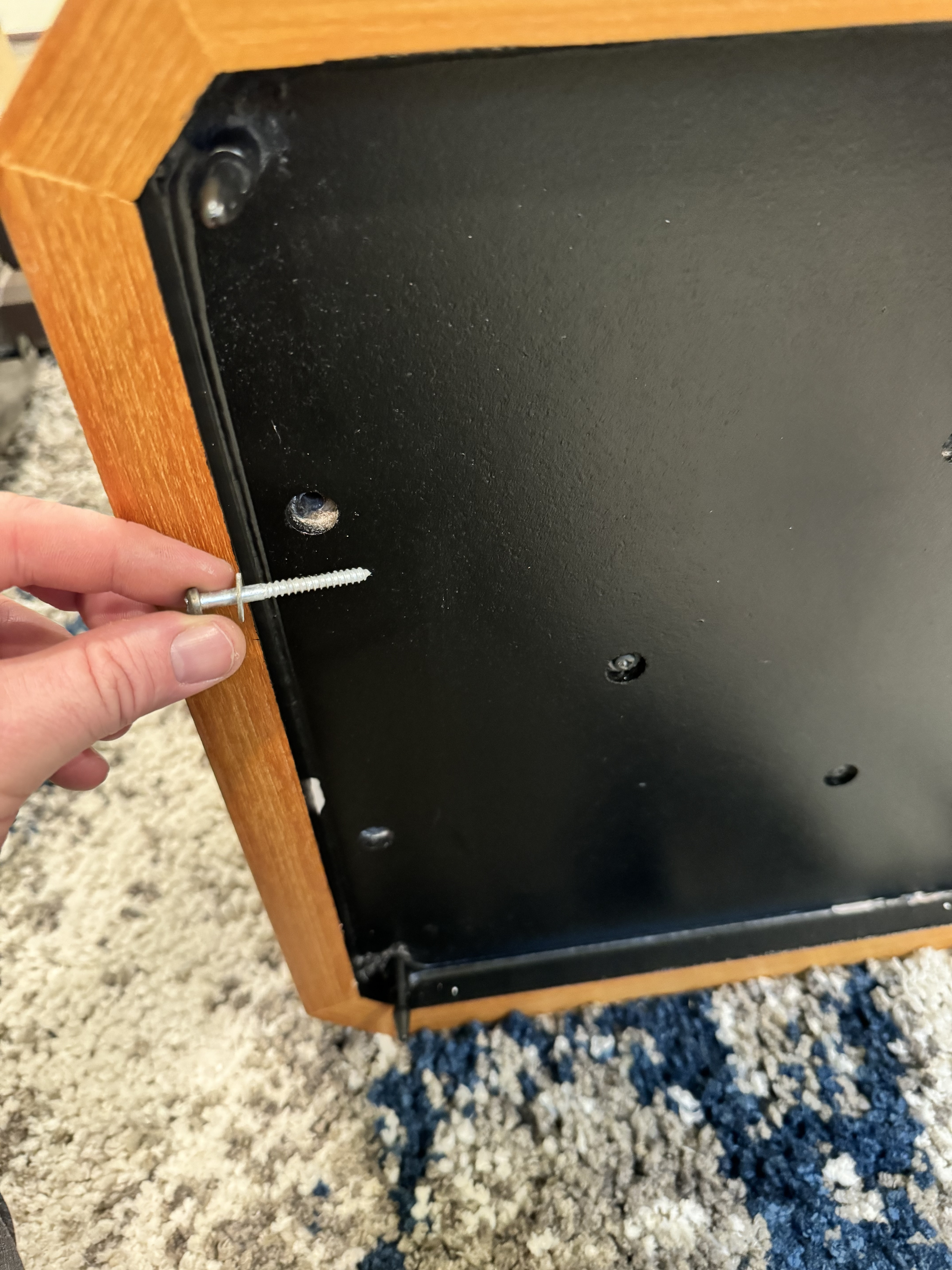

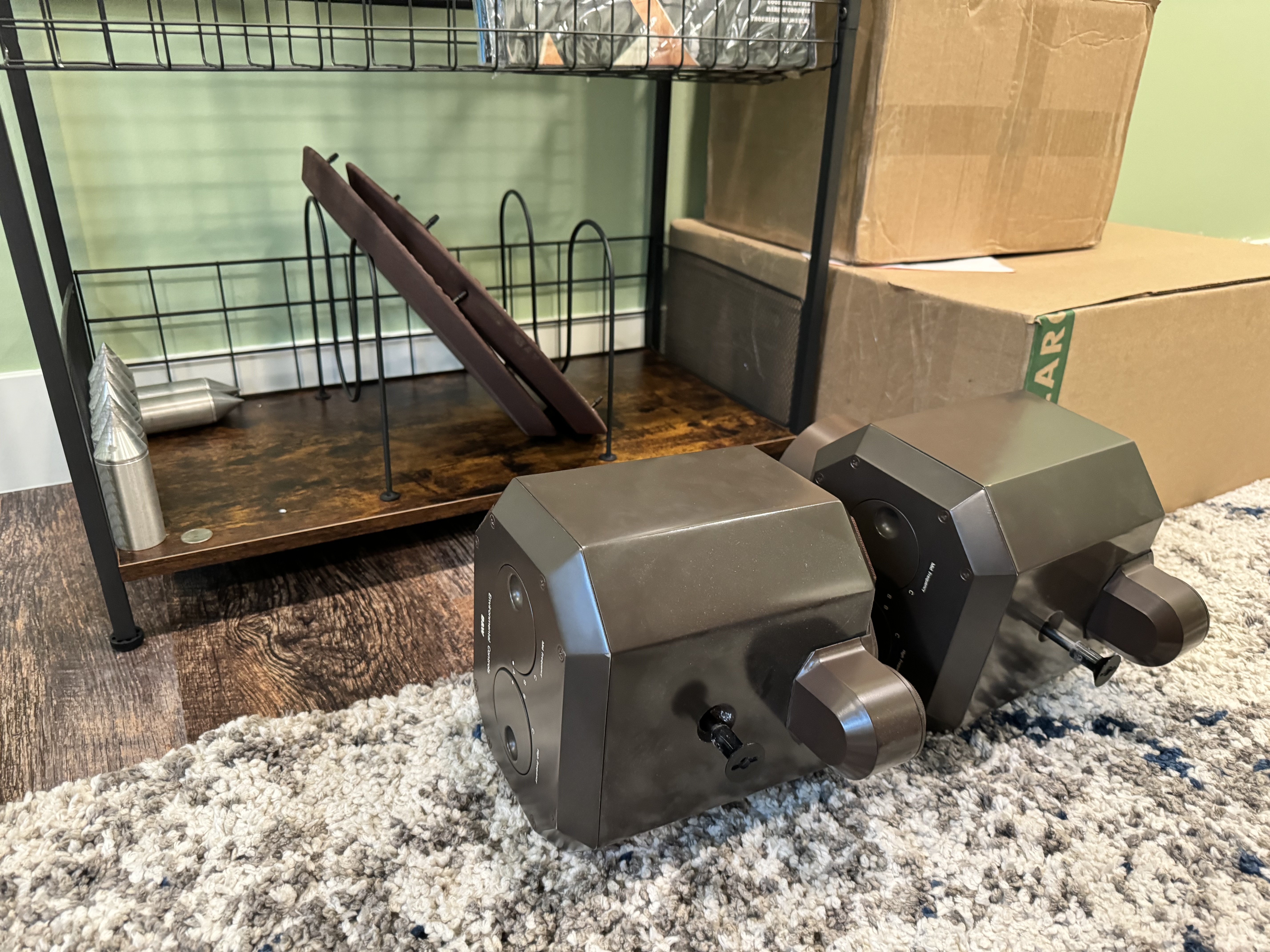

ID:	955514 4) Mid-range and tweeter heads removed, spikes removed, set aside

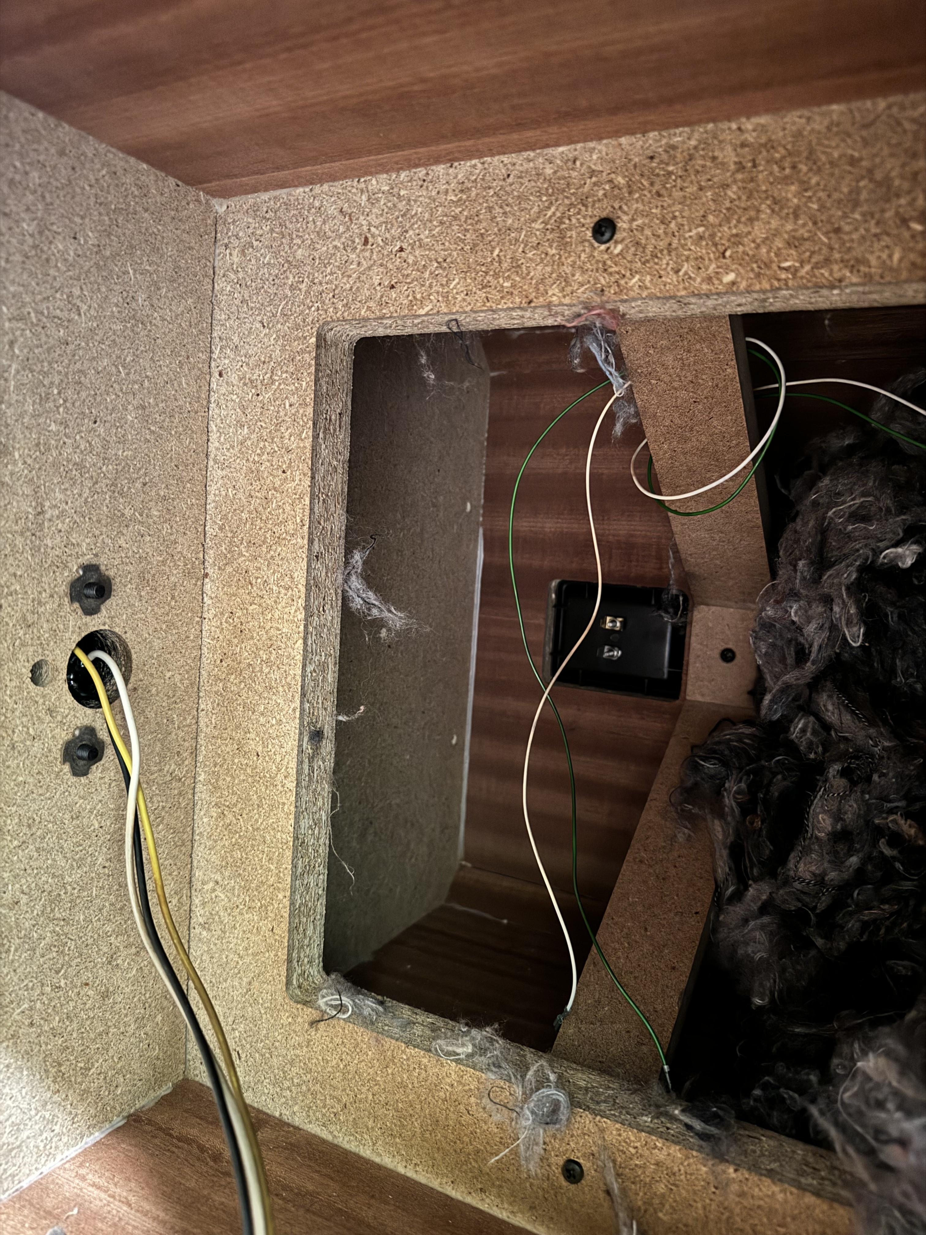

ID:	955515 5) Woofer removed, some of the internal wool(?) set aside. I end up removing all the wool from the top half but leave the stuff in the bottom (there's a ton!)
ID:	955516 6) All the wool removed from the top half

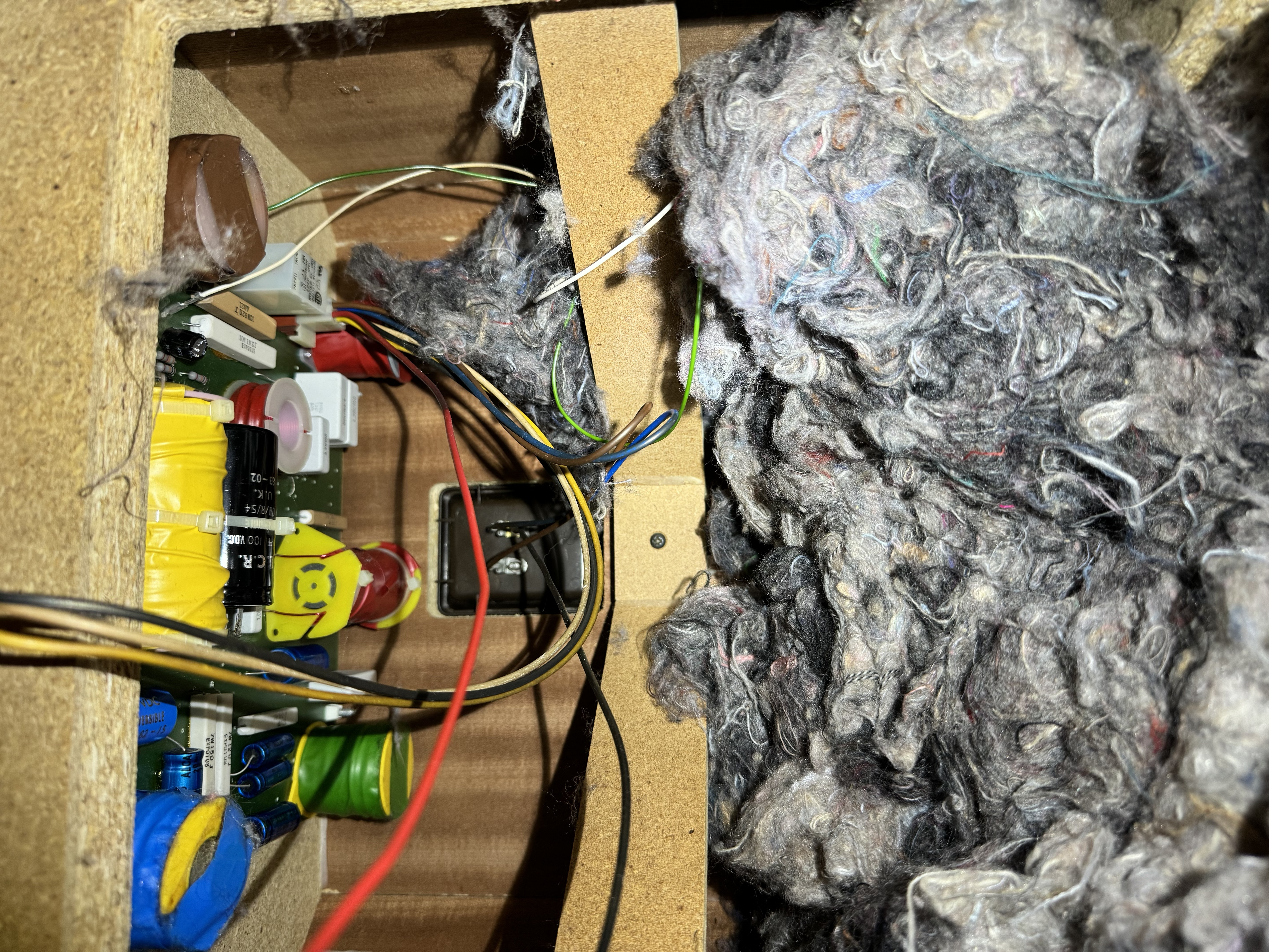

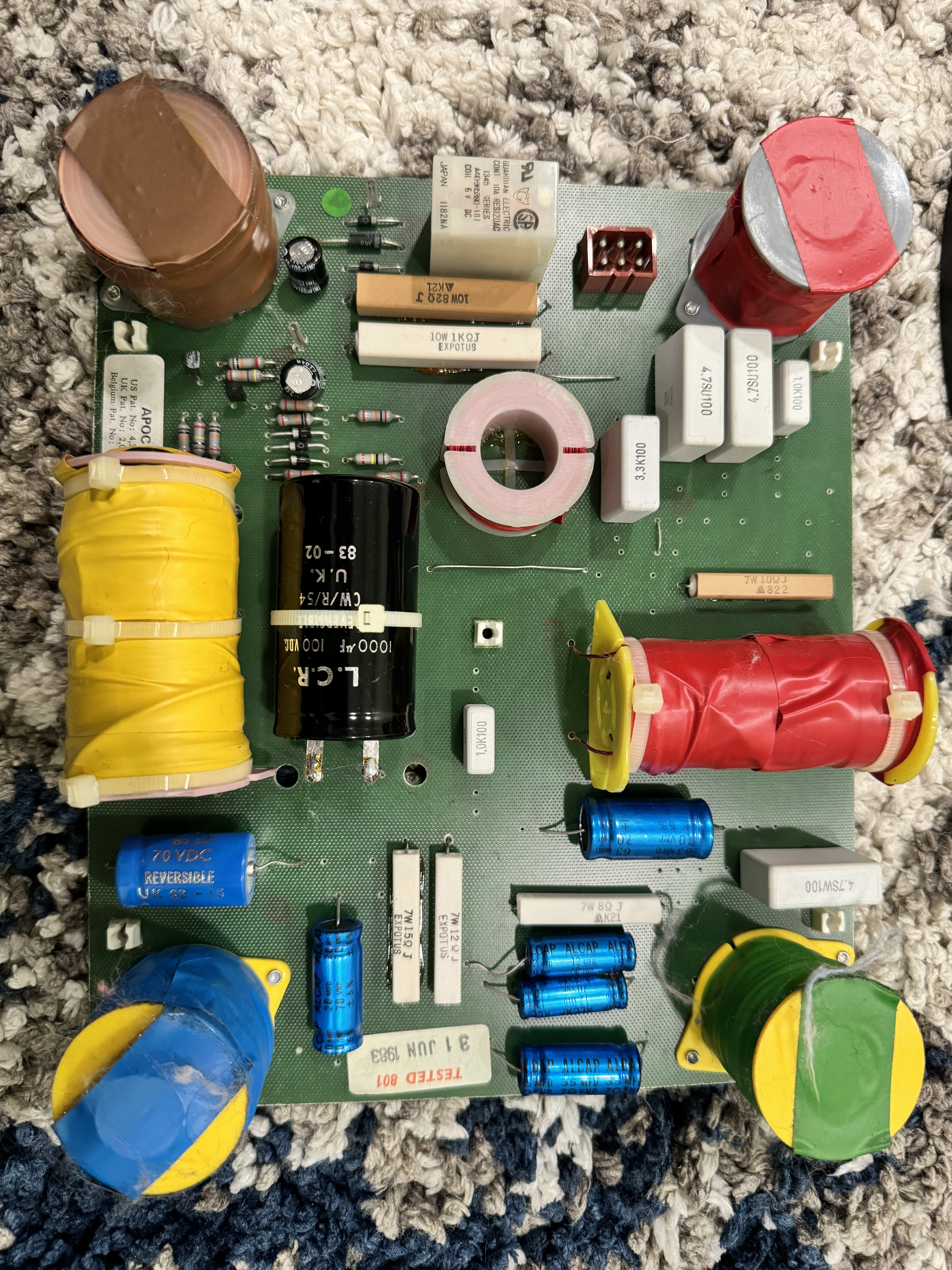

    7) Original woofer crossover as I found it
ID:	955517 8) Better lighting of original woofer crossover

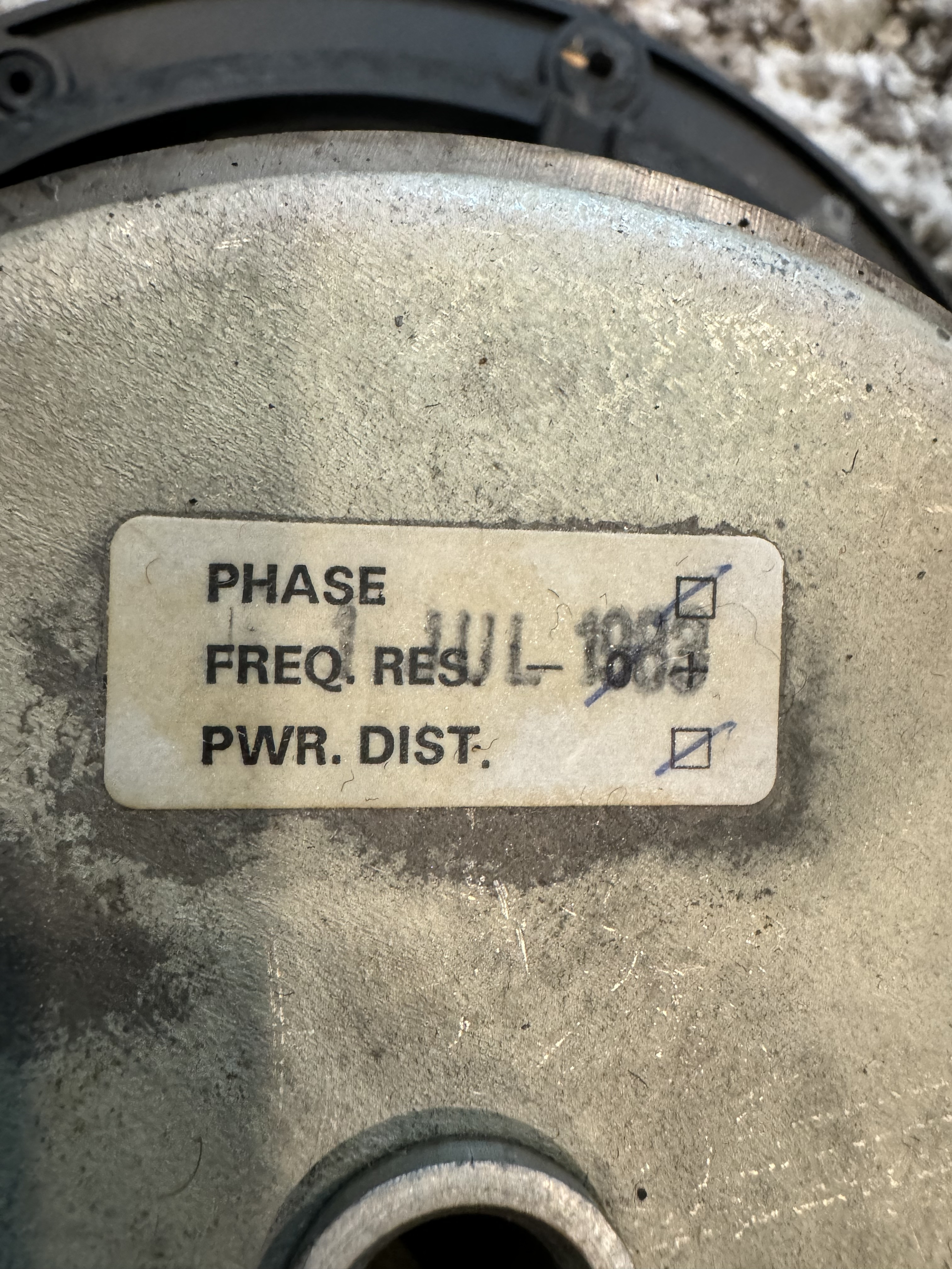

    9) Woofer tested 1 July 1983

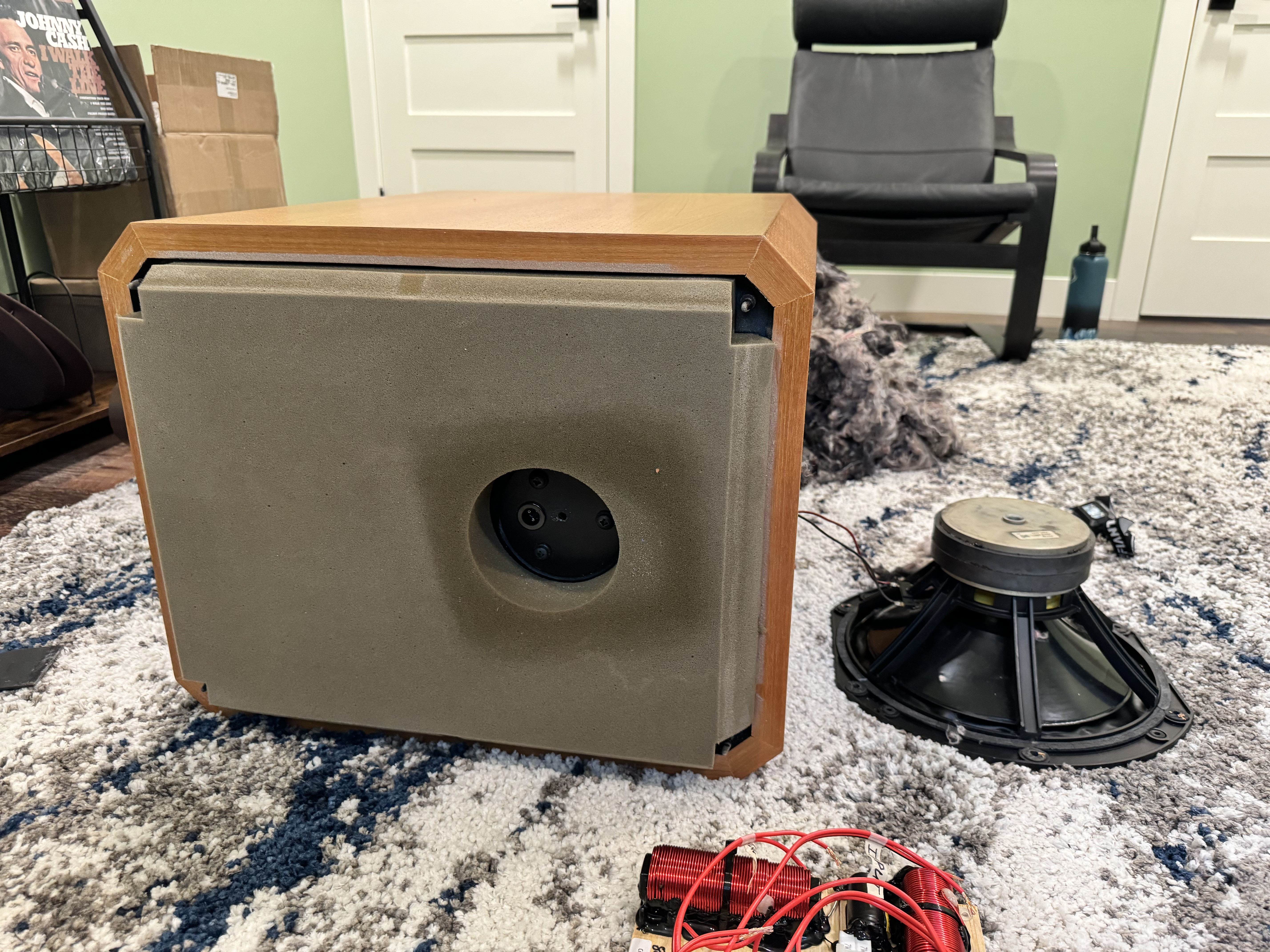

ID:	955518 10) I never knew the top "grille" cover came off, but I always suspected. Works just like any other speaker cover, pops off, big foam pad underneath

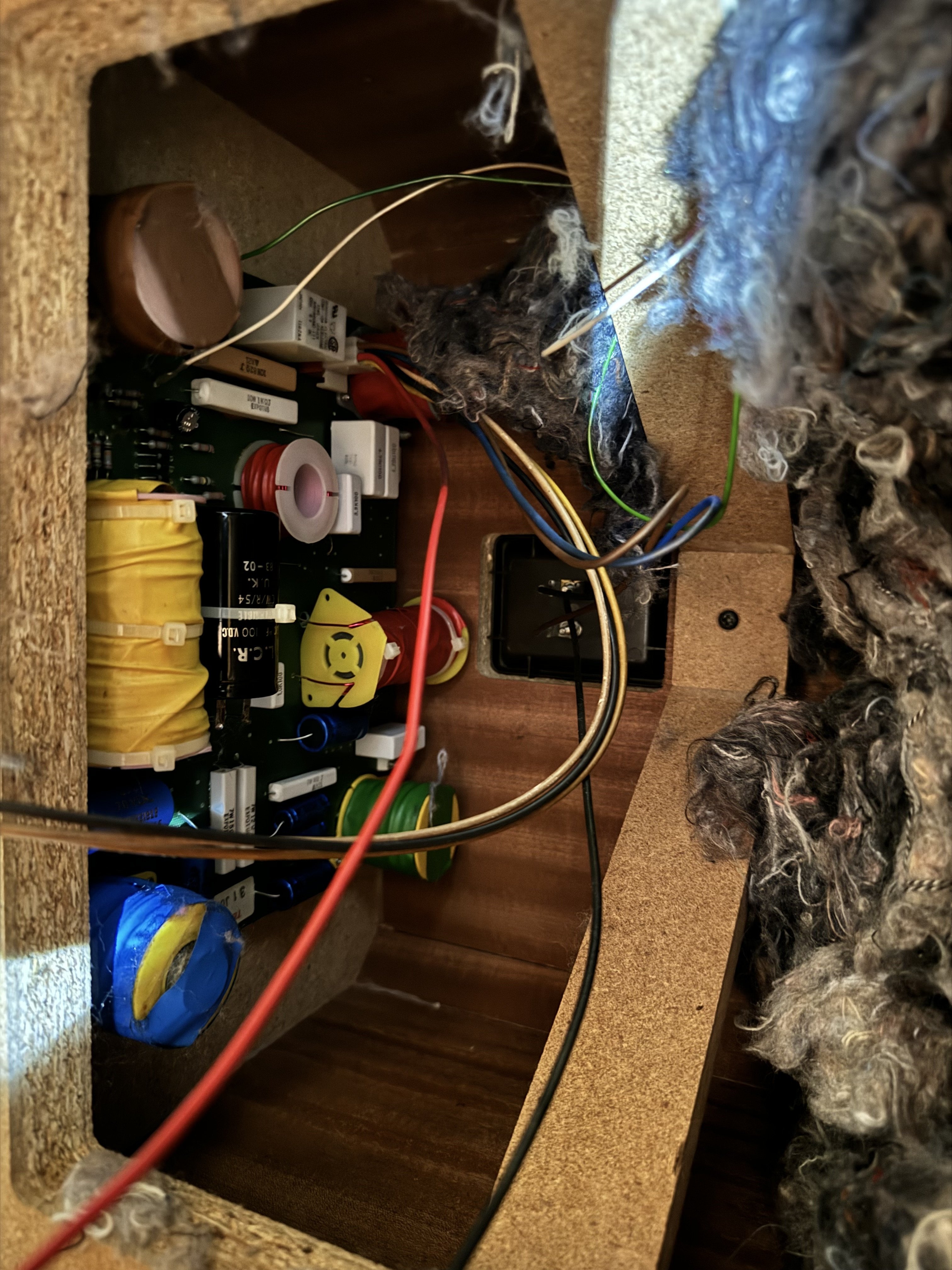

ID:	955519 11) Removed foam pad, there's the screws for the woofer crossover!
ID:	955520 12) Another shot of the crossover to show where original wires go

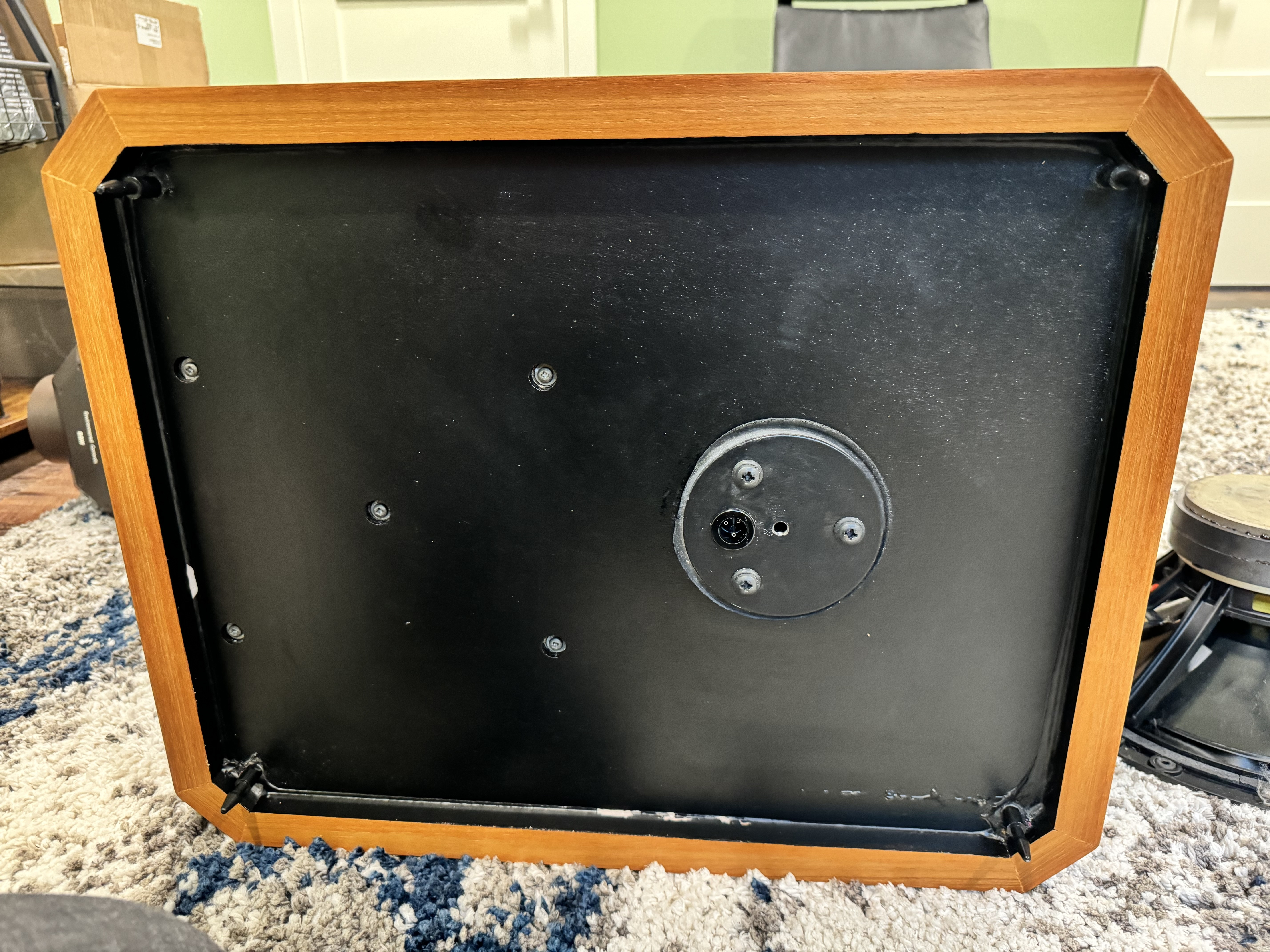

ID:	955522 15) Original woofer crossover removed. Note the June 31, 1983 date at the bottom. The white plastic things are what the screws grabbed onto

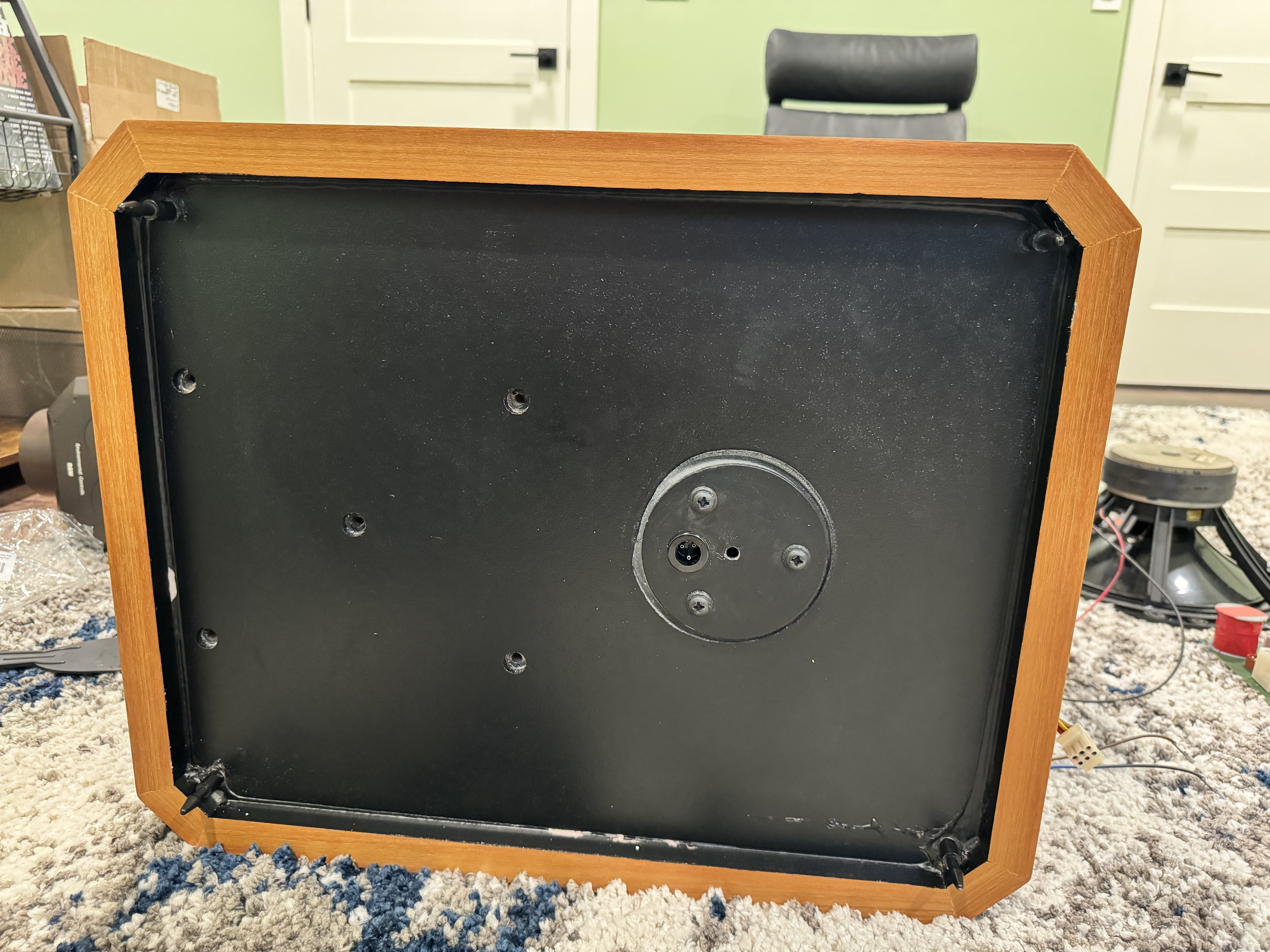

    17) Shot of the inside with the woofer crossover removed
ID:	955524 18) Shot of the top with the crossover removed

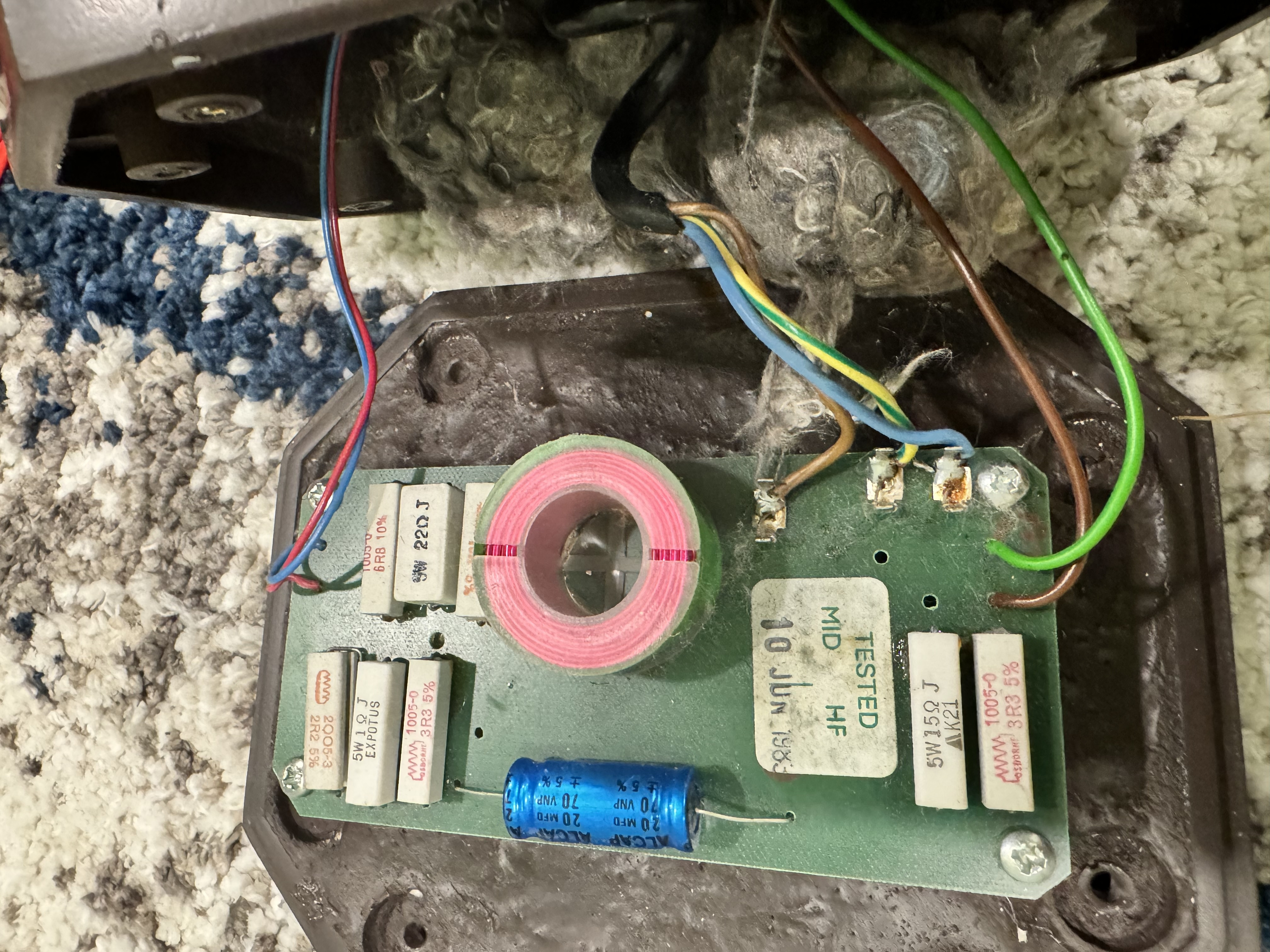

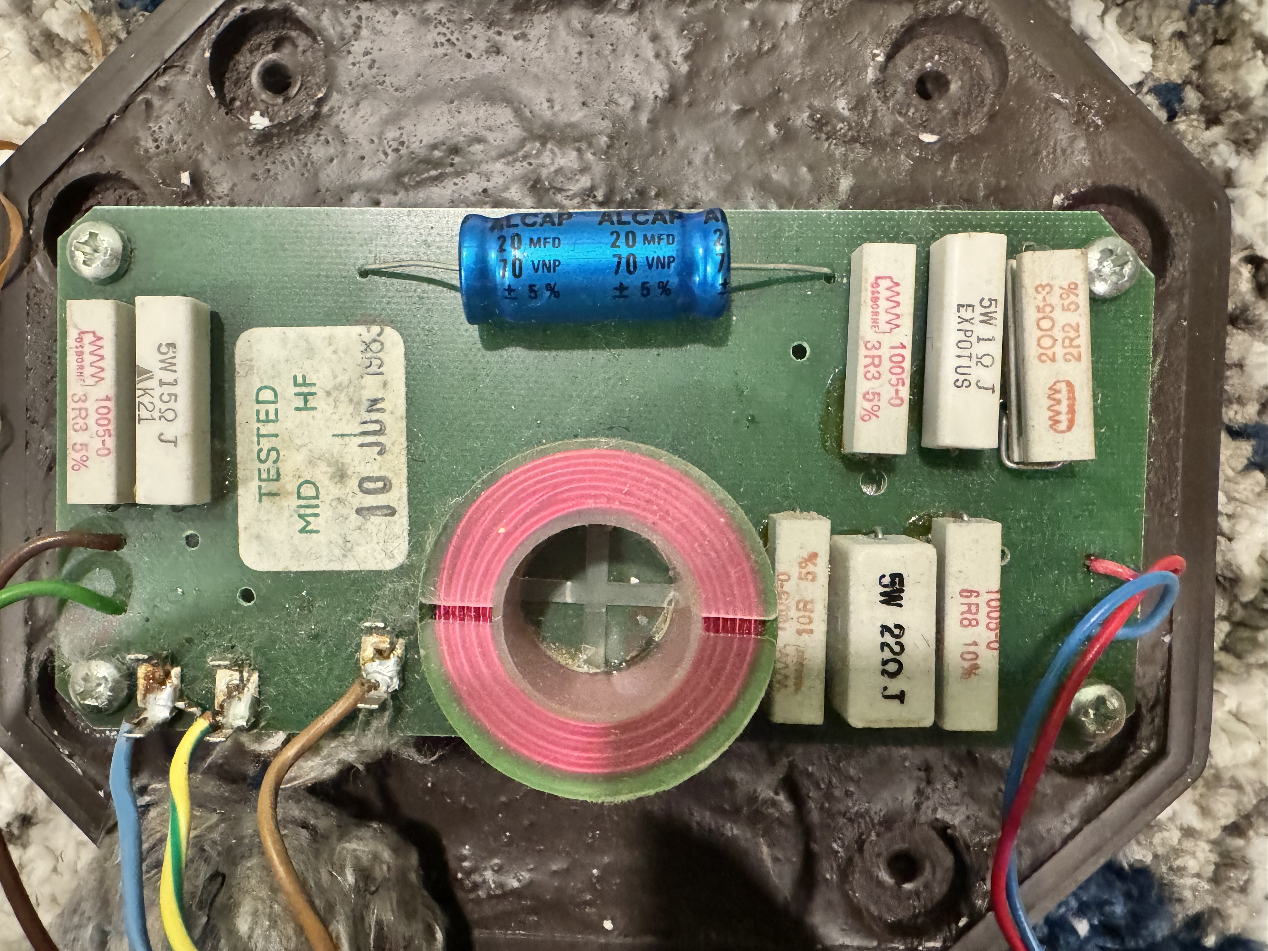

ID:	955525 19) Let's take apart the mid-range + tweeter head! I had to remove the mid-range driver from the front to punch out the back once its screws were removed. Note the rubber band that helped it seal, this was also glued in
    20) Another shot of the mid-range + tweeter crossover and environment controls board. June 10, 1983 for the this component

    Nice work rebuilding the crossover...
    Is that my imagination or the lighting, or are you in dire need of a new woofer there?
    I was a partner in a dealership that handled B&W, and designed and built a set of speakers using the DM6 drivers. Fond memories of that. The mid and woofer here look similar, not surprising considering the vintage.
    • ehampshire
      • Nov 2024
      • 10
      The woofer looks deformed in that pic because I had it sitting upside down on the carpet. It went back to it's regular shape in just a couple hours of no pressure on it.

        60) Wool put back in, final step before re-attaching the woofer. The woofer was sitting upside down for awhile, which is why it looks slightly deformed here. It will be fine and return to it's original shape

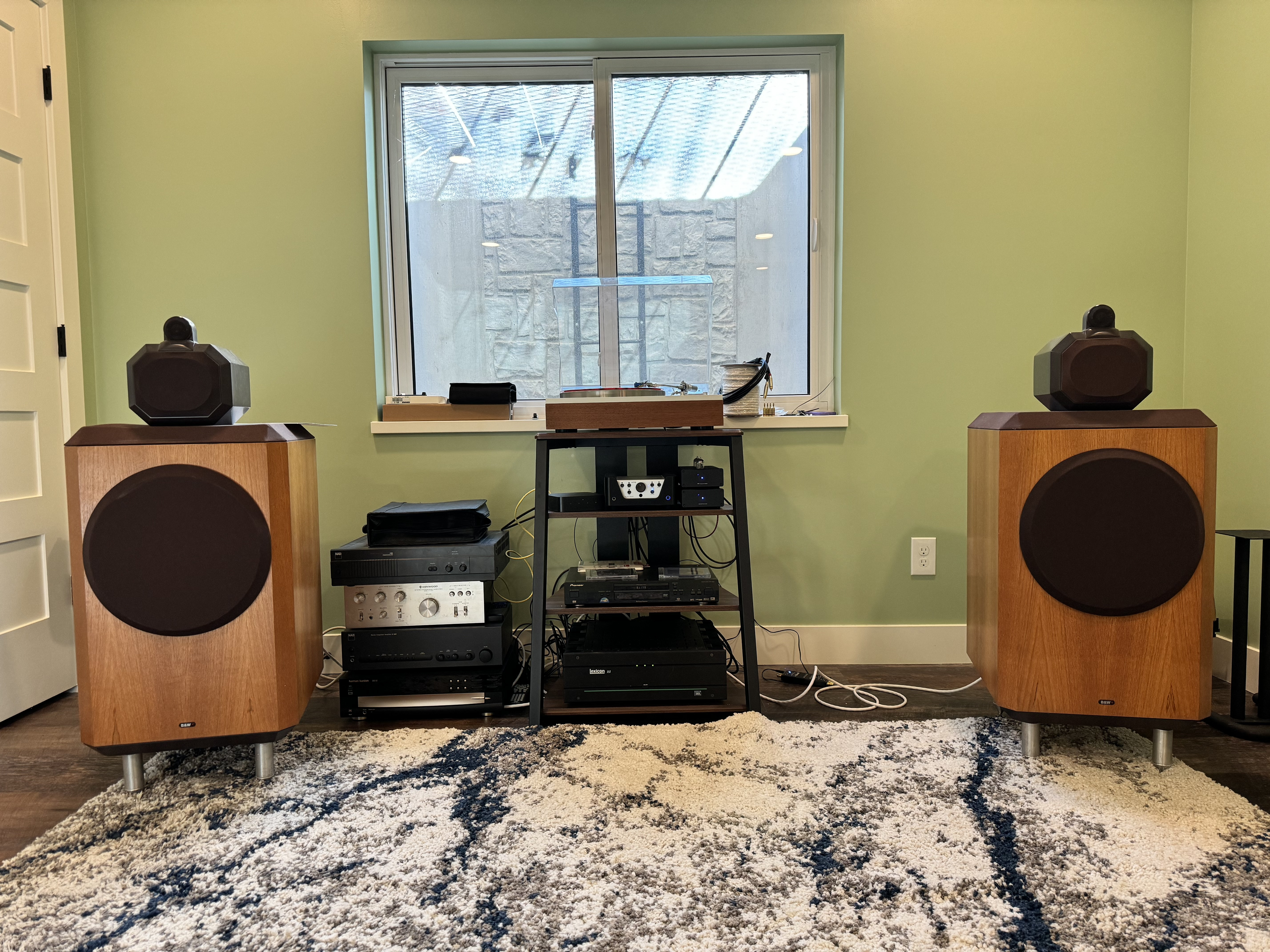

        61) She's alive! Works great, time to hook up the second speaker to compare!
        62) One on the right is the rebuilt one. At first blush the bass is certainly better. The mid and highs are different, not sure if I'd say better. I think the crossover needs some break in time too. Definitely sounds like a new speaker
