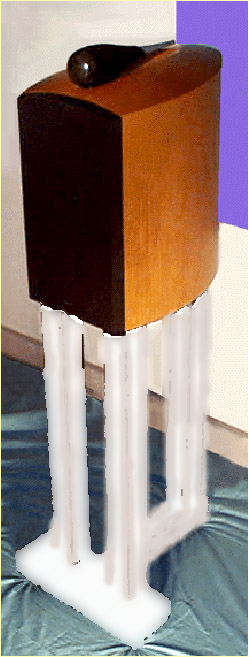

        Greggz its obvoius u are biased towards the b&w stands.
        I personally think b&w default stands are extremely uninteresting and very plain in their look, absolutely nothing special about them.
        U can get the soundanchors with custum colour for 50$ more, imagine the soundanchors 805 stands, in ebony white, they say it goes very well together with oak. (Rainmaker Totem speakers have default white stands that are supremely beautiful).
        I´d bet u would get more money for the soundanchors nautilus spekaer combo then the default b&w, that argument sounds to me like a very stupid sales guy argument.
        In the end the sound and looks are important, not what u will get whenever u descide to sell them, although i dare say i think the soundanchors are better more non resonant and rigid stands and sonically letting the speaker show of even more , then with the default b&w´s.
        I have never seen a soundanchor nautilus on second hand sale, but i have seen plenty b&w 805 default stands on ebay and various online used gear´for sale places.
        Perhaps thats why u are all worrying about wich one gives the best price when being sold used? I guess the soundanchors are priceless then like the monalisa?,..since they are not to be found used
