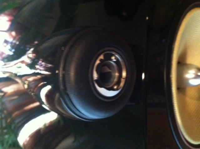

    well I finally went and picked up my 804's unboxed them and set them in their spot's, went to turn on my gear and what do I see, one of my diamond tweeters is smashed." WTF" but it gets better the dealer is no longer selling b&w and the ass clown that boxed them up claims he knows he didn't do it."WTF" all I know is somebody better produce the new 1300.00 tweeter and I know I ain't paying for it.
    I will say they still sound good even with the open hole but obviously I am missing a lot
    wish me luck on this one, I swear i'm cursed

              Well the new tweeter has arrived courtesy of b&w. does anyone know how to replace the tweeter on this bad boy. I cant find any info on replacing it. I'm not sure if they sent the entire assembly or just the tweeter but either way cant see how it comes off.
              • windshear
                • 243
                Its a fairly simple yet delicate process.I would imagine its the same as for a 800/801/802. On the tweeter tube at the back is an aluminium tube. This is the fastening screw that tightens the tweeter assembly to the case. Loosen it, as it unscrews apply a bit of forward pressure on the tube to allow the tweeter to protrude from the front of the cavity. This allows you to then grip the tweeter. Gently pull the tweeter forward once it is unscrewed. It might feel quite tight depending on how much slack there is on the two attached cables. They might have a cable tie over the assembly which you can slide back. The two connectors will be quite tight on the terminals, so you may need a pair of needle nose pliers to gently pry the connectors off. I cant remember if they have a locking tab on the connectors, have a close look if they don't release. Work slowly and patiently so you don't slip and create any secondary damage. The wires are colour coded and I think the one terminal on the tweeter has a red colour mark to associate the relevant connector. Additionally the connectors are size specific to their own terminals so you wont make a mistake and incorrectly connect the positive or negative terminals. Reverse the process when re-assemblying. The only thing im not sure on is how tight to make the screw. All I can say is don't over tighten it.

                  YOU ARE THE MAN. The new tweeter is in and you are correct with every step.The only hassle was getting the wires back on the terminals what a bitch.I managed to get it in without scratching or chipping the finish. Now I can sit back and enjoy.
