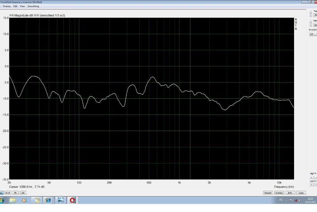

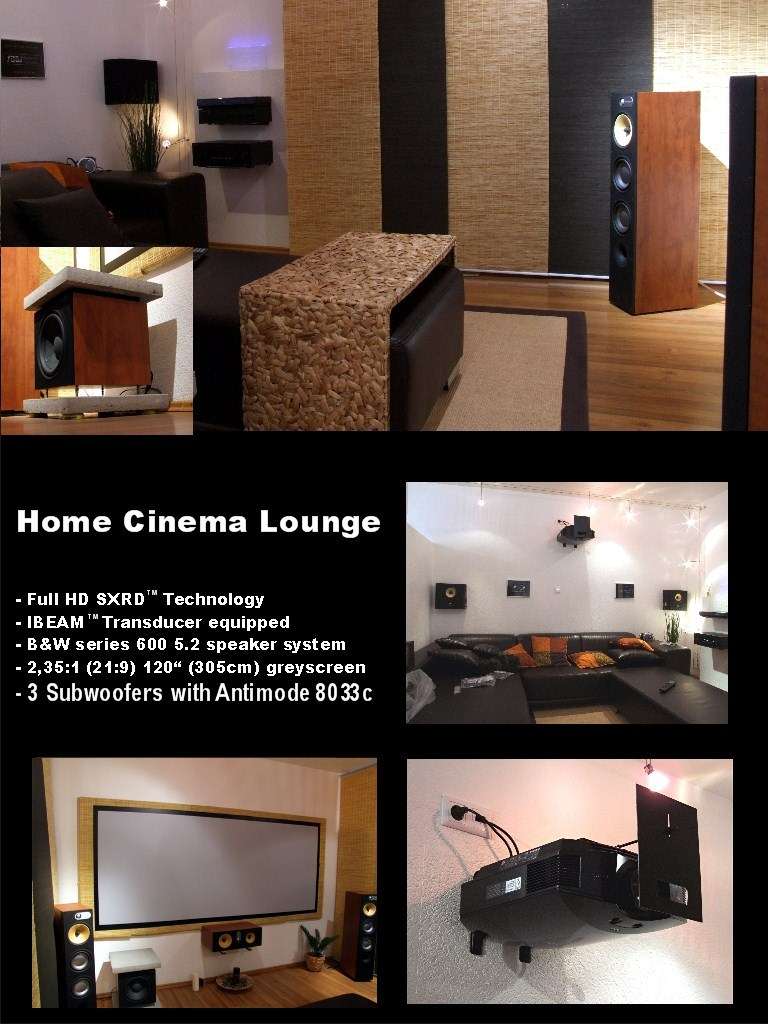

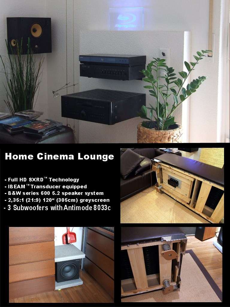

              This is my setup:
              Just look at the 2 cinema lounge pics
              My 683's are very valuable for their price but are way to "overbassed", so I cut them at 100 Hz using 3 subs (and a antimode 8033c, of course) which lead me to the following graph (with my ROTEL RSX 1550):

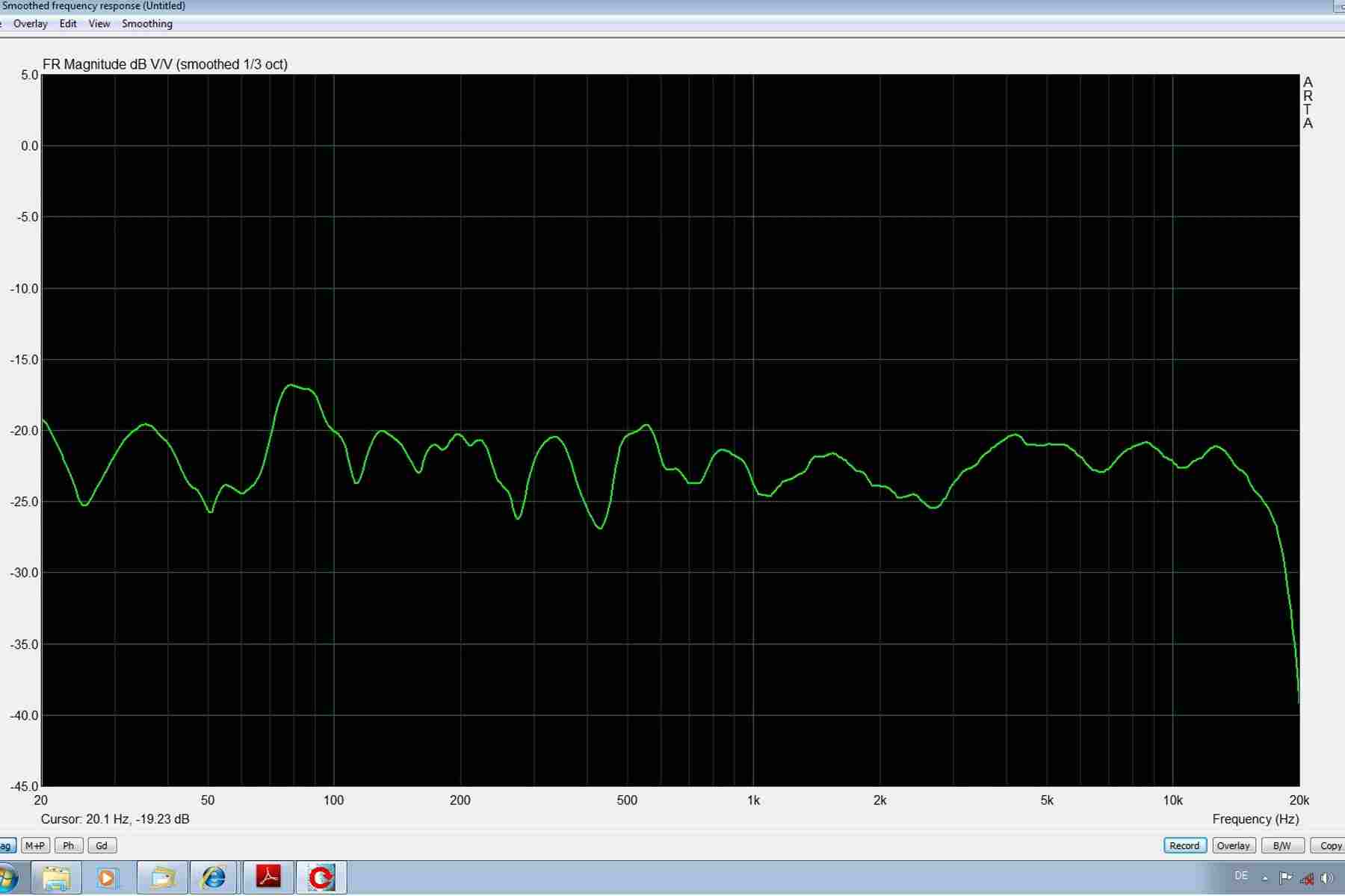

              Frequenzverlauf Helmling neu
              Funny thing is, I borrowed a Marantz SR 7005 recently and used the parametric EQ to the following extend:
              Frequenzverlauf Helmling mit Marantz
              But! despite the better frequency response the Marantz didn't sound as good as the ROTEL! So I learned the fact that frequency response isn't all about sound there are much more parameters that influence a good amplifier!

                Originally posted by beden1
                The OP is obviously single
                Just because a guy has a couple of whips mounted above his fireplace it doesn't mean he's single. Well maybe it does...
