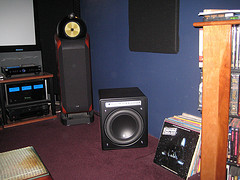

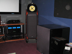

                                        • cossie0
                                          • 36
                                          Here is the pic thanks for the tip. Obviously the centre is wrong and will be replaced with a HTM2.

                                              Very nice! Looks like a great cinema

                                                Very nice setup. It will really be nice once the HTM2D is in place.
                                                Also, any chance to bring the 802D's forward and a bit out from the wall? I'm thinking this will lessen the impact those columns will have on the sound.
                                                What sub is that?

                                                  They can be brought forward a bit but it would get to the point where the width between them is wider than the distance from the front listening position.
                                                  They were only in the room for a couple of hours so we did not have much chance to experiment. They can be optimised when the permanant pair arrive. The front seats can be moved back slightly but not too much as the stage is in the way for the rear seating.
                                                  The sub is a Velodyne HGS18 but may be replaced with a Paradigm Sub 2 or 2xSub 1's

                                                    Good to hear there is some ability for placement flexibility. As best as you can, try to form an equal triangle between the mains and the listening position.
                                                    As to the sub. The HGS18 reminded me of my old Velodyne DD18. I replaced it with a JL Audio Fathom F112. It was almost 1/2 the size and it performed better than the DD18.
                                                    The Sub 2 certainly looks quite impressive.
                                                    You might consider one, or a pair, of the JL Audio's for that room (F112's or F113's). There is also the F212, similar in concept to the Sub 2. I've attached pics for comparison (DD18 vs. the F112). The pictures are small, but illustrate the size difference.
                                                    The smaller footprint might come in very handy in a room like that.
