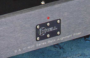

    Looking for the bass alignment filter for B & W Bowers and Wilkins 800 Series speakers.
    Considering the Krell, JPS Golden Flute, anodyne, KBX Krell, or Northcreek (801/802) bass alignment filter.

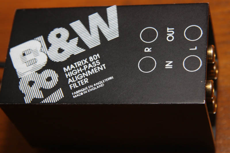

        B&W 801, Series 2 Bass Alignment Filter
        The Bass Alignment Filter I was referring to is for a pair of Vintage Matrix 801 Series 2.
        The following is the description found in the Instruction Manual:
        B&W bass alignment filter.... "This external filter gives the possibility of extending response down to 19hz (-3db point) with a sixth order Butterworth alignment, and also filtering out sub-sonic frequencies which may give rise to excessive cone excursion and intermodulation distortion"
        One channel of my original filter RCA connections is not making full contact. I have to jostle the connection for it to make full contact. 90% of the time if works fine, but the 10% is the reason I need a replacement. I'll look into possibly re-soldering new
        RCA connections if I do not find another filter.
        Sorry for not being more specific. I realize there are a lot of new 801 models since the Series 2.
        Gilbert

            Gilbert, the "BAF" will not help you with the RCA problem, You'll need to resolder. (The BAF is installed somewhere else in the chain, i can send you a manual to describe if you like)
