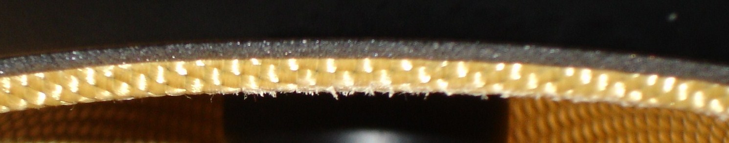

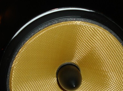

    Hi guys, as you know i just bought a pair of pre-owned N800 and I'm starting to find some problems with them.
    It seems the on one of the speakers the rubber seal surrounding the FST drive is tucked under the FST drive at a certain area, thus exposing a white surface that comes behind the rubber.
    I'm not sure why this happened but I doubt that this was a manufacuring problem. I'm suspecting that the FST driver has been perhaps tampered with or repaired. The driver was probably remove and on assembly, not much care was taken to position the rubber correctly. I noticed some minor scraches on the tension screw in the back that might indicate this.
    Reading through some other threads in the forum, I cam to know that this may have an effect on the sound, because the marlan enclosure may not be completely sealed and thus air may escape and affect the sound.
    I have to say, I have noticed some difference in the sound coming from the speakers. It seems that the mid band on the good speaker is slightly stronger when compared to the damaged one! All the details are there, but they are very subtly more prominant on the good one, causing some very slight scewing of the midrange towards the good speakers (Am I imaging this?! haha).
    Any way, I need help guys. How can I fix this?
    Should I try to pick it out with a small grabing tool?
    Is there a way to loosen the driver, align the rubber and tighten it back on. This seems to be difficult due to the complex marlan enclosure.
    Any help would be highly appreciated.

    I'm attaching some pictures, so that you guys can get an idea.

          Could it be that the speaker slipped down a bit during transport? I can't see the bottom of the speaker, but does it look like it's lower than it should be? It may be that you just need to realign it. Someone may know what happens when you loosen the back screw, and whether this enables you to realign the speaker. It doesn't look damaged from the picture.

                You can just unscrew the phase plug and insert a piece of all-thread the same size of the phase plug, which I believe is 8mm.
                Then loosen the back screw until the driver is loose, using the all thread to hold the speaker, re-adjust the gasket and push the driver back in place, then just re-tighten the screw until it is snug.

                  FWIW, B&W's engineer told me to tighten the screw on the back until all play is taken up, then one full turn tighter (pretty much like tightenig an oil filter).
                    Hi benden, I dont't think that the speaker slipped during transport. I can see from the pictures I posted that the driver looks lower than it should, but its not. It only the rubber part is traped under the FST at that location, as if someone didn't align the rubber properly on assembly.

                          Here is what B&W's engineer told me. Tighten the screw until all of the slack is taken up and it is snug by hand. i.e. finger tight. Then tighten it one more full turn with a screwdriver.

                              Here is what I would do in the following sequence.
                              1) Call B&W parts or tech.
                              2) find out how much a new rubber seal, rear locking screw with any additional rubber washers are and order them.
                              3)As RobP said get a long piece of thread about 1 1/2 foot long or go to a dealer that has one specifically for your speaker. I have a whole kit with all the required tools to fix anything on my 800D's.
                              4)place your fingers on the outer metal ring just below the rubber washer of the speaker if you can't get a threaded piece and press inward to releave the pressure on the screw in back of the speaker. The speaker is connected to that screw by a long metal rod. So by pushing on the speaker infront you releave the pressure in the back on the screw. Start turning the screw and count approx. how many full turns it takes to remove the screw. Since your driver is loose you will get a close approximation.
                              You may need help if you are not long enough to push on the speaker in front with one hand and unscrew the screw in back with the other hand. The advantage of doing it yourself you can feel the tension and not have to rely on someone else's discription if it is tight. It's like giving your your 800 a hug that's the position your in.
                              5)It may seem easy to hold the speaker in place, untighten the screw in back and remove the speaker from the head, but remember, when you pull the speaker out the rod that attaches to the srew comes with it. There is acoustic material in the head that the rod is surrouded by. Be carefull to pull the rod out slowly so that you can return the rod through the same hole in the material to the back of the speaker when you replace the new rubber gasket.
                              When you are ready to place the newly gasketed speaker back in the head, make sure you seat the speaker correctly and evenly all around in the head and have someone start to tighten the screw in back. do not let the speaker slip out while tightening. You will know on the amount of turns required to tighen your speaker once the new rubber gasket is replaced by the tension of the speaker in relation to the screw in back, there shound be no play in front.
                              Follow what some of the guys have told you. Once you feel the tension, start with 1/4 turns and see if the speaker is moving in the head by applying pressure to the outer metal ring by hand or with the rod, by hand is better.
                              One last thought, you may want to ask B&W tech if any adhesive is required on that gasket and get it from them. And rememebr which wire goes where on the speaker when you remove it.
                              Hope this helps.

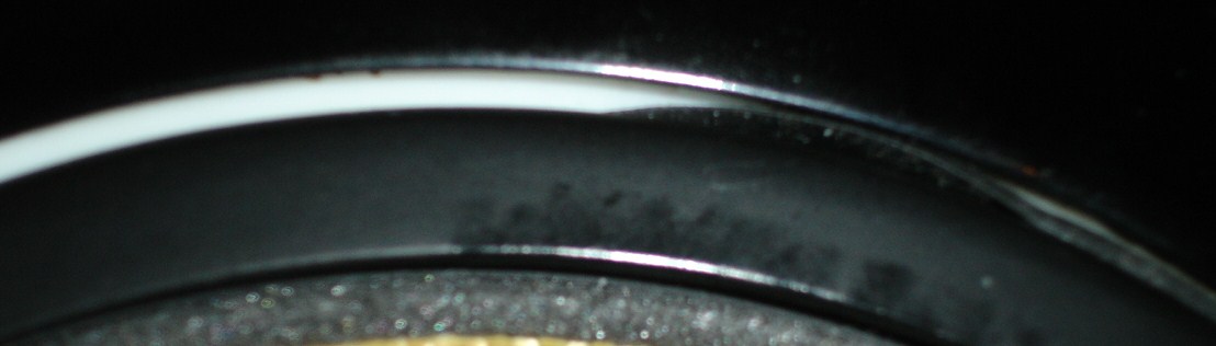

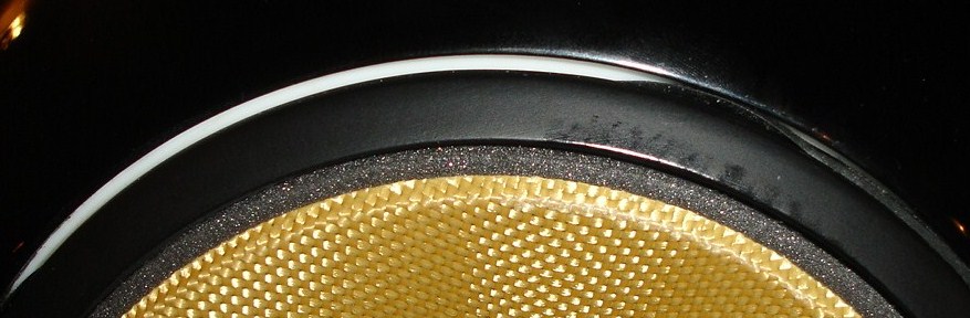

                                            Guys, just noticed some imprefections in the FST driver as well, next to where the rubber problem is. I'm attaching a picture. It seems like a very minor issue with the kevlar fabric, right on the outer surround (look closely at the picture, right where the phase plug is and you will see what I mean). I'm guessing that this will not effect the sound, and I should not replace the whole driver? what do you guys think?

                                              I would talk to B&W. Send them the pictures and your concerns. In my experience, they have been good to work with.
                                                  I would still call B&W tech, I may wrong, but this looks very, very minor. I believe that the foam surround is the real important part.
                                                    I think that I can live with this minor imprefection for a few years cause I dont think that it will affect the sound
