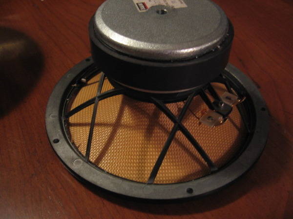

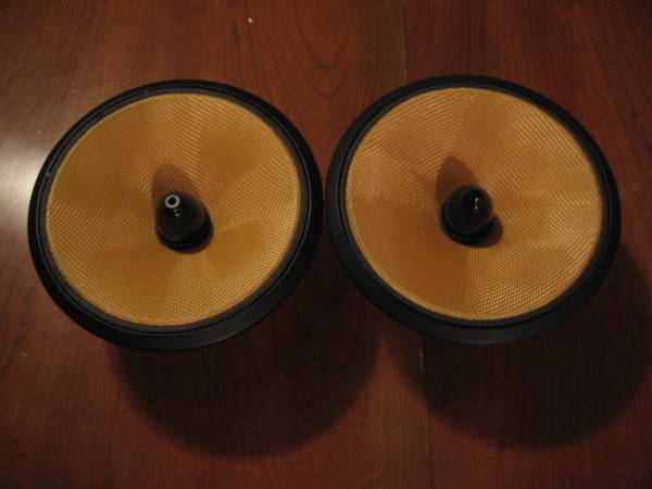

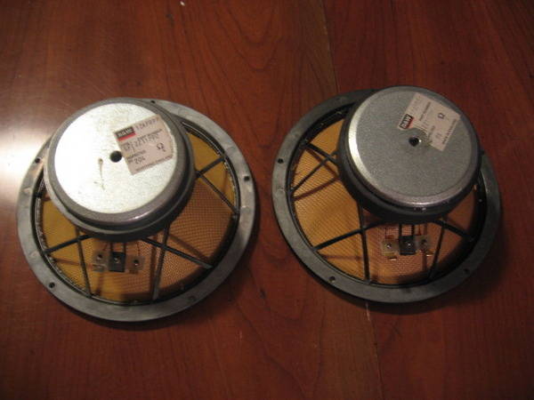

    I have take apart just about everything on my N802s, HTM2d, and even some of my past B&Ws.
    If there is anything you want me to measure, I galdly will. They are just speakers, held together by just nuts and bolts
    Inside the 855
    http://htguide.com/forum/showthread.php4?t=29490
    Some pics of the N802s. I have more of this I could add.
    http://htguide.com/forum/showthread.php4?t=25547
