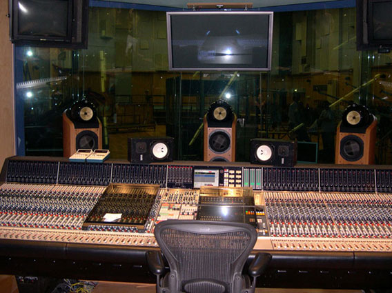

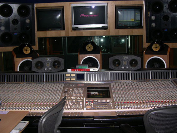

                                    • 1930
                                    Not to change the subject, but it's very interesting what Jerry and others have mentioned about the new 803 vs 802. In the previous Nautilus series, it was a big jump from the 803s to 802s. Yet with the new 800 series, B&W seems to have closed the gap a lot. Either by greatly improving the 803s or lacking with the 802s. I have not heard the new 802+, so I wouldn't know. But it sounds that way just from what others have mentioned.

                                            • 1930
                                            Originally posted by JKalman
                                            Oh, BTW, wouldn't it stand to reason that since we have two ears, even with a center channel, we would still have this fatigue occuring? The brain will still have to process the sound the same way, i.e. it will still have to construct a cohesive whole from two inputs (your left and right ear inputs), or is there some kind of proof that a center channel bypasses normal processing of sound signals by the brain?
                                            No, because even though we have two ears, we are still able to determine sound in all depths around us. We don't have only two directions of hearing. That's like saying we have two eyes, but we can only see in one direction. There are no speakers in our everyday environment, yet we can hear things from all directions, right? If you walk down the street, do your ears get tired of working?? I believe that is the main goal of surround sound. To make the movies have a life-like surrounding soundstage.

                                                                    Here's a mixing studio image. What do we see ?? They mix the sound like this and this is not "imaging" but center channel INFO. My advice to those without a center channel is to set up one of your surrounds in the center for a couple of weeks or borrow a trial speaker.

                                                                      I have lived with and without the center channel and there is no question in my mind that the center channel is THE most important speaker. My advice to those without a center channel is to set up one of your surrounds in the center for a couple of weeks or borrow a trial speaker.
