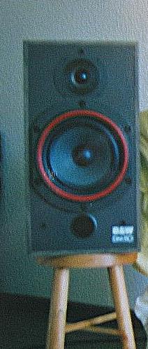

    In the late eighties a best friend and myself both acquired our first B&W speakers.
    DM110i.
    Mine are still used today for rear duties. (not coping so well)
    My friend, on a very tight budget still uses his in a stereo system, which he still loves.
    One of his tweeters blew/broke (does not work).
    As there are no spare parts, what does one do ?

    This is a tough call. One which I can't answer. Just to say that my first set of Bee an Dubbs were the DM110i's too (in the pic taken in 1987). Great speakers they were & I still miss them. (Yup, I turfed them out some years ago - and now I wish I had kept them - could've used them for another room).
    And idea: Get hold of Paul at Sound & Cinema in Cavendish ... He might know of someone who could re-wire/fix the tweet.

          I have an old pair of DM110s that suffered a tweeter failure about 6 years ago. A local speaker repair shop was able to scavenge some parts and replace the ferrous fluid that had leaked from the tweeter. All in all, the repair cost me about $20 and the speaker has worked flawlessly since.
          So, see if you have a local repair dude who is up to the challenge. You might be surprised.

                Any reconing service can put new surrounds on the woofers.
                The tweeter, well it depends on what's wrong. If the VC is burned out then it's time for a new dome assembly, if those are available. If not get someone to measure the T/S parameters of one of the good tweeters. Then look around for a replacement unit that has similar T/S parameters (try Vifa and Seas). That way you don't need to redesign and rebuilt the crossovers.
