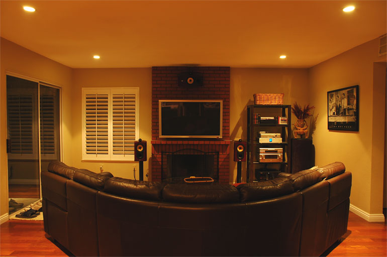

            j,
            My room is a similar setup. Family room where my N805's are, is about 12x18 and it opens to a kitchen which is about 12x16.
            To be quite honest I find the 805's too small for the room. I do have a good sub - so it is not really a problem with bass. It is really more of...not enough mids - I guess.
            Anyway I don't know if the above made sense but at very LOUD listening levels I am dissapointed with 2 ch with the N805 for my room. I have noticed myself switching it to multi channel stereo as I have a HTM2 that helps this situation. At moderate listening levels (or at least what I consider moderate) the N805 does a good job. And of course N805 and HTM2 have no problems with HT and I have enjoyed them more for this.
            Anyway, if you are still thinking of downsizing do you want to trade? As long as you have the 804's in red cherry.
            tec

              HI tec,
              From the picture it looks like you have a beautiful room. But I see a problem. I don't see any acoustic treatment at all except for the couch. Just looking at it, I think it must be very bright and loaded with early reflections. I don't understand how you can really get good sound in these conditions with any speaker.
              You have already spent a lot of money on your equipment. Why not invest some in tasteful room treatment then decide if you are dissatisfied?
              Sparky
              • tec333
                • 42
                It's really a difficult room. What you do not see is right behind that room is the kitchen area and to the left wall is about 20 feet of bay windows. You are right, there are no acoustic treatments in the room besides the couch. (Actually, there is a thick shaggy rug in front of that couch but that is about it). There really is no place to put any acoustic panels/treatments. I have no idea on what to do, I have seen some nice panels and can talk my wife into putting them up in this room. The problem is - there is nowhere to place them.
