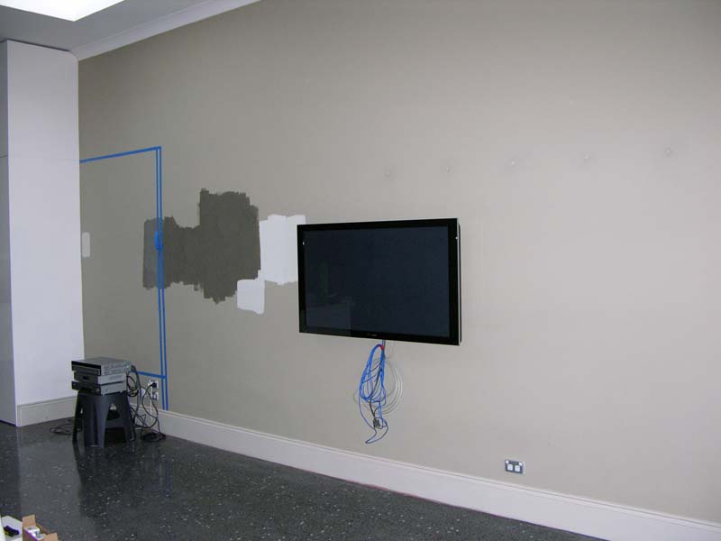

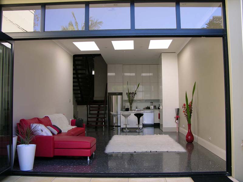

        Hi all,
        Do i really need such a big sub? Even from an aesthetic point of view such a big sub sounds (no pun intended) like a nightmare.
        The room is our living and kitchen combined. I have attached a pic of the room in hope that your opinions might change in respect to the size sub I will need.
        Cheers,
        Julie

          Wow, that's a beautiful place lol...
          Yea, I'd personally go with 2x ASW675s, they each do 500Wrms

            HI,
            Sorry for the bad news but the answer is: yes you do. Almost everybody buys subs that are too small. You are being influenced by unwise decisions usually based upon cost issues. Oh, you can get by with smaller subs. They will work. They will produce bass. But not well. Especially when the going gets tough.
            Question: Have you ever heard really good bass? In other words, do you have a reference for your expectations? Go to a church organ concert where the pipe organ has 32 foot pipes. Make it a point to do this. These will produce 16 Hz fundamental notes. They will seem to swell and fill the space with unheard but felt pulsating energy. That's what bass is all about. Most listening rooms are too small to reproduce the experience but yours is big enough, I think, to yield a reasonable bass experience.
            Maybe you should modify your question by asking for subs that will give mediocre performance. It that case, yes, you can go smaller. Which do you want? Great or not so great performance? Your room will definitely handle the larger units. Again, are your priorities audio first or the beauty of the room first? You must give us that information.
            Also, the volume of the room is the critical number not the area. You did not indicate the ceiling height so the volume cannot be calculated. It is obvious that your room size is capable of great bass. I hope you go for it.

              Julie,
              To me the amount of base you "need" and the amount most people want are very different. For me I have a room that is the same size maybe even slightly bigger then yours and I have the PV1 ( as you know from my other posts) and we dont have the sub turn all the way up, not even close.
              I may get some slack from others for this, but to me the way something looks in my house is as important as it sounds. The PV1 would look great in your place! Think of it as a piece of art and buy 2 if you can afford it
              If I were you I would buy the PV1 try it and return it if it didnt work. Subs are the easiest thing in your home theater to change. Ask your dealer if you an borrow one, or even two if he has it.

                  Julie,
                  I dont mean to through a wrench into this, but the more I look at that room the more I think how great B&W FPM 6s or Vienna Accoustics (link below) would look great all the way around.
                  the vienna accustics are wall mounted speakers like the FPMs too and sound just as good.
