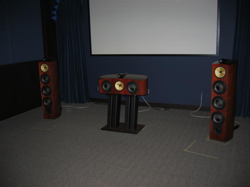

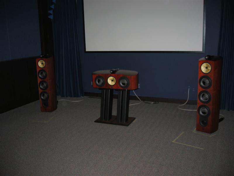

                      How about this? 803D's and HTM2D in rosenut. :T
