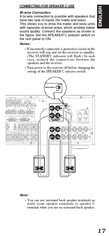

                              Is this bi-wiring, as the manual states, or is it bi-amping since I'd be using the power that would normally be going to the rear channels and it wouldn't be using the same outs on the receiver? Also, does this mean I'm effectively delivering 250wpc to each bi-amped speaker since the receiver is 125wpc or are the calculations done differently? I'm guessing that if this effectively delivers twice the amount of power to each speaker then I run a much better chance of providing adequate power to the 804s.
                              • alkalay
                                • 77
                                Hi Verinnal,
                                You may call it bi-amping as each pair of terminals is fed by a differnet amp.
                                Unfortunately, it would not give a 250W amplification, and personally I think that to do justice with a 800 setup a pre/power is a must.

                                  Hi ,I just purchased a SR7500 and it has the same bi amping feature which I am experimenting with on my B&W602s3s.As the standard 105 watts a channel is probabley ample in my small room and my speakers are not broken in yet I have not been able to hear a great deal of difference.I am suspect that actual power figures available with 7 chanels running (5.1 plus 2 channels biamping) would actually be approx 75-80 watts .I recently compared specs on the Denon 2805 (100w ch x 7) vs marantz sr7500 (105 x 7) and noted the Denons pulls a max of 290 w out of the socket and the Marantz 600w !
