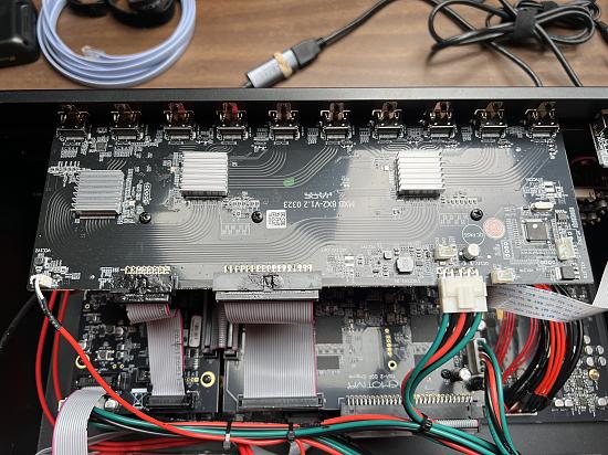

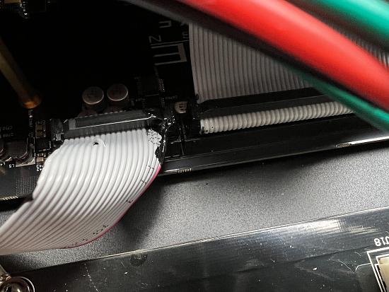

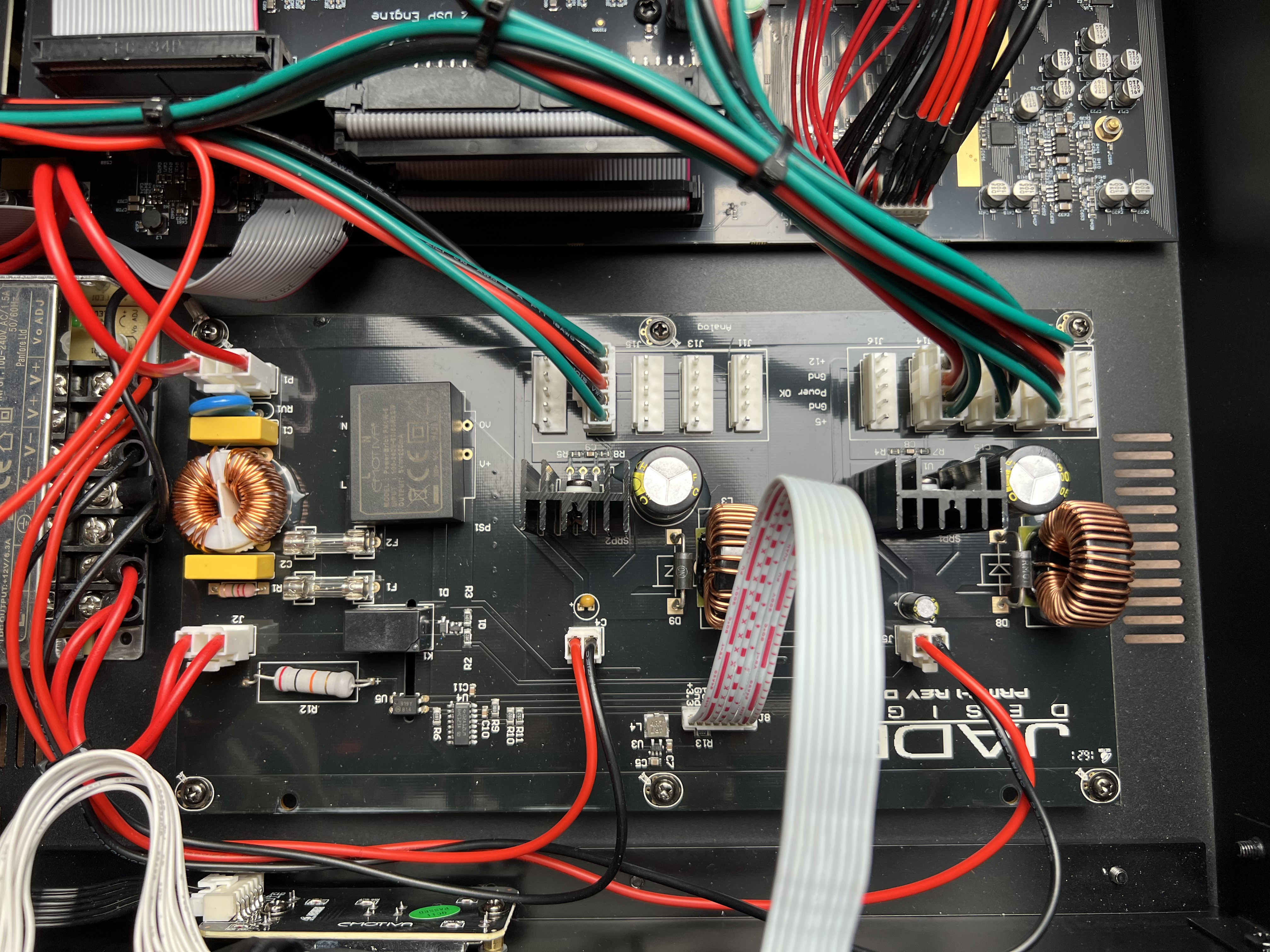

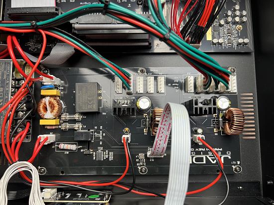

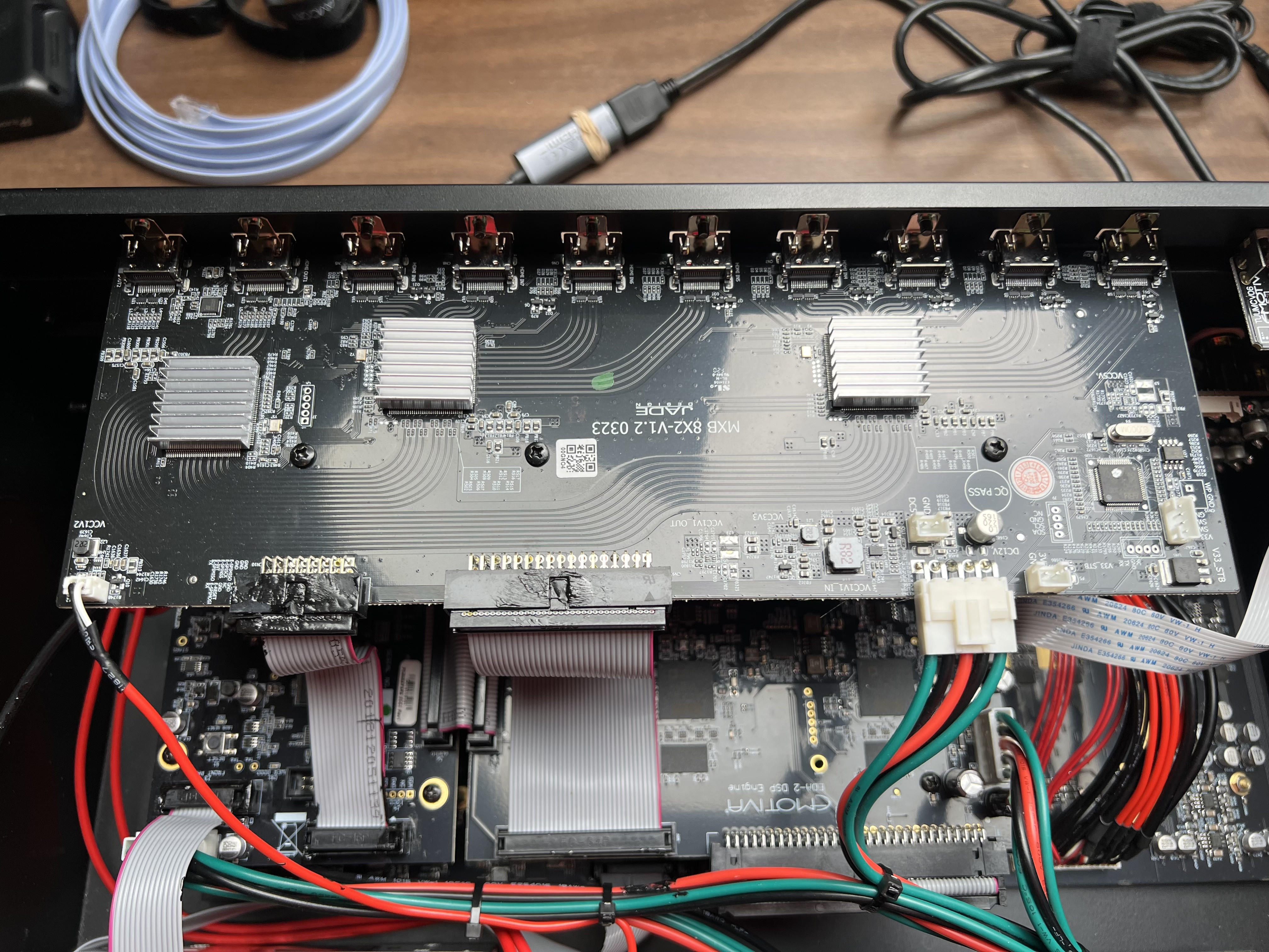

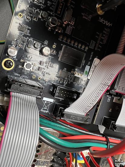

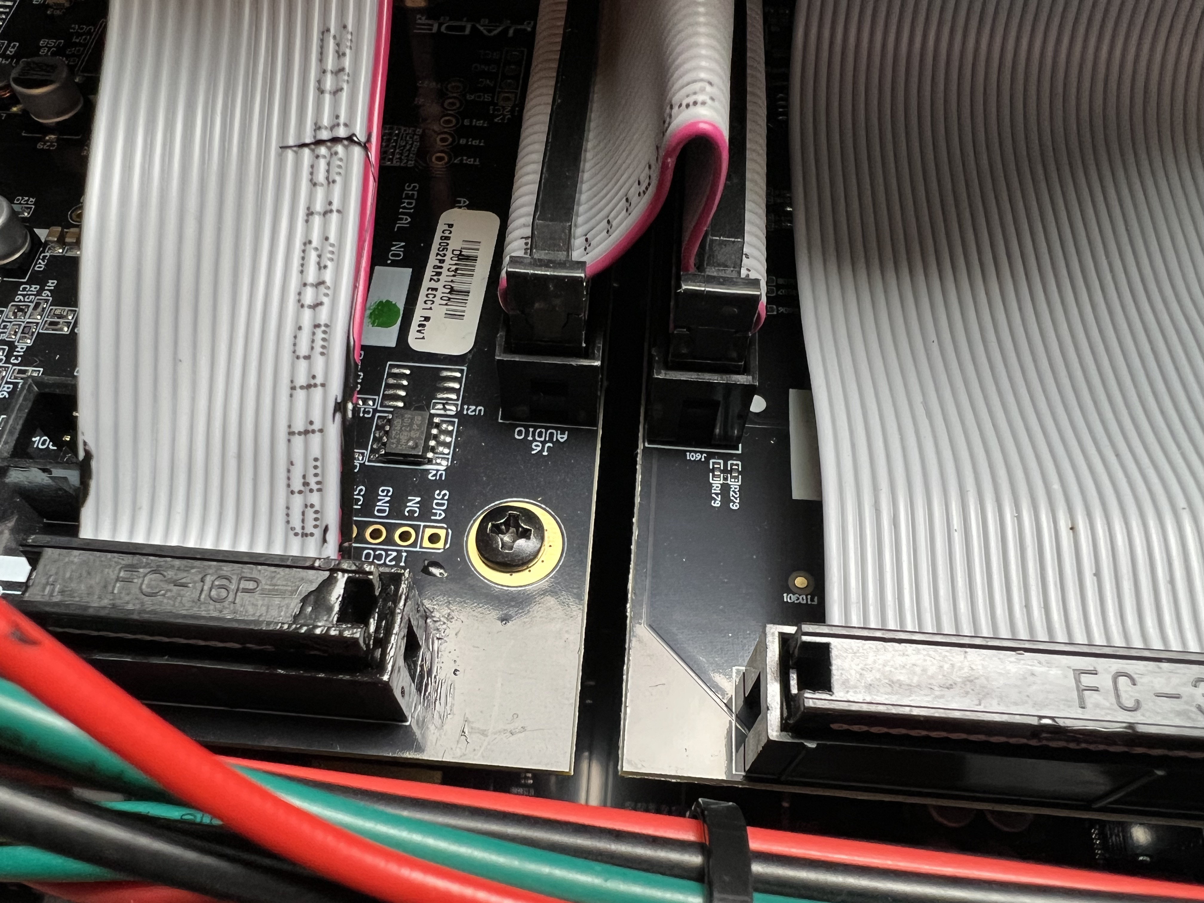

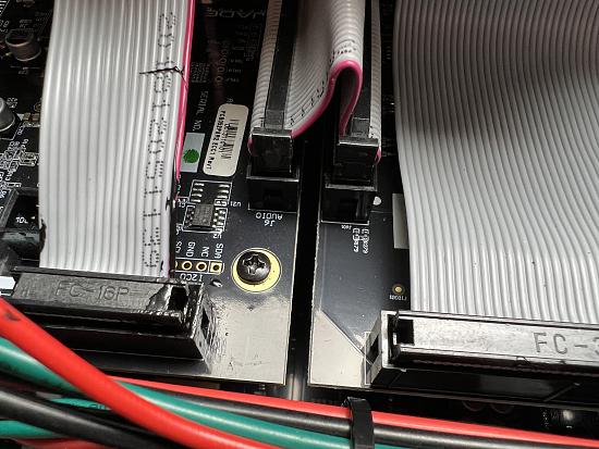

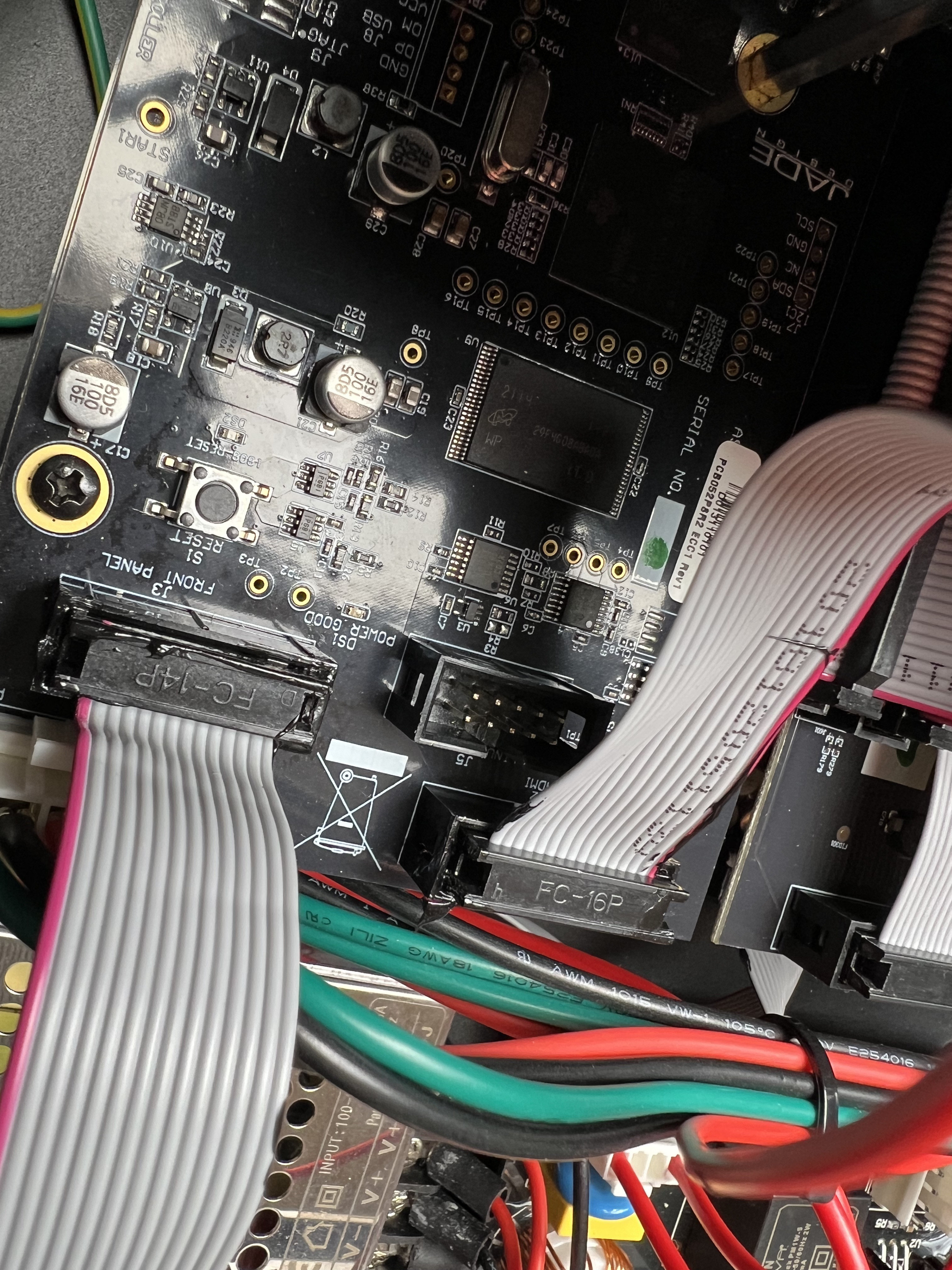

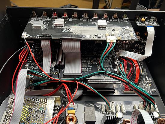

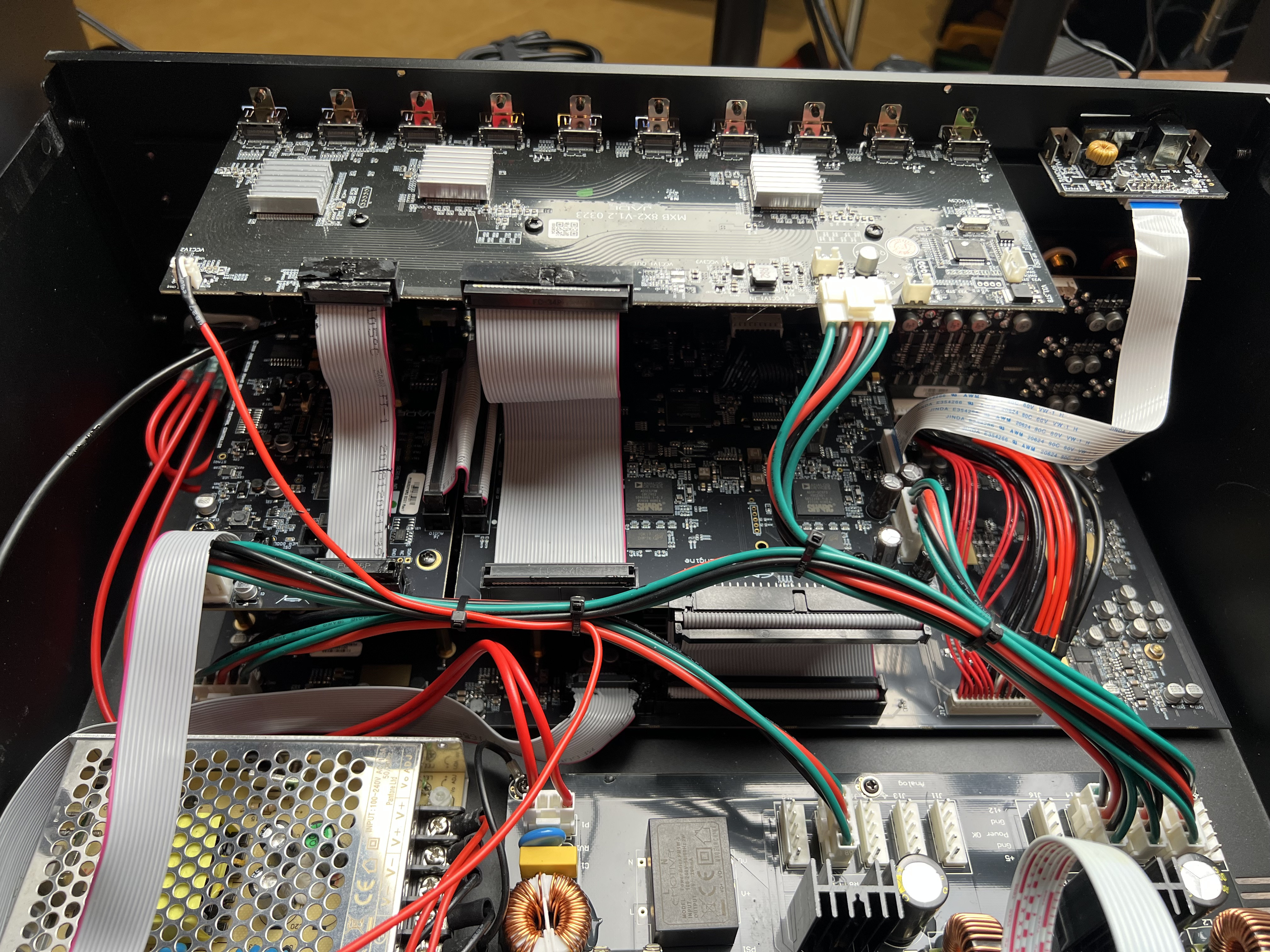

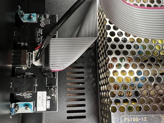

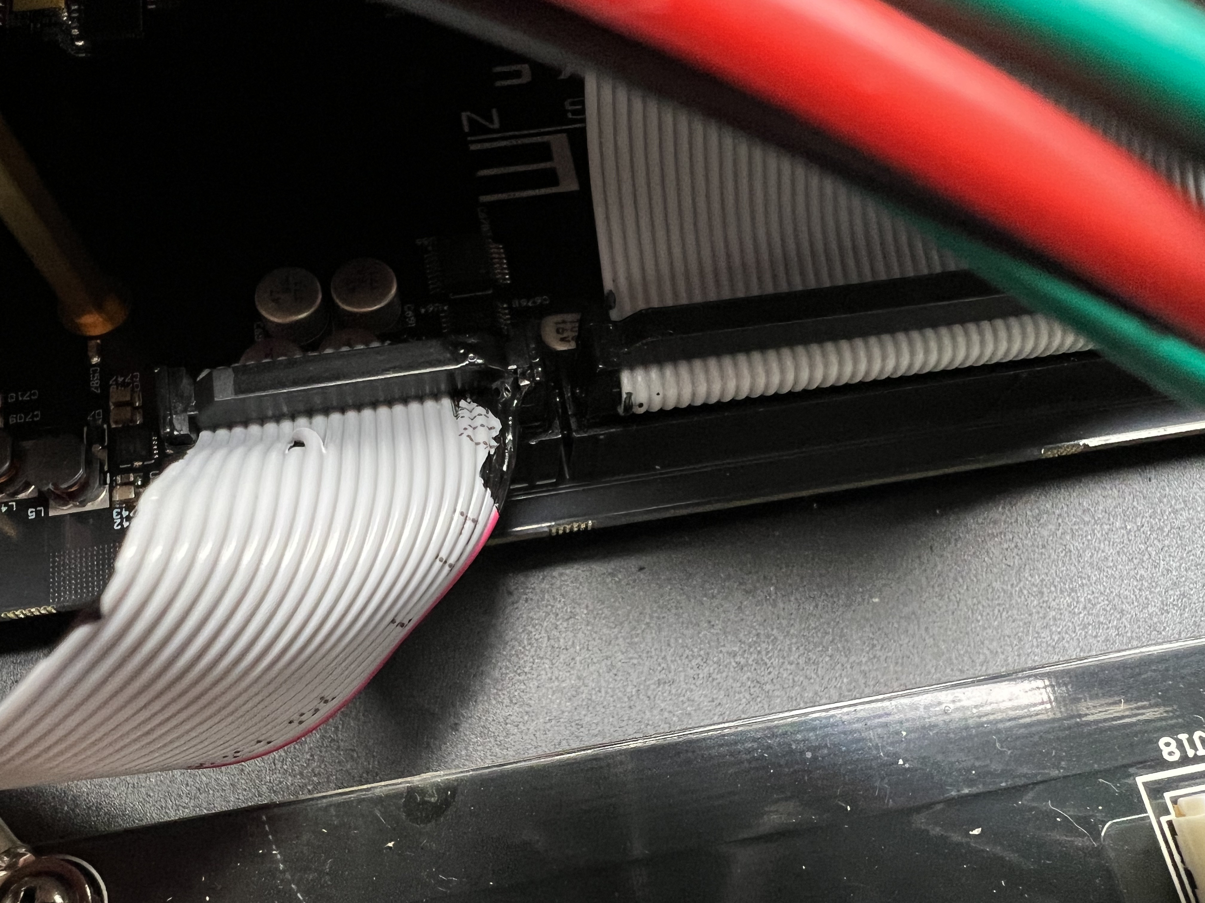

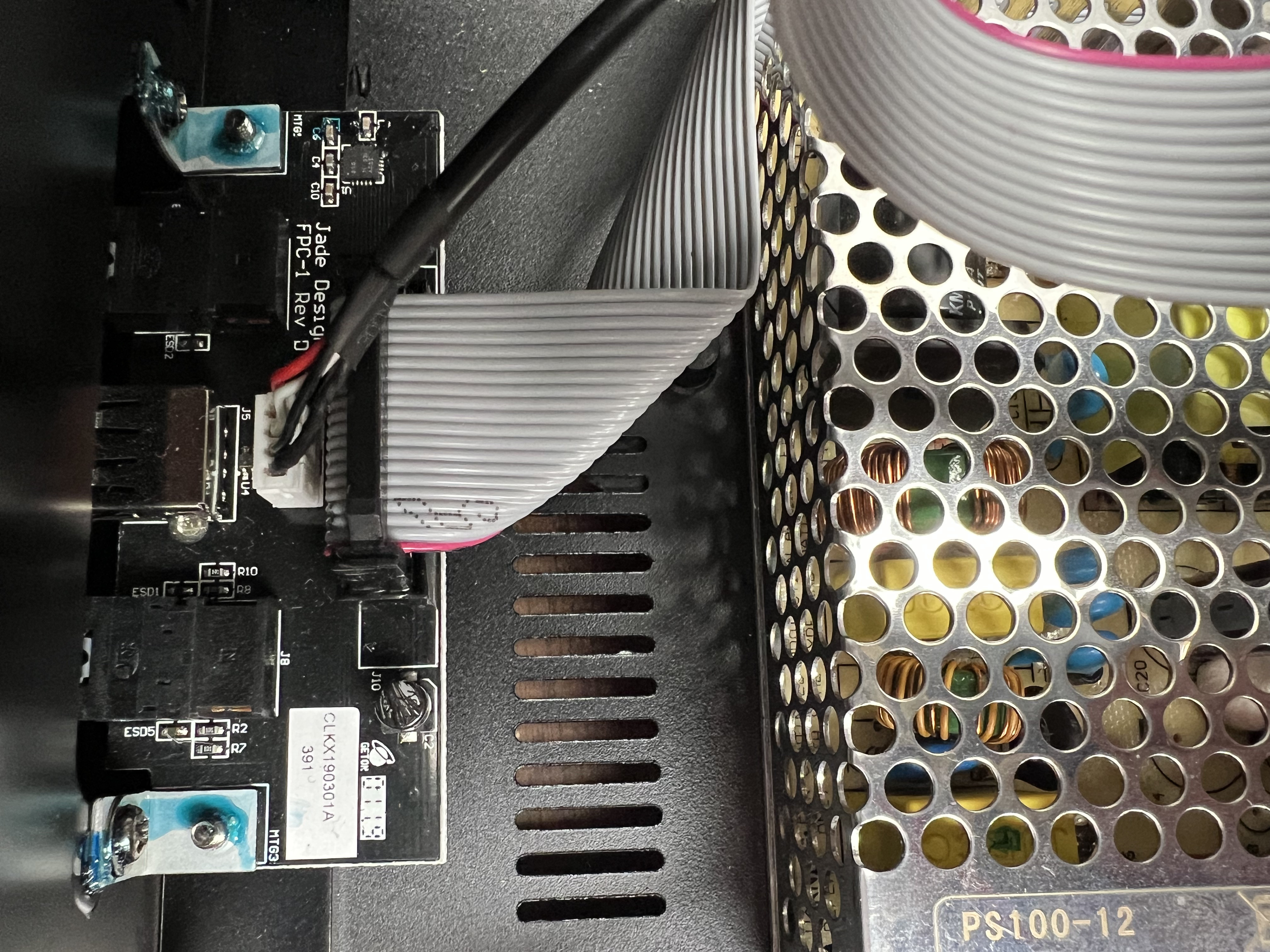

    I've had issue with my Emotiva RMC-1, and I've even sent the unit in to Emotiva for service. I was out of town for work travel for 2 weeks, and upon returning I wanted to watch a movie and spend some time in my theater. I go to turn on the Emotiva and it doesn't boot. I get the typical error ARMC-1 error or something like that. I try the usual, unplug for a couple of minutes, power on again. No luck. I unplug all of the cables and pull the Emotiva from the shelf and begin to remove the lid. Emotiva support had informed me that I need to unseat a ribbon cable between two boards and then re-seat for the unit to work properly. This time when I went to do that, I noticed that the some of the ribbon cable connectors had melted!!! I've not done anything crazy with the unit. I power it on to watch Blu-ray or stream content through an nVidia nShield. Nothing wild... My frustration was at a peak now, the RMC was out of support and Emotiva doesn't sell that item anymore. They do have a newer version coming out I found out after checking the website. It's time to find a new processor that will hopefully 1; work, and 2; be reliable. I don't think that is too much to ask, do you?
    Below are some photos of the melted connectors

    I did get the unit to boot again! I had to unplug the power connector to top board and the board on the lower left of the last image. The unit needed to sit for about an hour with the power cables unplugged. Upon plugging the connectors back in the unit did boot. I don't want to even attempt to use it though with the ribbon connector cables melted. Literally a meltdown...

    Those grey ribbon cables are horrible things. You have to get the ribbon lined up perfectly when the connectors get crimped, otherwise the wires all get shorted together. Not likely to be the problem with your unit, but it's a very common problem with those cables.

      As I mentioned to you directly, Sven, this reminds me so much of the issues with some of the newer higher power GPU boards and melting power connectors (also pin block) due to the current demands running full steam on a demanding game.
      It's a lot harder to fathom in the case of a preamp control unit...

        The unit has been very unstable for the last 2 or 3 years. I had sent it in and it was working, but started acting up again. Every couple of months the unit would not boot and I had to pull the processor out, take the lid off, and re-seat the ribbon cable. Then within the last year I needed to unplug the power from the boards and let it sit for an hour. Put it back together, plug all the connectors back in, and then it was usable. This time though there was a meltdown. I did nothing different, and my guess is that something has worn out on one of the boards that let too much current flow. The unit is on a shelf with good ventilation, the cabinet has the back cut out that allows for good airflow.
