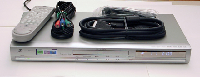

    Well, this little guy is pretty cute. :T Nice display, the remote works well, and it comes with a passle of cables, though I think I'd go with something a little more upscale; still, the component and DVI cable look like they'd get you off the ground initially without having to go out and spend something.
    May not have time to get it setup and watch something tonight; the real "acid" test will be checking level calibration and seeing how it doesn on the test patterns in AVIA, especially the high frequency burst patterns when scaling to 1080i.
    More on this soon.

            Did a little testing and watching last night...
            I did muster up the energy to get it hooked up to my large screen presentation monitor (NEC CRT 1280X1024 capable, multi-scan). I did some quick checks with Avia to verify brightness/contrast settings and resolution, and then checked some lengthy segments of a few favorite movies. Some comparisons were made to a Liteon 2001, another upscaling DVD player which is no longer available.
            Scaling mode is set by push botton on the front panel, while the DVD is in stop mode.
            First, the resolution test patterns looked great- comparable to what I get on the HTPC driving a high-res display, with minimal moire. Unlike the Liteon, there is no apparent edge enhancement, due I think to a bump in the Liteon's HF frequency response. No white crush on the component outputs, but I don't have a display to test the DVI output, which others report has some white crush. This is probably due to the fact that consumer displays use 235 as 100 IRE, while PC's use 255; if LG made the DVB318 with PC levels on DVI (Samsung did, for example, on the 931), then there is a simple explanation for the white crush issue. Because the DVI output is HDCP, you wouldn't be able to run it into a conventional PC display DVI input, I think.
            For viewing fun, I got out a few old standards- Superbit Fifth Element, X2, some more conventional titles (Runaway Bride), and to check for video de-interlacing perfomrance, the first season of Smallville.
            Well, OK, Superbit Fith Element looks great, but then it looks great on everything. For being 1080i interlaced, this sure looks "progressive" to me, inlcuding the angled wooden walkway near the beginning of the movie. I wonder what overall processing algorithms are being used in this unit. It has NO 480i output except S-Video and composite; only progressive and scaled component outputs- don't bother buying this unit if you wanted to run DVD through component on a standard TV.
            X2 looks very good- fine detail, textures, hair, etc, all are resolved quite well - skin on the german mutant was remarkable; more 3 dimensional in resolution of textures. Which brings up a point- there is a three dimensional quality to the image which is notable, aside from resolution, and which I associate with above average color resolution and detail. Color balance and saturation appears to be quite accurate and natural.
            Moving on to Runaway Bride, this is not a "high res" demo movie, which is precisely WHY I chose it as part of the test suite; but it has a wide range of shots, indoor and out, and a broad color palette, including natural skin tones. Reproduction was quite satisfying, with certain scenes revealing higher resolution in fine detail than expected. Again, it exhibits at times a markedly more three dimensional aspect to the image than the Liteon, and is comparable or maybe a skosh better than the latest decoders in NVDVD 3 on the HTPC (not yet released... don't ask )
            I also tried a couple of Mirramax movies who's menu authoring gives the Liteon 2001 player fits, or makes it lock up, and the Zenith DVB318 passed with flying colors.
            I plopped on Smallville because it's video sourced material, and even the latest adaptive de-interlacing algorithms in NVDVD3 show artifacts from time to time, especially on the DVD menus, but also in the program. Here's where the dcdi Faroudja video processing incorporated into the latest Genesis chips must really pay off- this is the best I've seen this DVD by far, and makes me all the more eager in anticipating Season 2 which is to be released in May.
            Note, all source material viewing was done with 1080i output enabled, through component outputs. I guess this answers the question about whether Macrovision DVD's will play on the component outputs on this guy. Unlike the combo HD/DVD player LG makes (Zenith is owned by LG), component outputs appear to work for all DVDs.
            Is this the best $200 DVD player money can buy? Well, only you can answer that question for yourself, but for my viewing preferences and requirements, I think it's a pretty remarkable little box. And as most of you familiar with me may know, I'm not a STB DVD player fan, having been a hard core HTPC guy since 1998. My reference for DVD output quality is a MyHD board with hardsware decoding view the Janus MPEG chip scaling DVD to 1080i. But this little box definitely has a home in my system- it rivals the MyHD solution(which requires removing copy protection for 1080i playback to work) in quality, and does so for less than the price of the MyHD board alone.
            Recommended. Two thumbs and 8 fingers up! :B :T

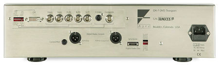

                                                                  At this price range, though, I'd be looking at an Ayre DV-7 DVD transport, which includes such things as an SDI output option, which can feed selected scalers and processors with a direct digital video signal.
                                                                  Which brings me to the last unit I should mention- the i-Scan HD scaler. This is a general purspose scaler, which is in this review because it DOES accept direct digital video thorugh SDI, as well as interlaced component, composite, and S-Video. This unit didn't fail any tests, and overall received their highest recommendation. A freiend who's in this business and genearally doesn't like scalers thinks this is the best one out there, but faults it for the choice of a wall wart switching power supply... injects some 100 kHz HF noise into the system ground at low level. But visible on a really good system (think CRT front projection).

                                                                        The i-Scan HD is a very nice unit, and still undergoing further evolution through it's firmware. If I wasn't getting such as nice picture from my Zenith, I'd probably be thinking about one, and wondering which bank I needed to knock over locally to finance it.
                                                                        Now, if someone else were writing the checks, my "dream system" for video would probably go with an Ayre DX-7 as the main DVD player, paired through the SDI connection to the i-Scan HD.

                                                                        If it was a smaller CRT rig I'd be using, then I would just use the Ayre, as it has 12 bit video DACs running at 8X oversampling, and a great non loop feedback video amp. But, alas, I don't have $4K to shell out right now for that combo. Still, it's nice to dream...
                                                                        ~Jon
