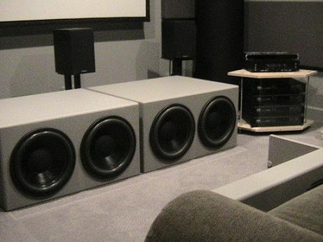

            4 subs? are you sure you're not creating more problems than you're solving?
            • kgveteran
              • 865
              Originally posted by Chris D
              Cool, dude. I use a 7.1 system. Perhaps actually a 7.8 system, as I use two subwoofers and six tactile transducers.
              There are two in each cabinet.Each cabinet has two sub-enclosures that separates them.Since they sit just under the mains, they blend perfect.Driving each Tumult with a bridged QSC 1450 really eliminates any distortion and creates the cleanest bass.Usual listening is at about 85db and I get it flat down to 8hz.It's pretty kickin'. This was all done before i learned about IB.Oh, how things would have changed....like lotz-O-holes in the floor :B

                      Have you experimented with placement of those subs at all? seperating them on either side of the room or front to back might yield more even bass response throughout the room...?

                          That location was the best in the room.I tryed them all.I used truRta.Separating them created a large hole between 44hz and 75hz.I think they're there to stay!

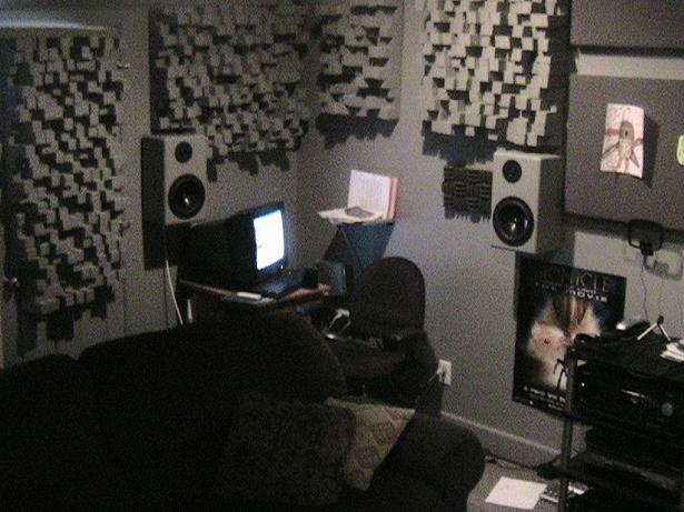

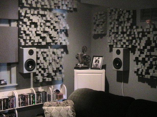

                                                          7.1 Done !
                                                          Here are two shots.One is the back and side left, and back and side right.
                                                          These speakers have a rather wide pattern and really fill in a back mono fill to the rear center well.
                                                          I'll probably wait for a rainy day or snowy day to bury the wires.
