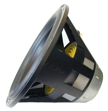

      I'd have a local cabinetmaker build some outrageous custom enclosures using the new really high-end drivers now offered by TC-Sounds..... :T
      If you prefer black then consider this....
      Click image for larger version  Name:	NS18-992-4A.jpg Views:	0 Size:	26.7 KB ID:	939382

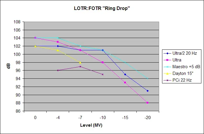

                                        How would you compare [TWO] PB/C12-Ultras vs. [ONE] PB12-Plus/2
                                        I would go with the dual Ultra's in a heartbeat myself, that's the last SVS option I ran before I moved on. Better yet, dual low tuned 15" driver options utilizing the RL-p or the TC-2000 15" drivers. Oh! when I ran the Ultra's, I ran them in the 16 Hz tune to improve SQ and extension. You would need to drop a dB or two off for the lower 16 Hz tune if it were represented in the graphs.
                                        The graphs are admittedly just a snippet, but they give you a little idea of a 25 and 40ish Hz scene with the Ultra/2 incorporated in. This is U/2 territory being the scenes are above 25 Hz. It's clearly undersized and under powered considering the beefy TV-12 imo.
                                        EDIT> The purple line represents a single Ultra not dual in my situation.
