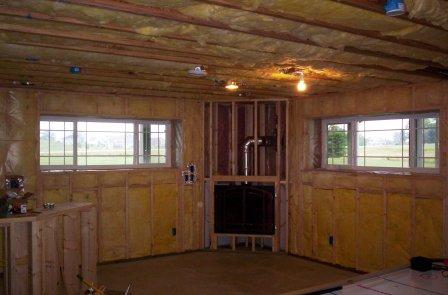

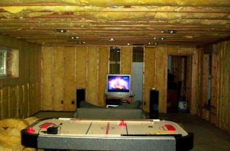

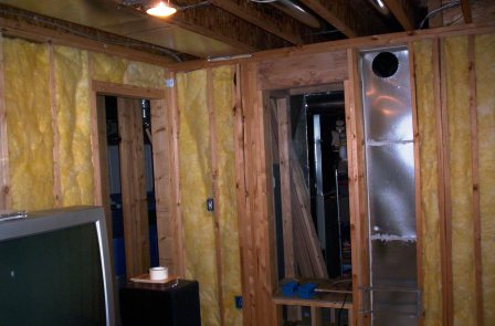

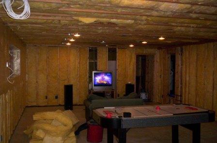

                      A few (bad) pictures of rec rm. (I'm also doing a workout room ,spare rm. and full bath.) A mock up of room...The air hockey table is being replaced with a pool table and the tv and stereo is my sons (I loaned him my old psb 800's) Love seat may get a slip cover for a while.
                      I ran 2" pvc from behind tv to equipment closet. (the hole in the wall.) I will be able to access it from furnace rm.
                      In the pictures the tv is away from the wall a few feet so I can get some work done behind it.
                      I was thinking of naming the project , Overbudget. 8O
