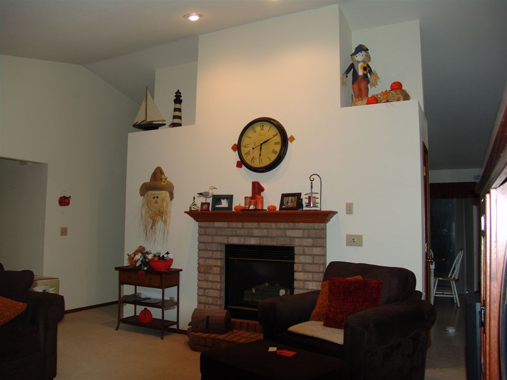

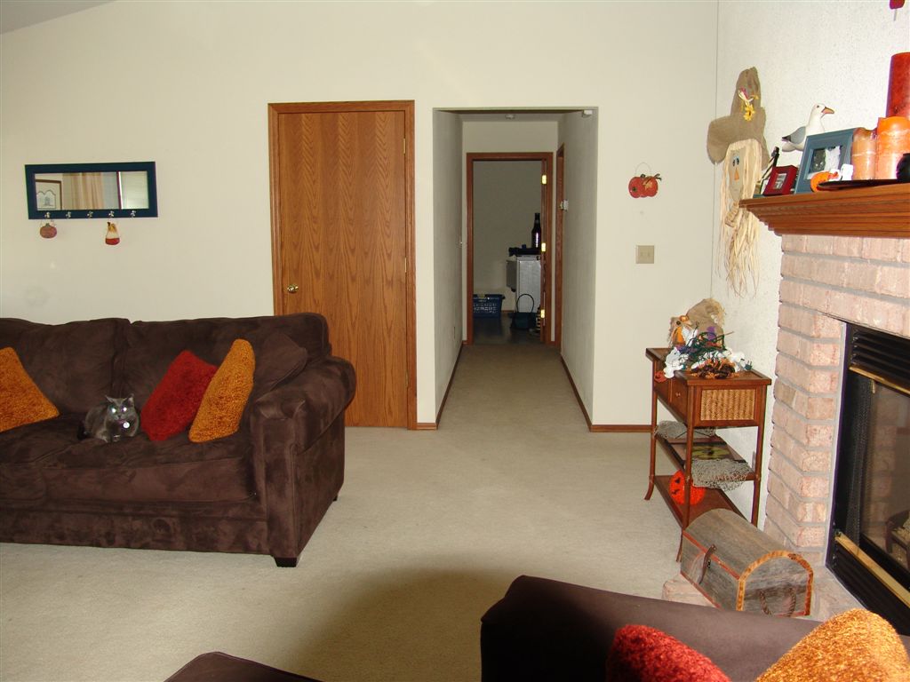

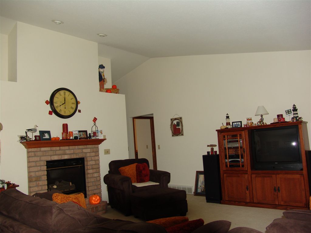

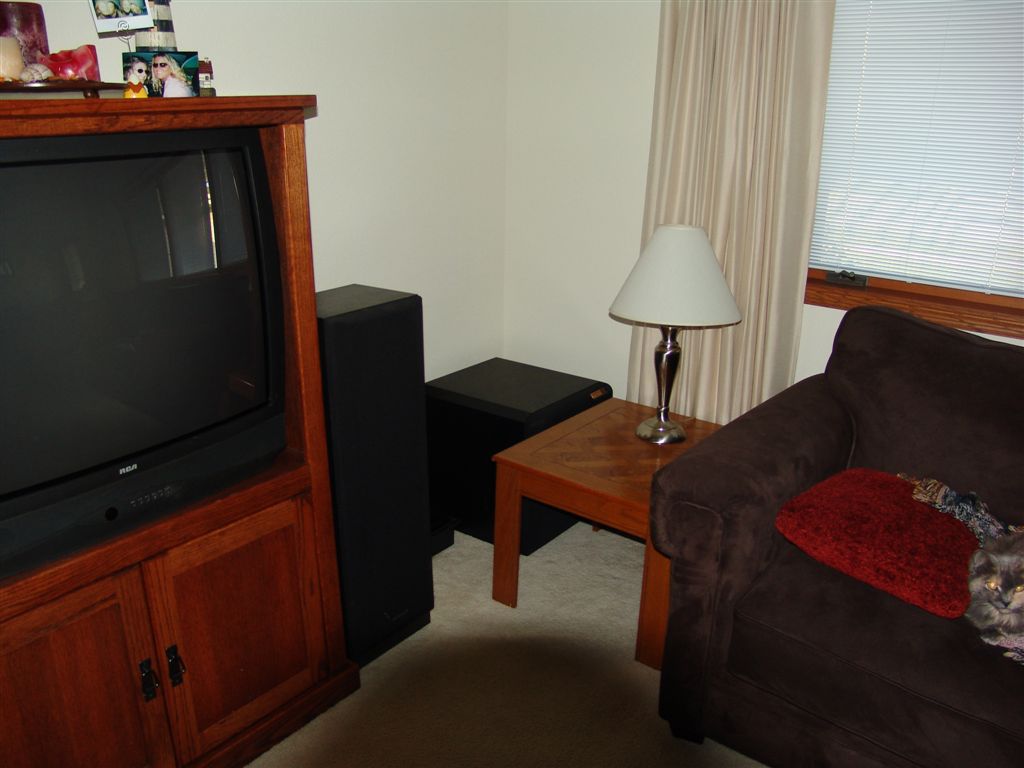

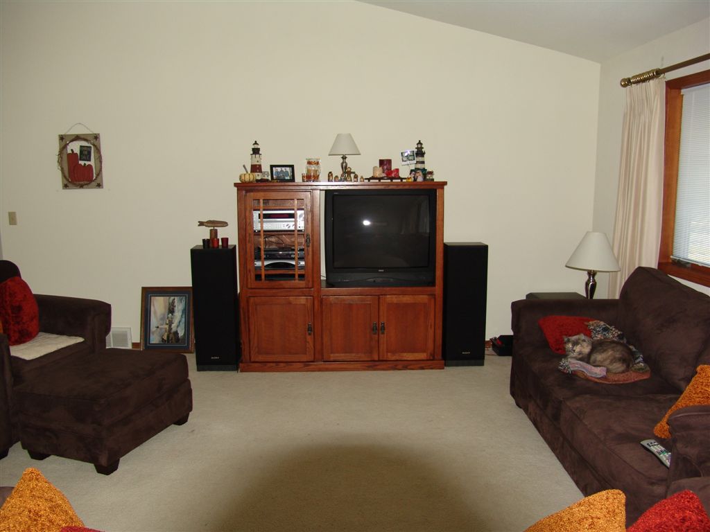

    I hope you guys can help me out with this. I just started to play around with my Kenwood SW-X1 (I guess it was Kenwoods high end) sub that I want to use in my Living Room until I finish the rest of my DIY stuff. I have tried a couple different placements on the right side of the entertainment center. Ive had it every way, facing the corner, the wall, facing out, even facing up. I switched side of the Ent center and that was no help. My living room is 16x18 with Cathedral ceilings, and mutiple hallways/doorways. The sub sounds ok from my listening postion but about midway down the hallway, its rediculous. Thats what I want where I sit. How do I do this? Thanks for the Help. Here are some pics so you can see what I talking about.

    The walk around the room method is the best for choosing sub placement. Just walk around the room with a sub cable attached and listen to the same sub passage. You'll hear where it sounds best. I'm thinking where you have it in picture #2 will be the best. Corner placement usually adds alittle more oomph to the overall sound.

      Am I correct in understanding that you are satisfied with the sound from the Sub in your listenning possition (Sweet spot) but down the hallway in pic#3 (which seem to lead to another room) the LFE is not so desirable?
      If so, this sounds to me that there maybe a standing sound wave issue or echos thats bouncing around and down that hallway. Also if so, could you enlighten me as to why the hallway is important to you?

                        Well a little update. I put the sub on the couch and walked all over. The house was a constant dead spot, with the exception of the corners. I then started to move the sub around just trial and error. The door in picture 3, right next to the hallway is a coat closet. For the hell of it I threw it in there. If I have the sub pointed up and the door cracked about 6-8 inches it sounds wonderful. The only problem now is that the sub rattles the whole closet like crazy. Oh well... I tried. I guess thats the motivation that I need to get stated on my dedicated room in the basement.
