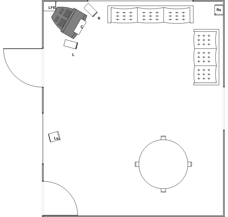

        I know but that is only in a perfect room with lots of space to work this out. But I guess in real world most of us will not be able to achieve these setups, with all due respect to your post.
        But definitely we can use the delay settings for Left and Right surround speakers to virtually create that distance on our back (most problamatic in achieving physically). tip : 1 ms delay = 1.1 ft virtual distance.
        I have atthd my room layout, as you can see I have a very difficult setup, with two doors and windows on the left wall and opening on the right center for access toother rooms. The TV corner wall has all the cables terminating there so I cant even think of changing its position.Its not a perfect room layout but I guess thats what i have.
        BTW, I am open to any suggestions from anyone to optimize my layout.

          I would agree placement is key but your room is a contradiction and a bad example albeit typical of alot rooms out there. Your rears aren't really in the rear and your mains are too close to each other with a TV in between and likely not pulled out in front of your TV.
          Looking at your room I would have put the TV on the wall near the Dining Room Table(assuming that's what it is). Then I would have dealt with either in ceiling or on wall rears and you'd be sitting back pretty far from your TV. Since you can't think of moving your TV, then you are pretty much screwed. Sorry to be a realist here.
          My wife wanted me badly to go with a corner setup and I fought it knowing how awful it is. I ended up winning that debate as well as her desire to have a "flat" cute tv. I wanted picture quality first and went CRT and saved about 2 grand over her cute TV idea. Ideally I would have went with FPTV. Moving your TV and gear rack away from your mains is the best thing.
          The main solution for you would be to rewire and redo where your TV is at.
          • Nick M
            • 5959
            I'd put the larger couch in the middle of the room and the tv, A/V rack, Front L&R and Center where the large couch was. Then put your surrounds to the sides of the couch on the walls.
