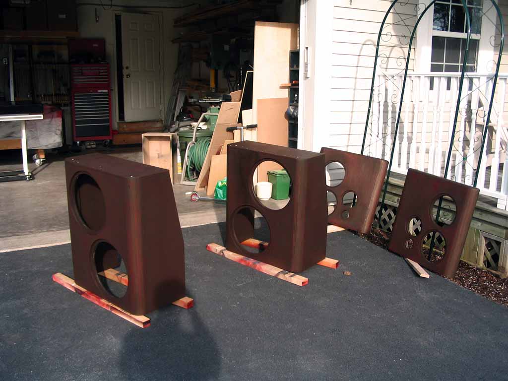

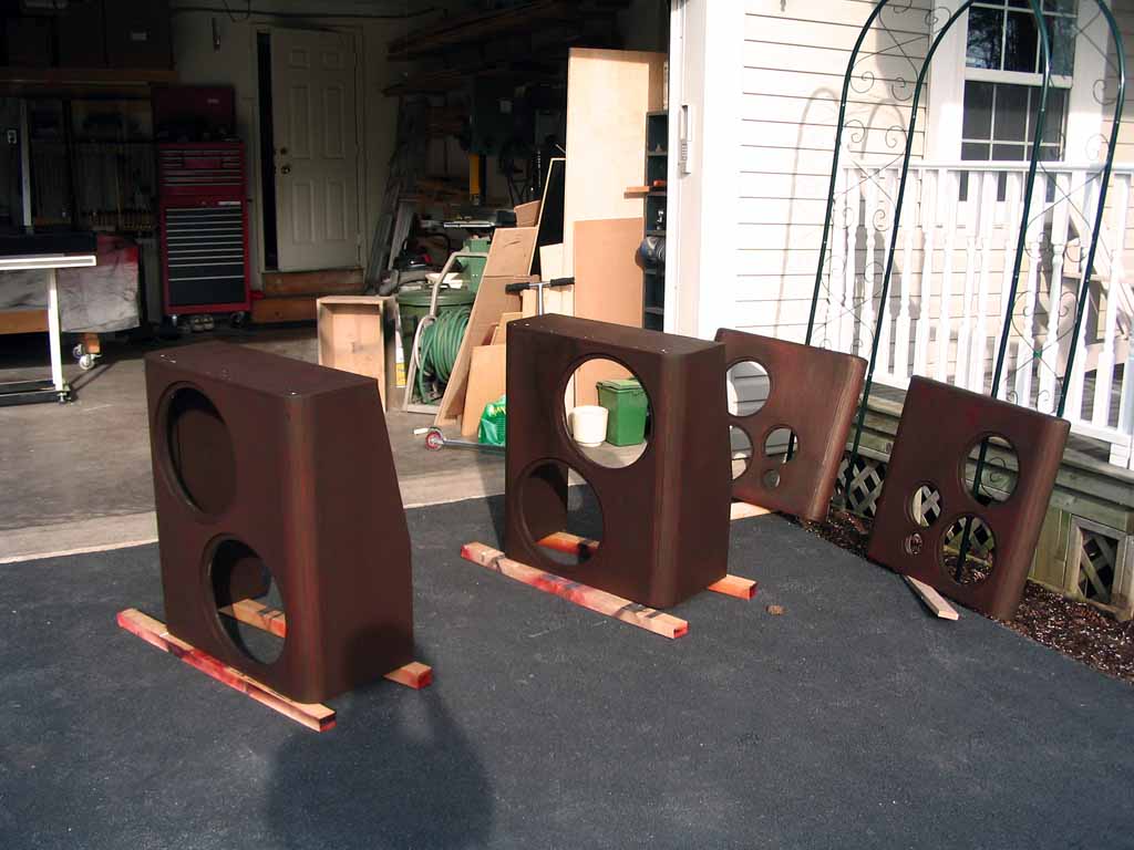

                Just yesterday I stained the panels for a new dipole speaker. The overall setup for each speaker will include two 15" drivers, two 10" drivers, one 6" and one tweeter - that will be a four-way, but with the separate sub for the very bottom octave will essentially be a five-way.
                Paul

                    Awesome. Are these going to be rear speakers or front speakers?
                    In spite of the two 15' drivers would you still need a sub?
                    • Paul H
                      • 904
                      Thanks, these will be fronts. Dipole bass is very inefficient - hence the four 15" drivers - but I should be able to use them full range for music with good extension close to the bottom octave.
                      I'll probably still use a sub for movies - not because I'll need to as much as to save the dipoles from the possibility of bottoming during very low frequencies.
                      Paul
