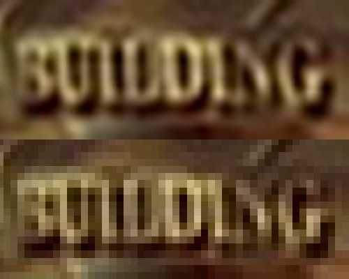

                A well designed upscaling player on the right display may be a good solution- I use one at 1080i on a CRT projector, and it produces a very film like image with a natural looking reproduction of detail. Done correctly, it can upsample the pixel samples into a more natural looking image. It doesn't add any detail not present in the original data, but may render that detail more pleasingly and naturally.
                This is a small section from one frame in the Fifth Element. The lower portion is representing pixel data points from the native picture (480p). The upper part of the picture is the same data resampled to 1080p. Bandwidth limiting of a CRT projector can so some of the horizontal interpolation, but only resamping and filtering vertically as well as horizontally can render the upper section. Some people prefer the upper section over the lower. The display must be capable of significantly higher resolution than 480P to do this, of course.
