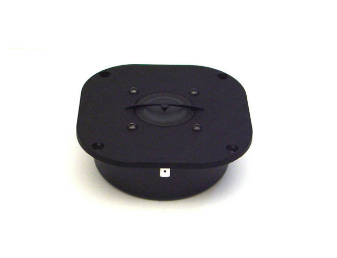

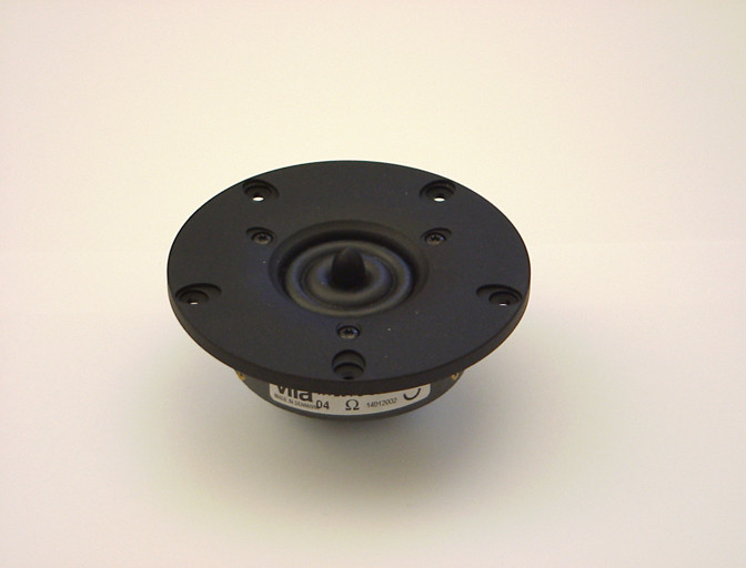

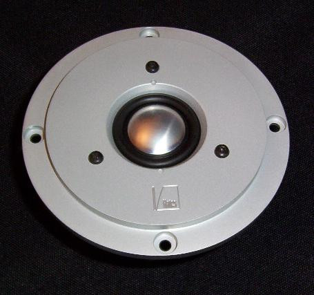

            The tweeters used in the M8 two way and it's derivatives (M8ta, M8TM, Arvo Part) are all 4 ohm models, becase this allows making some trade-offs for longer Xmax, (longer voice coil), and getting the "sensitivity" back not by using a humongous magnet structure, but by dropping the impedance a bit. As a result, whether I use a Vifa XT25, Hales Transcendence tweeter, or ScanSpeak D2904/SS9800, the crossover mods are minimal. It just takes a little care to be sure the tweeter/crossover load doesn't dip too load, because all of these tweeters have a DCR of about 3-3.5 ohms, so you don't want any crossover induced impedance dips added to that. With a teeny bit of care, I wind up with a near ruler flat 4 ohm Z from 1.25 kHz to 20 kHz.
            If you compare the magent motor assembly on a Focal TD120 vs any of these previously mentioned models, especially the Vifa XT25 (the price leader in this crowd), you can see that it's a different optimization. But the Focal won't go as low, either. Differet strokes for different folks...
