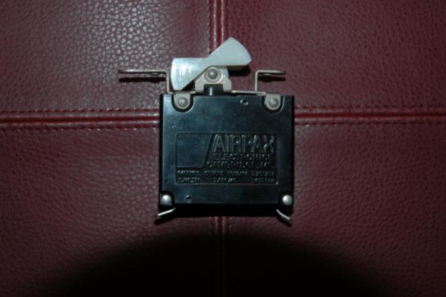

                            my sp300 finally needs a repair
                            its Lon,
                            Finally looks like I´ve tracked you down. How are you? I turned up the volume of my search out of necessity. Your bomb proof design for the sp300 has proved true for, gosh, over 20 years of use?, and now in the salt air of Brasil, it finally needs a small repair and I can´t find the part. its the Heinemann on-off switch, jc1-a8-cc-a. Can you tell me where I can order one. My folks are coming down in a couple of weeks, March 11 and if I get on it, I can get one to them before they get here.
                            Lon
                              • 16205
                              Hi Lon,
                              Brazil? Now, how on earth did you wind up down there?
                              You can't order that part off the shelf anywhere- it's a custom circuit breaker, that I specc'd out. We have an amp in Denver that had an "issue" a few years back, and ThomasW can get the breaker out and send it to your parents if you can provide an address. We have a couple more in working shape, but they're not used much...
                              These days I'm mostly using Aragon's or Ayres, or modded Aragons.
                              Hope you're doing well, you can see some of what I do here on this site, but my day job keeps me so busy I don't have nearly the time for this I'd like.
                                Hi Lon,
                                Needing something that looks like this?
                                Send me your parents addy and I'll mail it out ASAP. If you need/want more parts let me know.
                                Regard
                                Thomas
                                • lonbove
                                  • Feb 2007
                                  That´s it
                                  Hi Tom,
                                  Is your last name by any chance Wally? And yes, that the part-- This is wonderful news!! I´´m waiting for my folks to send me their new address and then I´ll email it to you! Any other functioning boards, output transisters, smaller stuff, stuff you think I can´t get anymore, maybe even the volume pots would be great
                                  thanks
                                  Lon

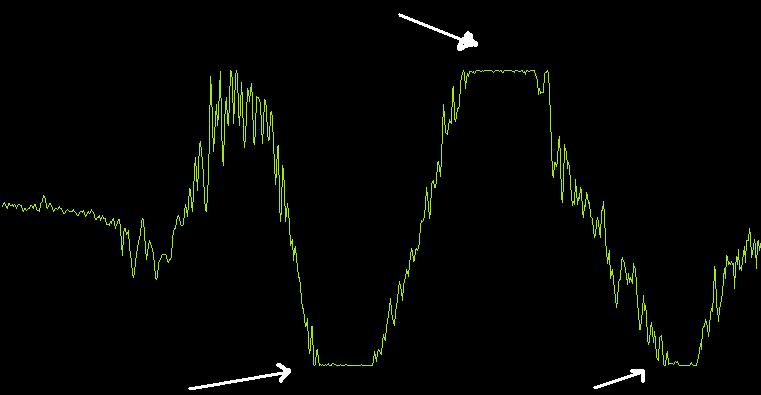

                                      • DL86
                                        • 271
                                        Looking at some recent recordings on CD, I had a look of the actual waveform of some CD's on my PC and have found there to be a heap of clipping especially on louder transients. This is clearly audible on my sound system. Playing other CD's that arent recorded with clipped signals sounds a lot better and I can play it louder with less fatigue. Example red hot chilli pepper's stadium arcadium is just rediculous, what were they thinking when making this CD?

                                          • whoaru99
                                            • 639
                                            Probably thinking this won't matter on a radio - likely where many people will hear it first and decide to buy the CD. Then, it's too late for the purchaser...
