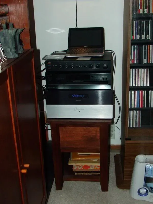

    It was most fortunate that the amp was installed in a system I am V familiar with. Dan’s (PewterTA) system consists of a Rotel RSP-1098 pre, modified Rotel RB-1090 amp, & B&W 802 Diamond’s. As reference point, the modifications Dan performed on both his & my RB-1090 amp produce improved musicality & tightening of the bass; more air, focus & depth in the mid, & reduction of what little harshness exists in the HF while improving its texture & timbre. There is an overall increase in the speed & sense of ‘life’ across the board. Also, the 1090 is basically a duel-mono design rated at nearly 400 watts per channel.

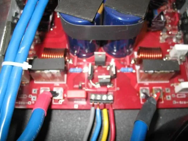

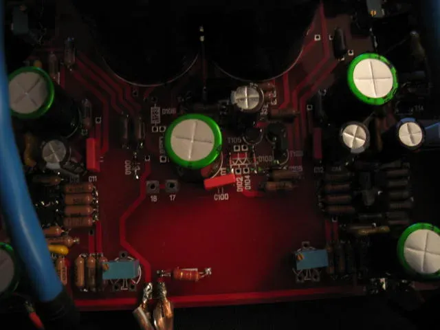

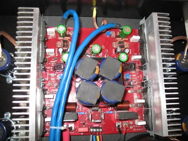

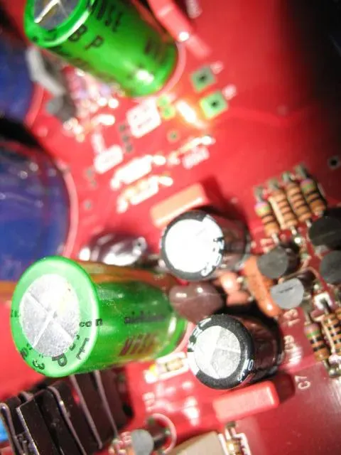

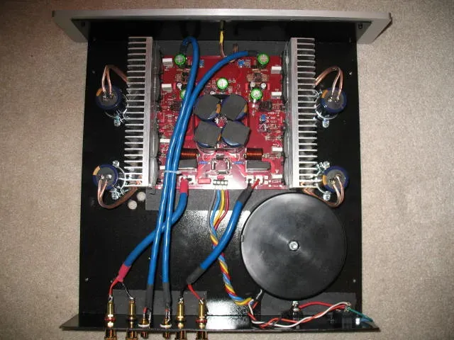

                        Well, I finally got a chance to open up my other Odyssey Khartoga Plus amp to take some pics. Below are some comparisons between the Khartoga Plus vs. the Extreme version.
                        The Khartoga Plus first.

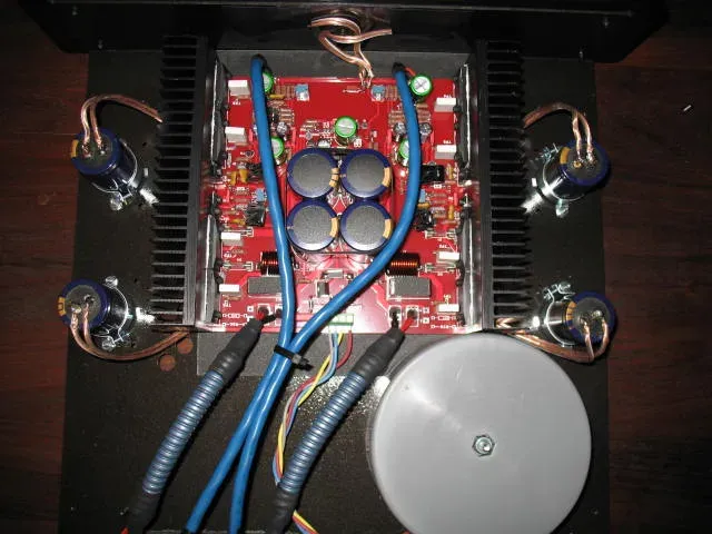

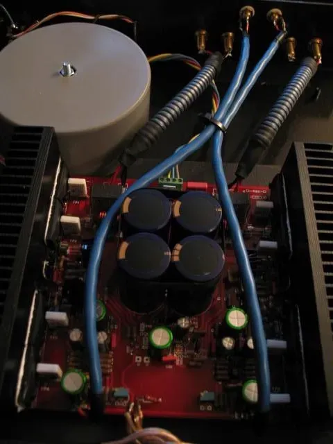

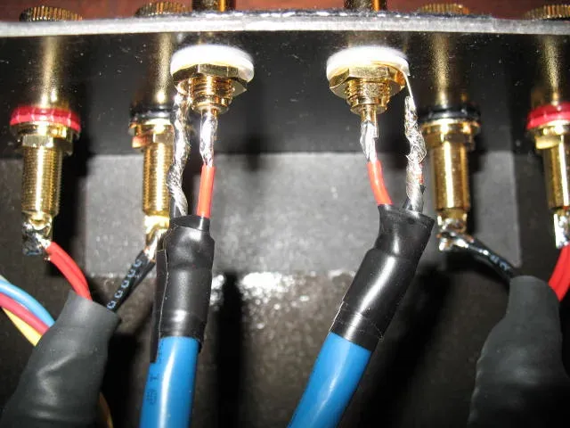

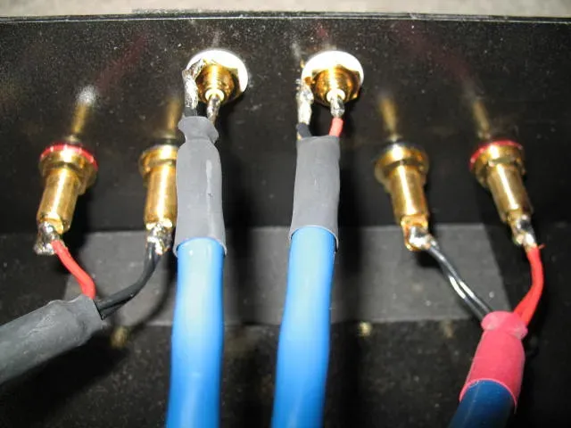

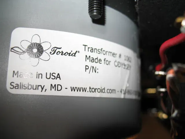

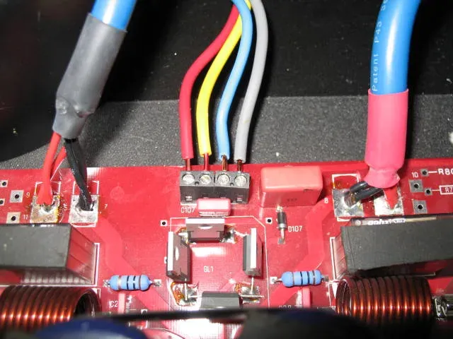

                        Next up is the Extreme version
                        To be honest I do not see too much difference between the two. The Extreme has a different power supply (larger in power), the internal output wires are shielded with a metal conduit, and there is more dampening material on the metal enclosure. While I did not have them open side by side, they appeared to have the same Dale/Vishay resistors and Wima caps in the same locations. I could be missing something with that one. Plus it seems they both use the same internal hook up wire.
                        I have not directly A/B them with the same speakers/media. That will happen in December with some other friends here. I hope I hear an audible difference between the two. They both sound fantastic though.

                              The difference from stock to plus is just the added capacitance. The difference between the Plus and Extreme is better components, wiring, power supply, and rear connectors. Or so I understood.
                                Rear Connectors look the same....
                                Component upgrades, not exactly sure what that is... they all look very similar... wiring is changed on some of it... PS looks different though.
                                I agree, it's a little more similar than I would've thought.

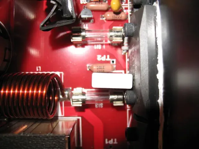

                                          Hey Michael, If you're up for it, If you find out what types of fuses are in both the Odyssey and the Adcom, let me know and I can give you a hand full of better glass fuses (maybe, I can't tell what's in there), but I can give you ceramic fuses as well as long as I have them... you might really like the results of mixing and matching, that's what's helped my system as well to either smooth or enhance the clarity.

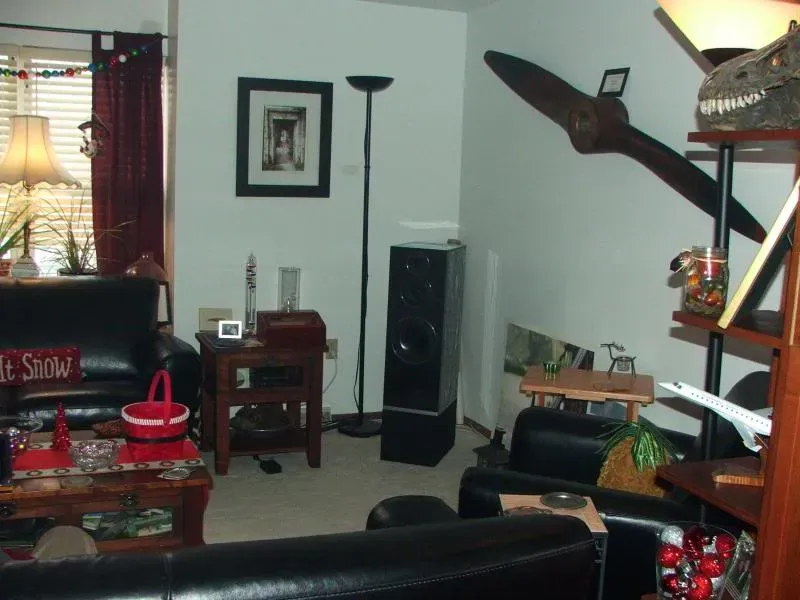

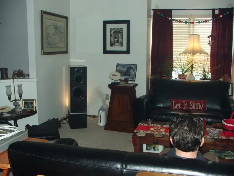

                                              Some pics from the wonderful get-together hosted by Michael & his lovely wife yesterday.
                                              Thank you, Michael & Susan, it was absolutely Fabulous!

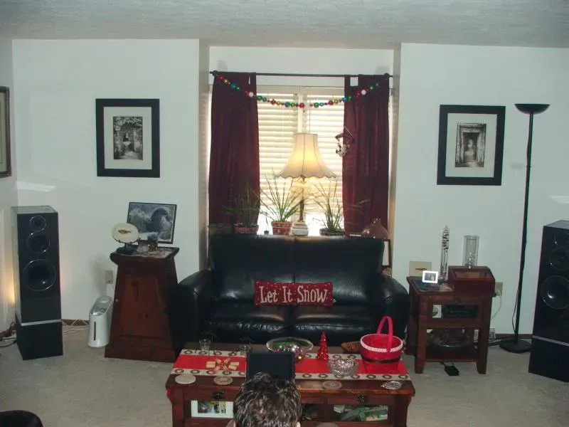

                                              the Finalists find their final resting place.......finally....
                                              Dan performs admirably during the positioning phase early in the event as we fine-tune the room response.

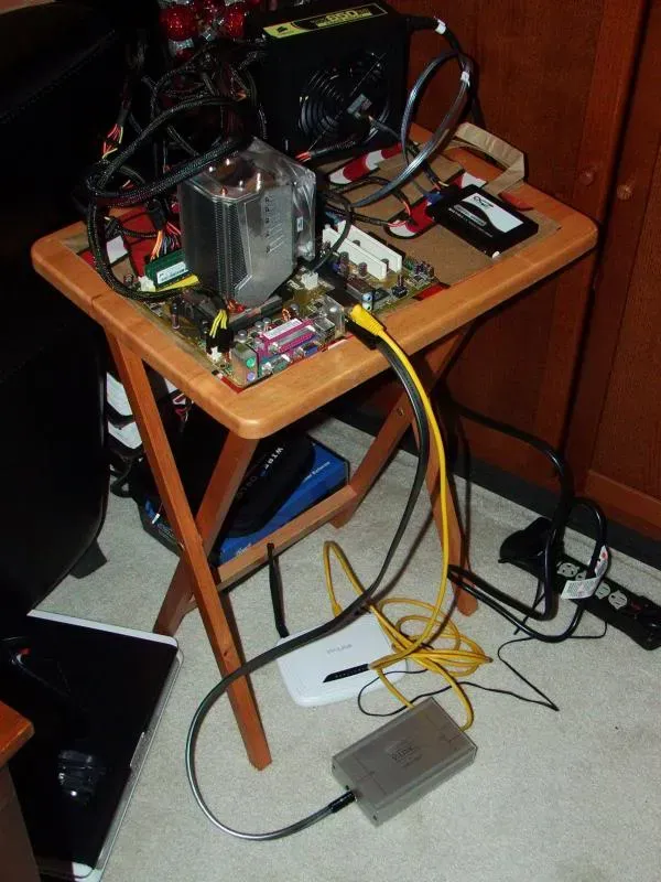

                                              Dan's 'Music Server In-a-Box' utilizing Windows Sever & the 'hot-spot' he created giving us immediate & total access to his 4TB music library.
                                                Cool! I don't see the 'Box' part though ... looks like circuits and parts on a table. But that is cool Dan can do that!!! :T Can't say I know much about that stuff.

                                                      The server in a box, was in a box when I brought it there... I however hadn't had time to cut out the holes in the box to use it, which now I'm glad I didn't do, as I replaced the 650w power supply with a very small and silent PicoPSU-150-XT, 102W Power Kit which was recommended by a few people for how good it's power is on the audio side of things (very low noise).
                                                      So far I have to say I really think this power supply has changed the sound for the better. The music has more of a "musical" sound, little more towards an analog sound, but with the same precision and clarity the server had. Which I don't know how to describe it really any better then to show people by A/Bing the two.
                                                      I'm definitely now a fan of the lower power supplies performing better for audio...
                                                      The A/B was great. It just goes to show how "good" or "trusting" wkhanna's ears are... Even though he can't hear everything....he's definitely learned how to ear differences as the two amps were not extremely far apart... But I agree completely with his assessments, as it was the same feelings I had.
                                                      Oh yeah, and I almost had a full infrastructure in a box, I brought my own wireless network! lol
                                                        Thanks for explaining the box. Yeah, I've found the same ... a lower noise supply can make a real difference in sound quality.
