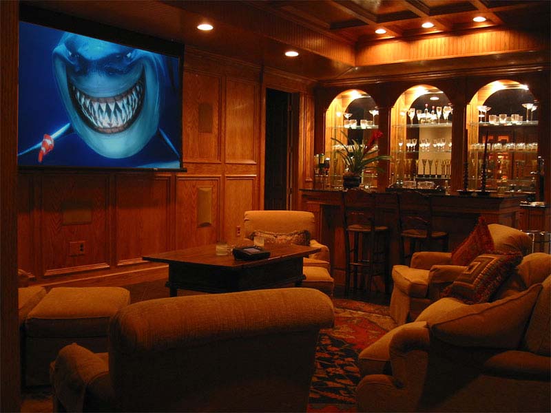

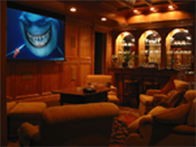

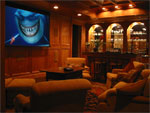

                The "2,304 kbps" your receiver reports is after the bitstream is decompressed back into a raw PCM bitstream. What actually comes off the satellite is 32-48 kbps. The satellite box decodes (and decompresses) this before passing it along. But of course, the damage has been done, and that 2,304 kbps signal sounds like garbage.
                It's kind of like downsizing a JPEG from 2048x1536 to 320x240, and then upsizing back to 2048x1536. The end result will look nothing like the original.

                  Just because I'm bored. Here's Kevin's example:
                  1: Is the original CD
                  2: is the CD in the XM stream
                  3: Is the CD back to CD 'quality' after the tuner, DAC, etc..
                  • Ovation
                    • 2204
                    Very effective visual aid.
                    • Jeff
                      • 281
                      Thanks Kevin. A picture is worth a thousand words.
                      I assume this is your HT set up.
                      • Kevin D
                        • 4601
                        hehe... Not quite.. That's a customer's house. I think the wood in that room costs more then my system..
                        Kevin D.
