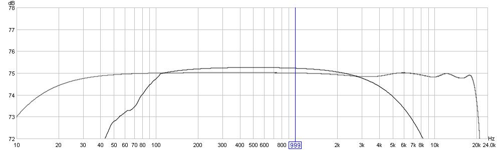

                      Following the REQ Wizard instructions, it suggests testing the soundcard calibration by running an EQ sweep on the left channel while the soundcard is still looped to itself. Here's what I got--it's not exactly what the help file says it should look like, but it's purely flat except the extremes. My concern here is that there's a steady downward curve all through the bass frequencies, which is entirely where I'm trying to EQ. The REQ help file indicates that it should be flat all through there, and then actually taper off downward.
Name:	soundcard calibration check with left channel.jpg

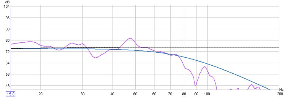

                      Alright, DEEP BREATH! Let's try the first sweep. Drum roll, and...

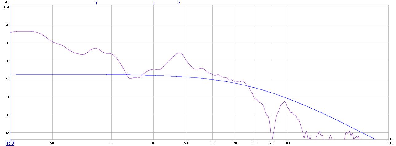

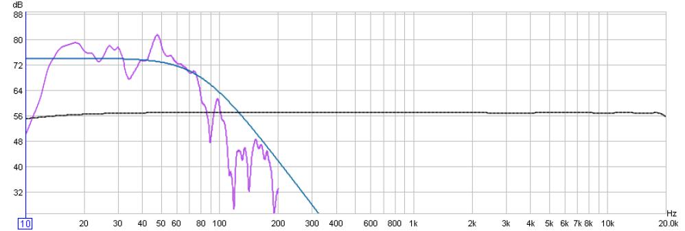

                      Just to try for precision, I ran another auto calibration at 1Hz increments from 10Hz to 200Hz. And we get...
                      Holy crap, does my bass response really look like that? No, that can't be right. (can it?) That is SCARY. So if I try to rescale the same graph to something more standard (15 to 200 Hz, 45 to 105 db, logarithmic scale) we get a much different appearance. My crossover is set at 80Hz in my Parasound C1 pre/pro, BTW.
                      Looks like I have some work to do. Comments from people? Is this even salvageable? I'll start trying filters here shortly.

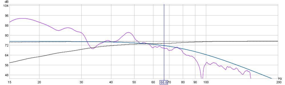

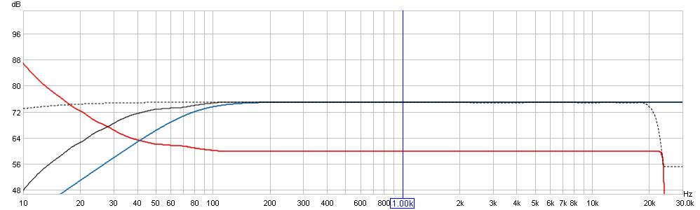

                        And now the fun part begins, which I did tonight. I took the 1Hz auto measurement sweep I did last night, and then had REQ identify peaks (it picked three) and then assign filters. It assigned 3 filters, one for each peak. As I had two distinct dips, (especially after applying the first 3 filters) I chose to also add two manual filters that are BOOSTS. Yes, I understand that you want to be careful with boosts and not add them if you don't have to, but in this case, I don't know what else I could do. (see above for my big dip at 34 Hz) So these are the filters the REQ added:
                        # Freq Gain BW Oct
                        1 47.98 -7.5 0.143
                        2 26.98 -3.0 0.143
                        3 29.92 -3.5 0.143
                        and here's the manual boosts I added:
                        4 33.96 7.5 0.250
                        5 23.77 2.5 0.125
                        Look at the numbers at the top of this graph to see where the filters were added and the response that REQ ***PREDICTED*** the filters would give. (note that Special is greyed out because I had played around with another filter to see possible affects but didn't like it so I unchecked it so it was not implemented. I don't know how to DELETE filter #6)

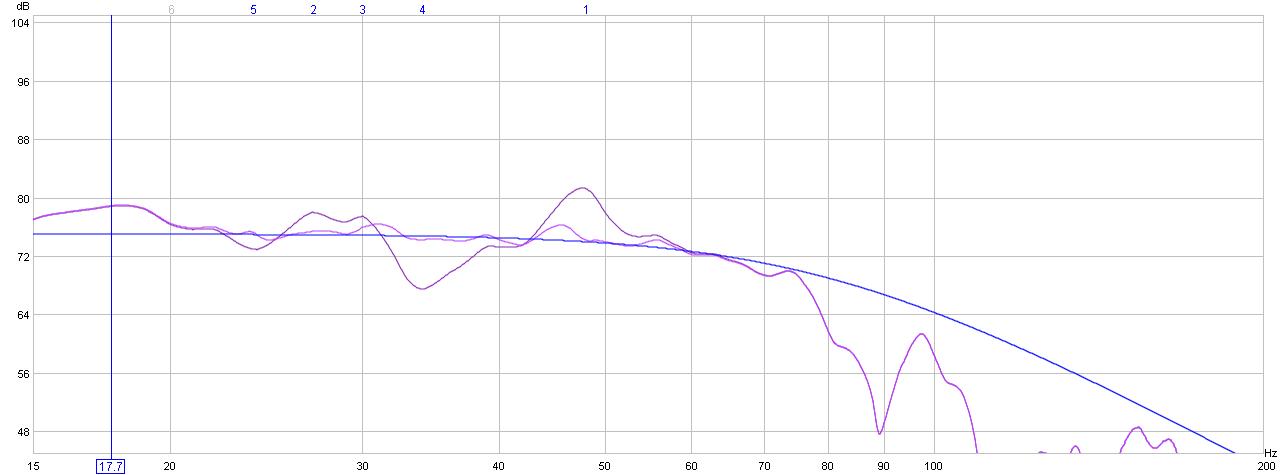

                        So I try the upload for the first time... works like a champ. I'm liking my M-audio USB-MIDI cable MUCH more than the Voyetra model I previously tried and returned. I assume that when you have two subwoofers like me and are tuning both simultaneously, that you upload whatever filters you add to BOTH the left and right channels of the BFD. (if anybody knows of a better way to do two subs, I'm all ears) The filters go right into the BFD with no hassle, and I'm done with the first iteration.
                        To be safe, I start over at this point and recheck the "set measurement" and "set input volume" levels. Maybe it's just me, but it seems now that my SPL meter readings are more stable, still jumping around by a couple db's with every reading, but less pronounced.

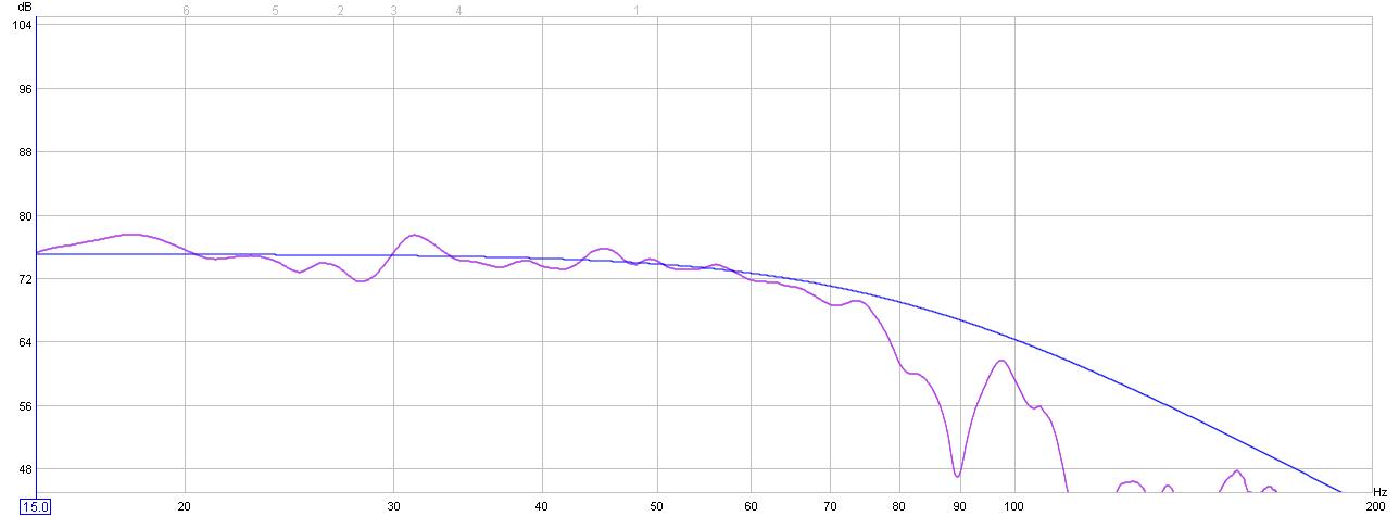

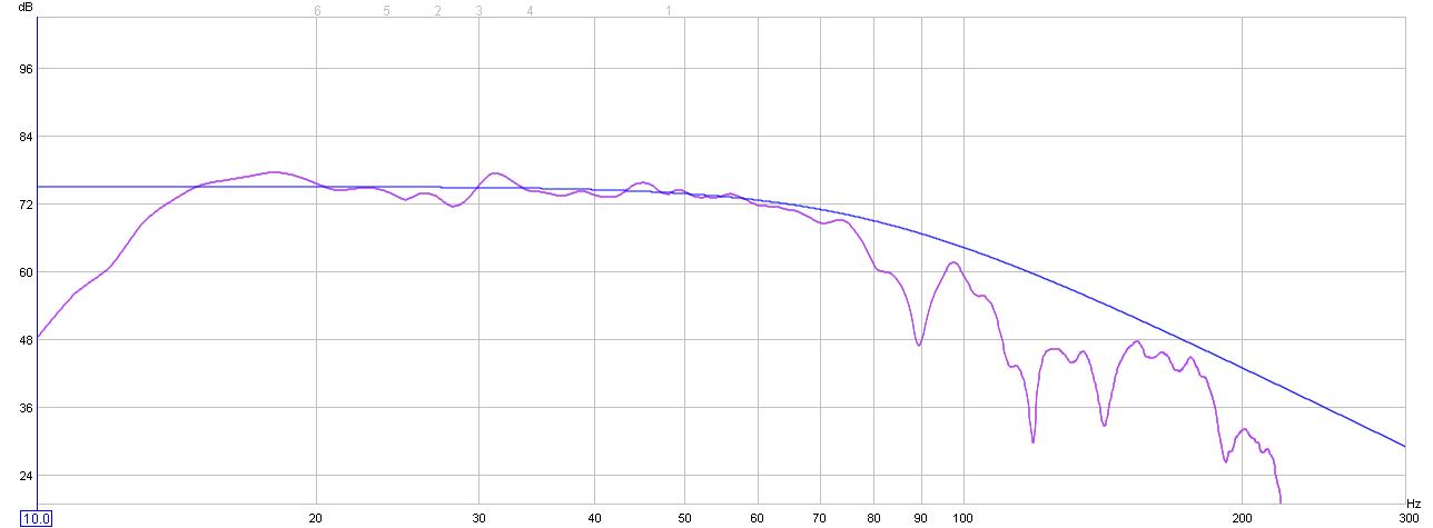

                        I do another 1Hz frequency sweep now to see what the filters REALLY did to the subs, and here's what I get, again as a raw graph of 10 Hz to 220 Hz.
Name:	sub sweep 4 after first filter upload raw.jpg
                        Well, it looks better, but man, that upper end is still ugly as the sub rolls off around the crossover range. Again, here's the exact same graph, rescaled and logarithmic as is standard...
Name:	sub sweep 4 after first filter upload scaled.jpg
                        Note that this is actually pretty close to what REQ predicted my filters would do. So, guys that have EQ'd their subs, would you do these filters different? Or at this point, what would you do? Accept the new graph as made, or add more filters for better? Can anything be done with my crappy response from 70 Hz on up? (or should I even worry about it?)

                          Chris,
                          Your measured un-equalized response looks typical for the few rooms I've measured and ones I've seen posted on the net.
                          I'm assuming that the blue line is the 'perfect' frequency response for your crossover. I EQ'ed mine by running the sub without a crossover and aiming for flat response.
                          It looks like you have everything in good shape, except for that 'hole' just under 90 Hz. You may be able to reduce that by minor movement of your subs, and you probably should try to deal with that as it will will impact your overall frequency response. I'd be trying to EQ the response up to twice your sub crossover frequency (ie 160Hz if your sub xover is 80Hz).
                          Paul

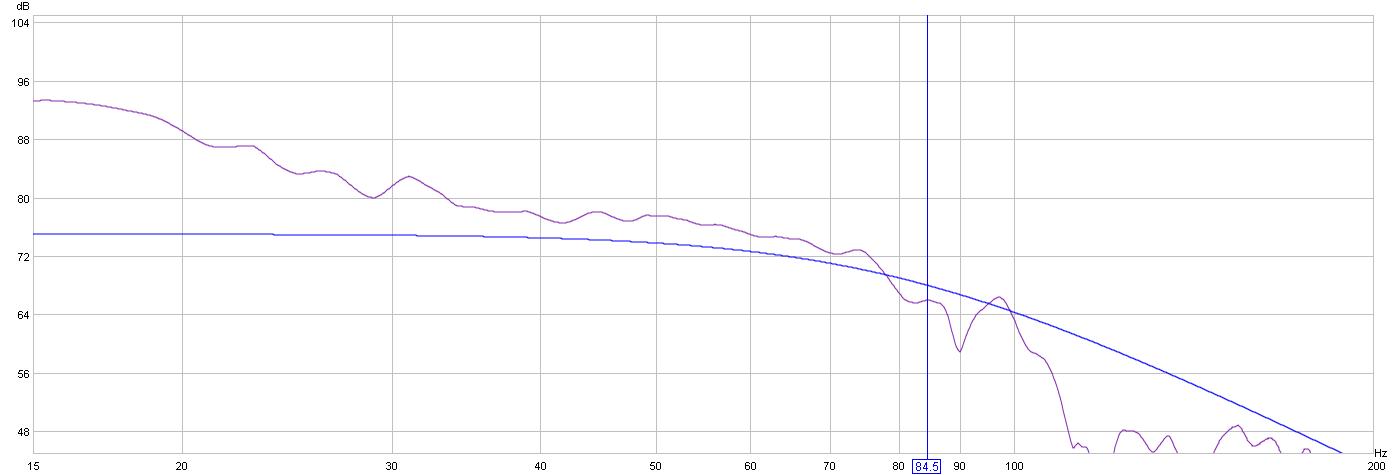

                            Most people find a flat plot (straight line) a bit dull. So they create their house curve. Mine has a rising response as the frequencies go down. Now I can get away with that because my IB has so much headroom.
                            With your ported subs you do not want to boost below the tuning frequency of the port. Doing so will cause the drivers to 'unload' and that's a very bad thing......
                              Ah, good stuff.
                              The blue line is what automatically came up in the Room EQ Wizard for a desired response, without me loading a house curve. I assumed it looked like that not because of a house curve per se, but because of a very gentle roll-off to a crossover frequency.
                              Thomas, can you help me understand more what you're talking about with boosting? For those who didn't read above, my subs are TWO SVS cylinder PC-Ultras.

                                                                    Here's a start... it took me a while since I had to move my desktop out to the living room. I also had a few issues setting the input volume - REQW wouldn't move it on its own and gave me an error (to low level), it took me a while to figure that out.
                                                                    Anyway, the rest went smoothly although I didn't have as much time to fine tune as I wanted.
                                                                    Here are 3 captures: unfiltered, the proposed filters, and the final (for today) result. I didn't worry to much about the absolute level, I made a change midway and didn't reset the target level. Just focused on flattening out the curve.
                                                                    After I got the sub lined out - I re-measured with the mains. All looked good except for a deep, narrow null at 80Hz (XO freq, coincidence?). I dialed in another small boost and packed up. I didn't save that graph as I was sick of messing around (haven't eaten, wife is sick, etc)
                                                                    The wide BW cut around 20Hz didn't do as much as I thought it would. Oh well, save it for another day.
                                                                    Last edited by theSven; 07 May 2023, 07:25 Sunday. Reason: Remove broken image links

                                                                            Well, after posting my last graph, I went back to add some additional filters last night for the purpose of trying to boost out the huge dips I've got above 70 Hz. I fired up my laptop, turned on my equipment, let everything warm up, and then again set my measurement and volume levels. Nothing had really changed, all levels were the same. I then decided to do another frequency sweep before I added the filters, and the graph looked funny, like all readings were at a bit higher level. I rechecked all connections and settings, and yes, everything was the same. I hadn't even moved the SPL meter on the microphone stand, they had stayed in the same spot over these days. Set the target level again, same thing. I decided to start over, deleted all filters from the BFD, and did a fresh sweep with no filters. Here's what I got:
Name:	new set 1 no filters higher level.jpg
                                                                            Note how high the response goes above the target level of 74-75 db at 15-30 Hz and then again at 48 Hz.
                                                                            So I tried a totally different set of filters this time, including a MASSIVE and wide cut right at 20 Hz (the REQW won't allow you to set a filter any lower then 20 Hz) and three different boosts from 88 to 122 Hz to raise some of those ugly dips I have in the upper range. Here's the result:
Name:	sub sweep 5 after 2nd filter upload scaled odd volume response.jpg
                                                                            I'm not sure why the readings are still higher than before, but they do seem accurate. For now, I took the EQ as acceptable, and stopped this round of EQ adjustment.
                                                                            Turned on the rest of the theater, sat down, and started playing some material. Sounded about the same or even better, but I wasn't playing any bass-intensive stuff.
                                                                            I decided to recheck my pre/pro speaker distance and level calibrations now that I had EQ'd the sub, so I re-ran the auto calibration programs of my Parasound C1 pre/pro, using the Parasound calibration microphone in the microphone stand. Wow, an interesting result. Previously, I had the subwoofer set at -6 db in the pre/pro to equal the mains and other speakers. With the new calibration, all speaker level and distances remained exactly the same (as pretty much expected) except the sub level now came up all the way to -2.5 db! I'd have to attribute this to the big cut I made at 20Hz as well as cutting down the big peak I had at 48 Hz.
                                                                            So now I started doing some critical listening on material. I wanted to watch something bass-intensive that I hadn't seen for a while so I'd also enjoy a movie, and put in LOTR: Fellowship of the Rings. Played the DTS-ES soundtrack, and WOW. The LOTR trilogy has always been impressive for bass, or even maybe overly hot, but now I was hearing more details in the LFE. Sounds became apparent that I think were overpowered by the peaks before. Much more clean sound, and full of power. My SVS subs can really shake your body and literally blow the hairs on your skin in intense scenes.
                                                                            Cool. I'm pretty happy. If I could figure out how to do it better, though, I'd be willing to do it again.
                                                                              I had the exact same hump in my response and tried the same sort of filter. It's kind of fun experimenting with the filters, some of the sharp dips are hard to get rid of without comprimising something else.
