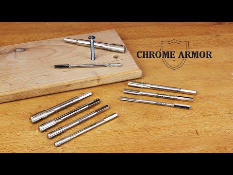

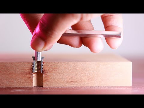

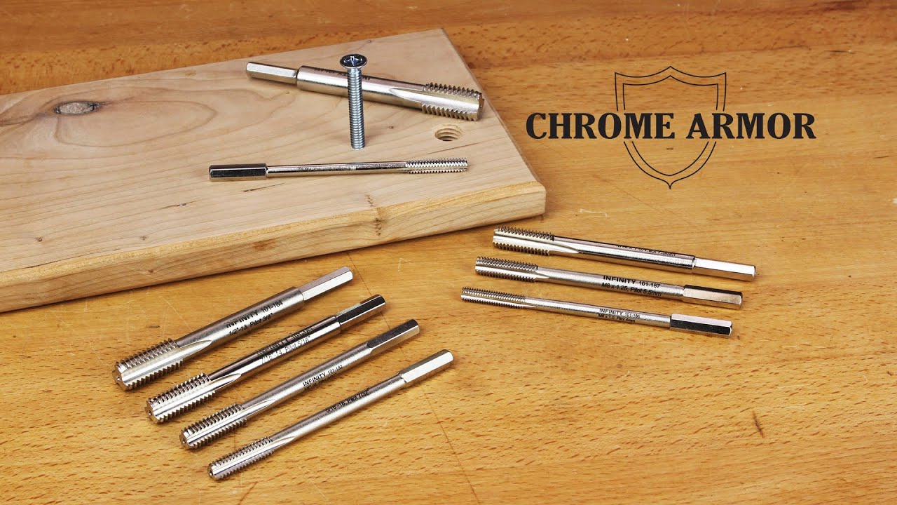

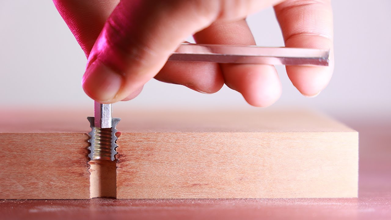

    With recent discussions about threaded inserts, I figured I pass along some information to ponder. I'm sure this is not unknown to many of you, though some may find it interesting. The idea is using threaded inserts might not be the best option?
    I've attached a couple of videos that will cover the basics of what I'm getting at.
    Of course as with all things, there's no silver bullet to fix all problems. This alternative technique will not really work very well for small thread sizes, but it gives another option to use.
    Last edited by theSven; 17 October 2024, 16:17 Thursday. Reason: Put links in video tags
